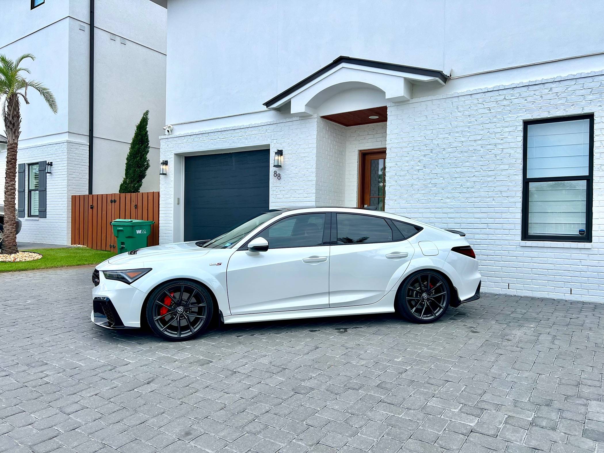

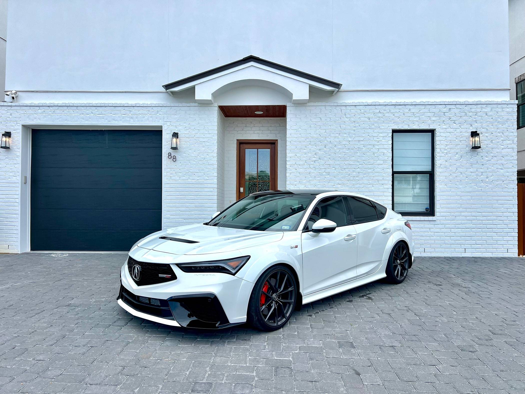

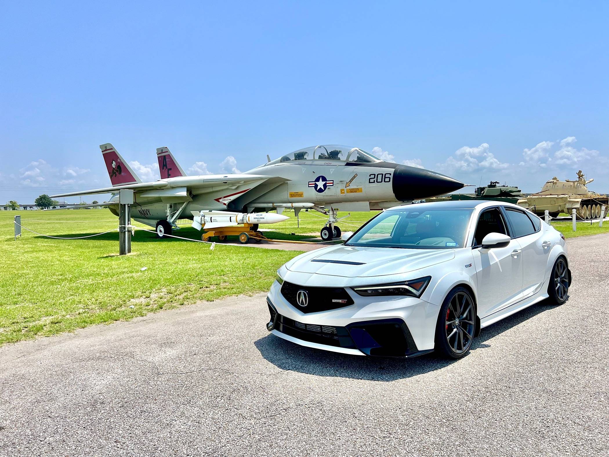

Just got back from a 1700 ish mile trip to Florida starting from Austin,Tx. I could talk for hours about the details but I’ll just share some pics of the journey. Love this car and hitting Houston tx after 7pm last night was exciting. Got into some kinda pull with a yellow corvette with a headlight that was shacking like no othe, exciting! . anyways those roads are fun when the traffic is lite. Mpg 21-24 range depending on traffic

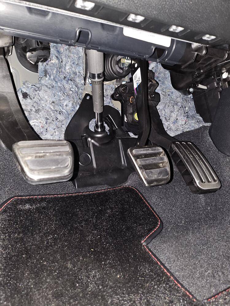

I was inspired by this article on The Drive (https://www.thedrive.com/guides-and...-civic-type-r-throttle-pedal-is-a-must-do-mod) so I ended up buying and installing a Perrin throttle spacer. It took me two days and three different tools. It was a super duper pain in the ass cutting down the required bolt. I first used a manual hacksaw but it was torturous trying to cut in a small space so then I tried using a dremel but it produced too many sparks for my comfort. Ended up buying an Oscillating multitool saw and a carbide blade to cut off the bolt.
If I was to do it over again, this is one install I would definitely pay my mechanic to do.
The end result is pretty awesome. I used the second position (right most position) and heel-toeing position is now fantastic and very satisfying (especially when the Integ lets out a loud pop sound when I downshift). This is how it should have come from the factory.

Acuity also has a spacer, and it does not require bolt trimming (I am not sure how the pedal positions compare).

Yea from the Drive article, it sounded like the Acuity version raised the pedal up a little bit too much which is why I went with the Perrin version.
