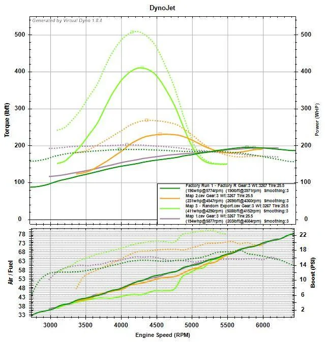

I'm on the Phearable tune, and I'm getting clutch slippage on even the medium-boost map. You can see from the RPM vs MPH graph that there's a bit of slippage on Map 2, and a ton of slippage on Map 3. Seems like 19psi is the upper limit for how my clutch can handle. Now to figure out if I should do the RV6-FK8 clutch upgrade, or hold out for the Type S...
