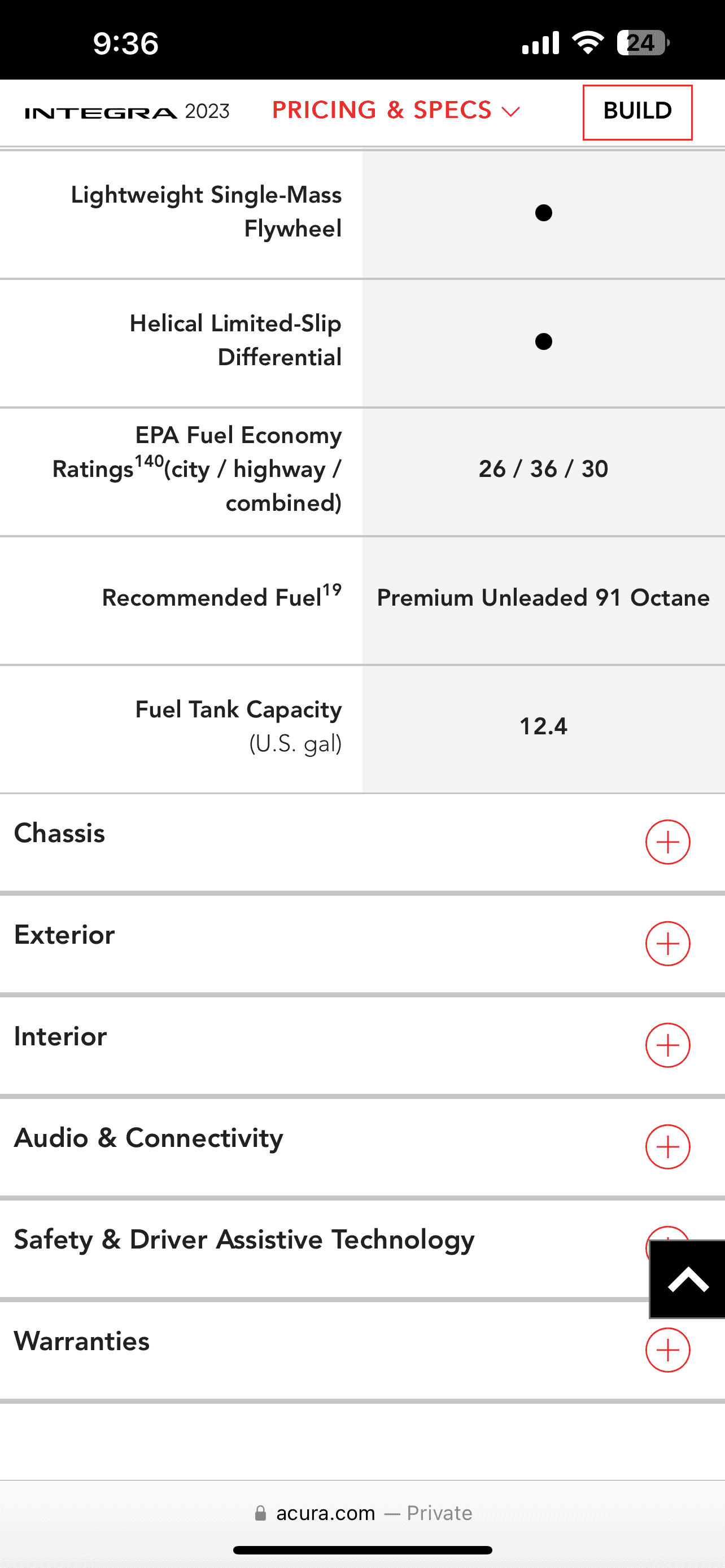

I would like confirmation on this as I swear I read somewhere that the gen 11 civics and the integra were single mass. The gen 10 civics were dual mass.
Yeah I thought it was also single mass to reduce rev hang.. less mass rotating.

Yeah I was wrong and it definitely seems that the latest Gen integra has a single mass flywheel. Thanks for finding that info and correcting me. However, there still will be additional drivetrain shock transmitted with the clutch damper delete. It feels disingenuous for pro import tuners to give no warning of this at all and act like it’s actually benefiting the reliability of your car.
