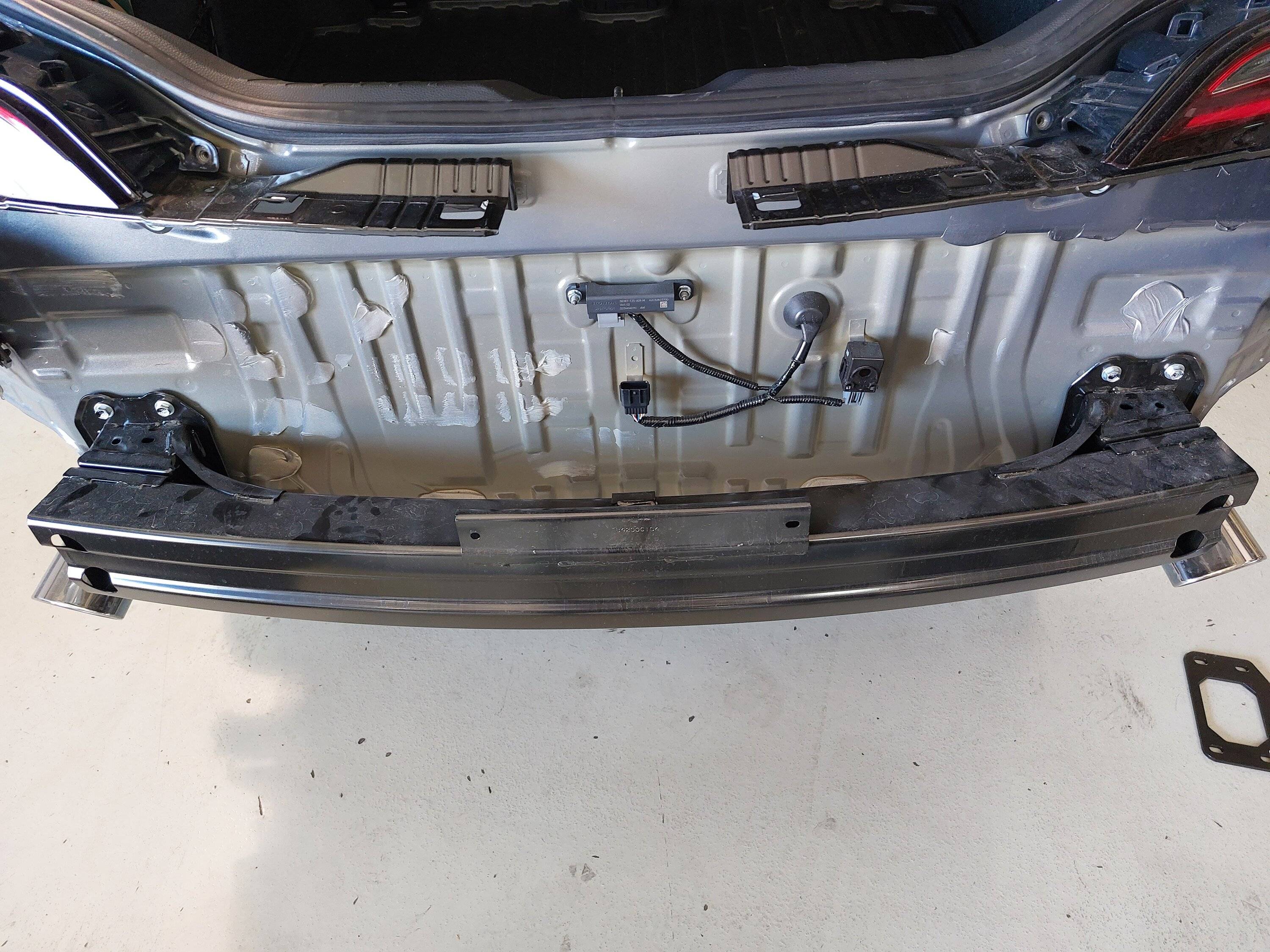

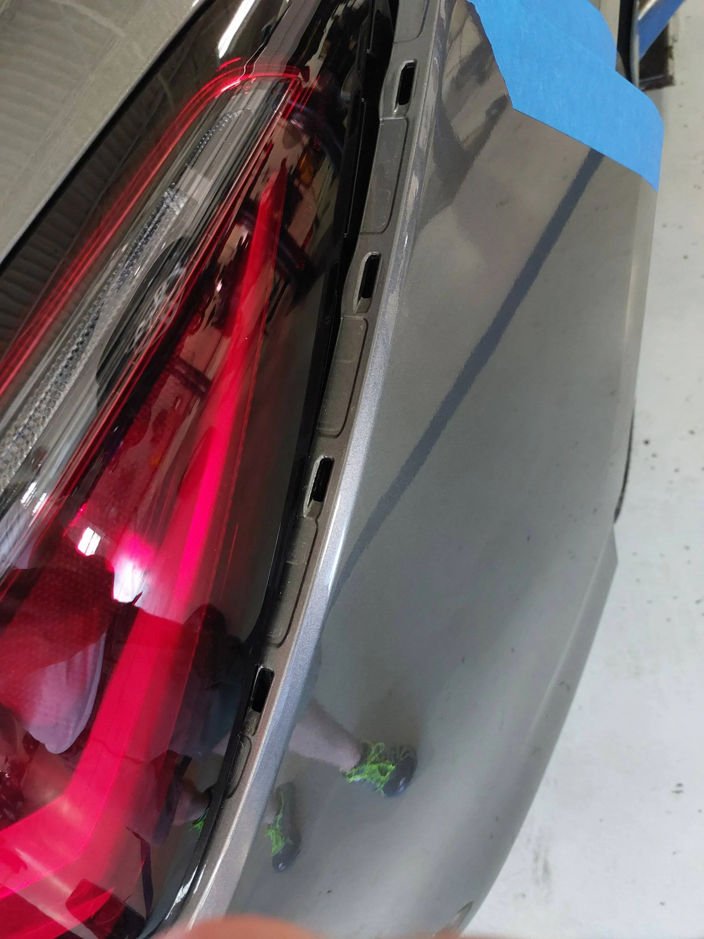

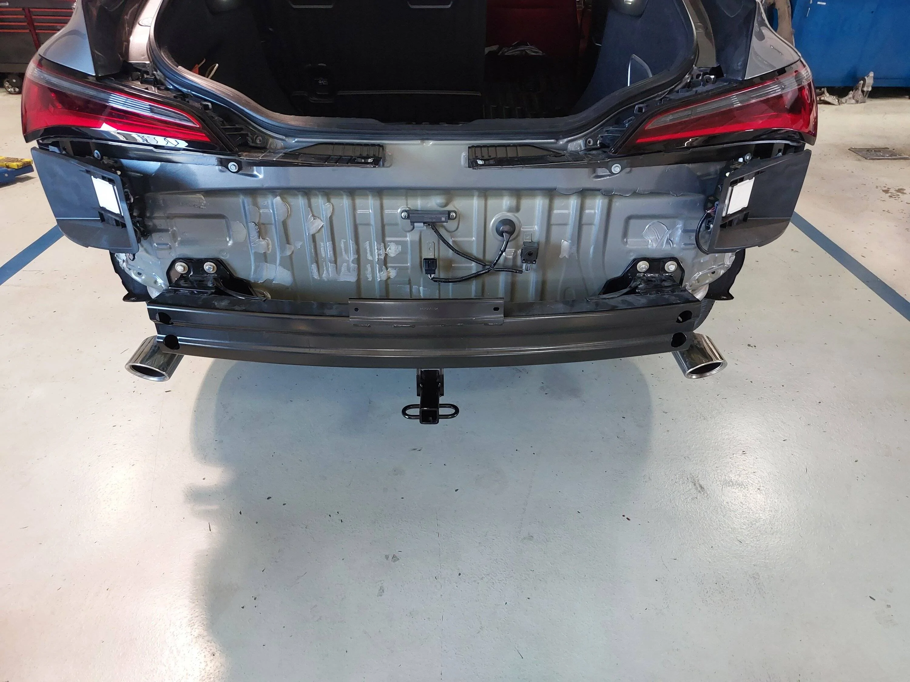

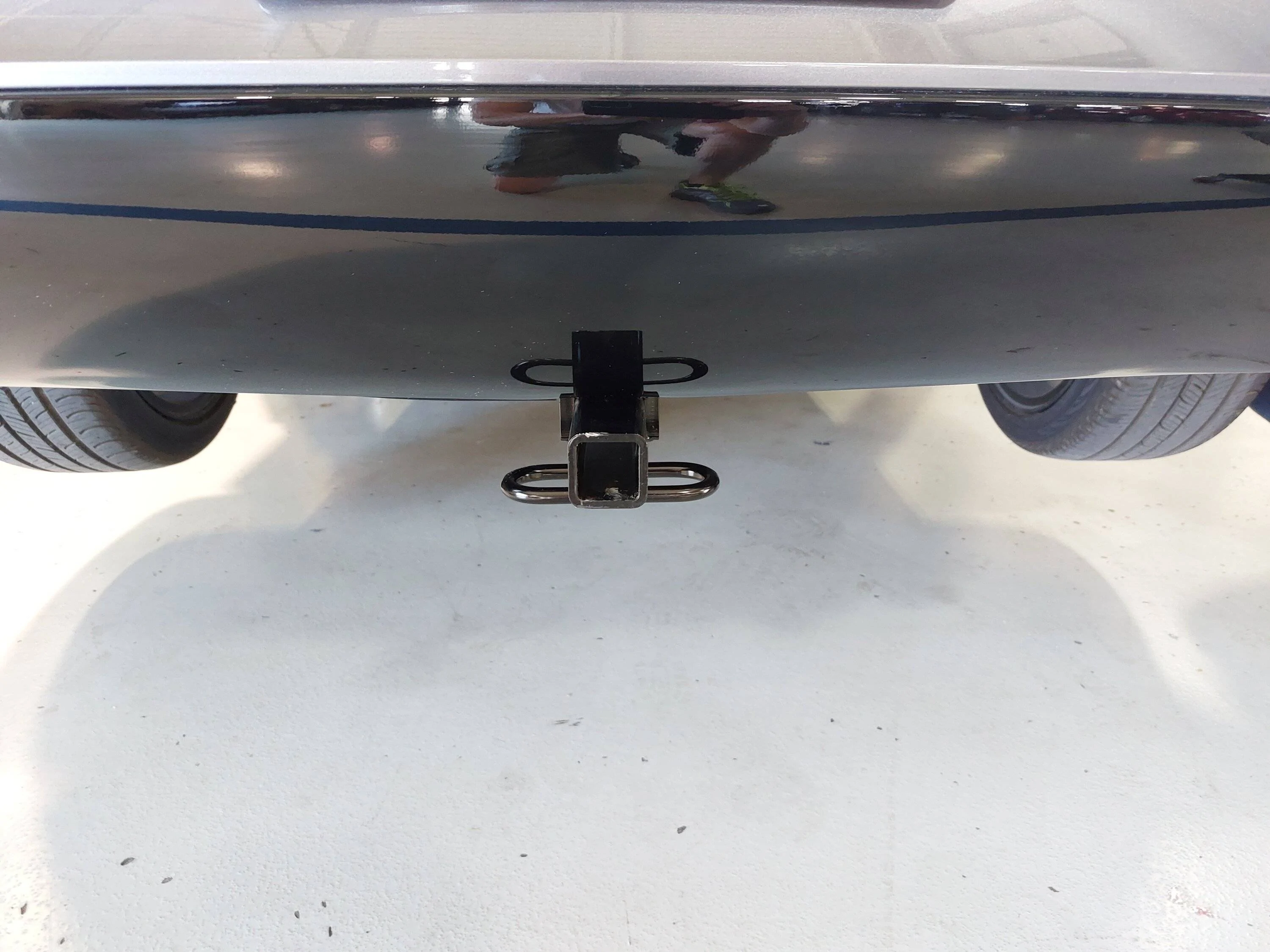

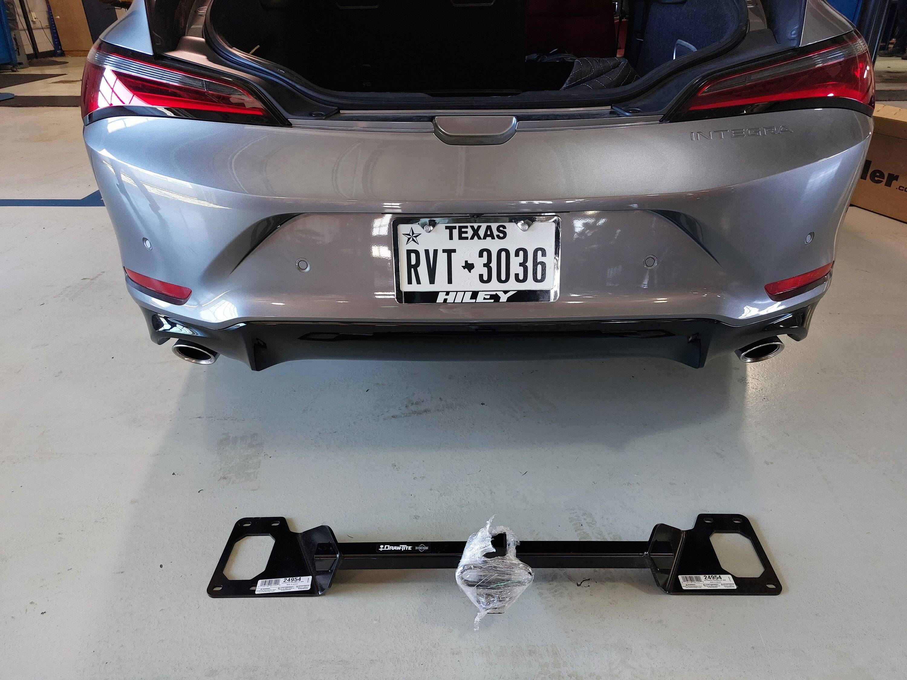

I got hitched today!
Thanks to the folks at Hiley Acura of Fort Worth that were willing to roll the dice with me and give the Civic hitch(draw-tite 24954)install a try.
Taking the bumper cover off is even easier than seen in the Civic videos. The backup camera and parking sensors have one shared connection that's easily undone.
I decided not to trim the corners off the bumper beam since a '22 Civic hatch installer said he was successful without doing so.

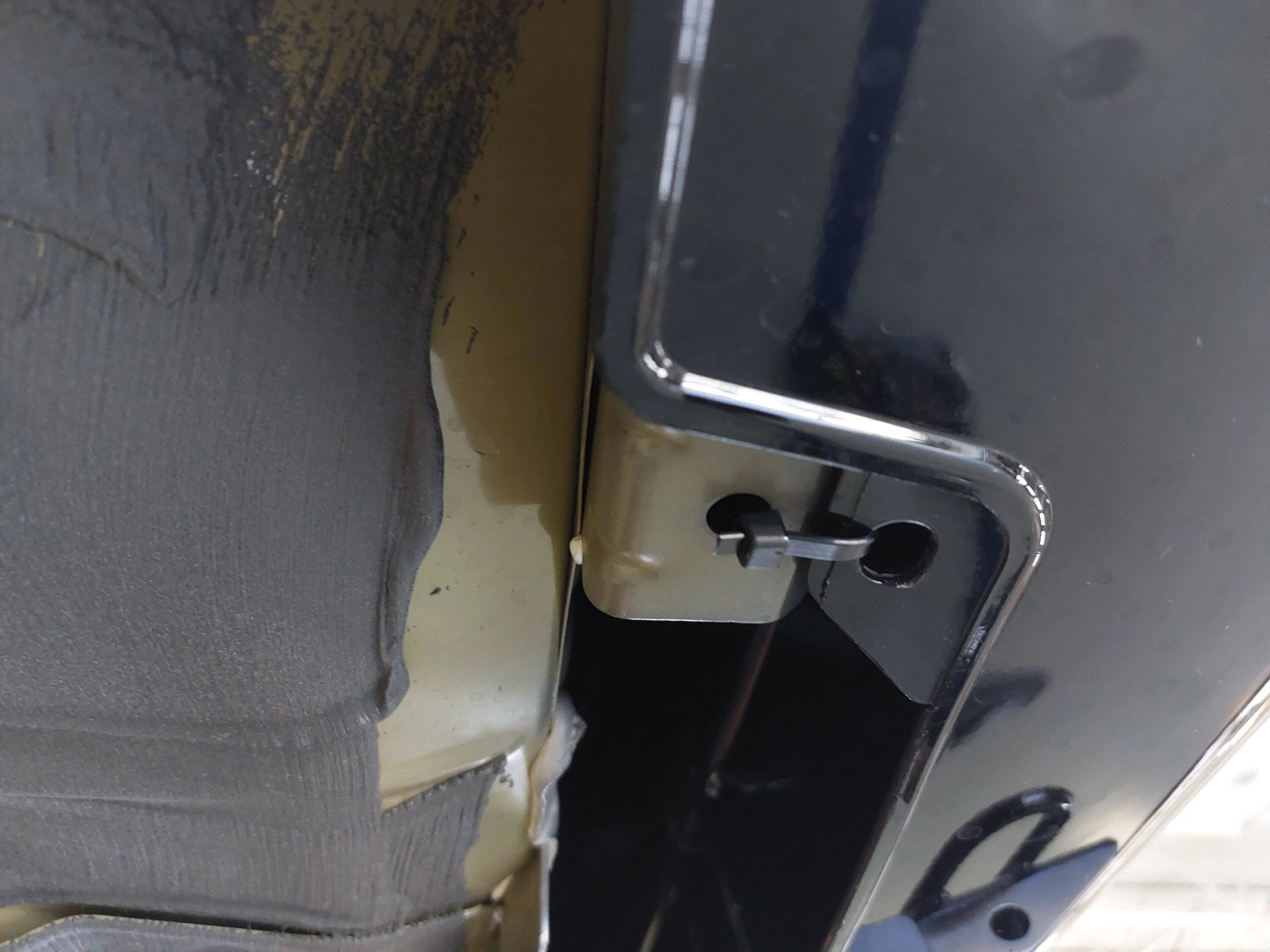

That probably should be done on the Integra too since while the cover went back on and looks factory two clips that go on the bottom of the cover don't line up any longer. So we just ziptied them. Not ideal but should be fine.
Took about 90 minutes to complete.

Do you have a Type S? Otherwise how are you not able when the Draw-Tite #24954, which is a 1.25", has been documented to fit Integras with very little hassle?
