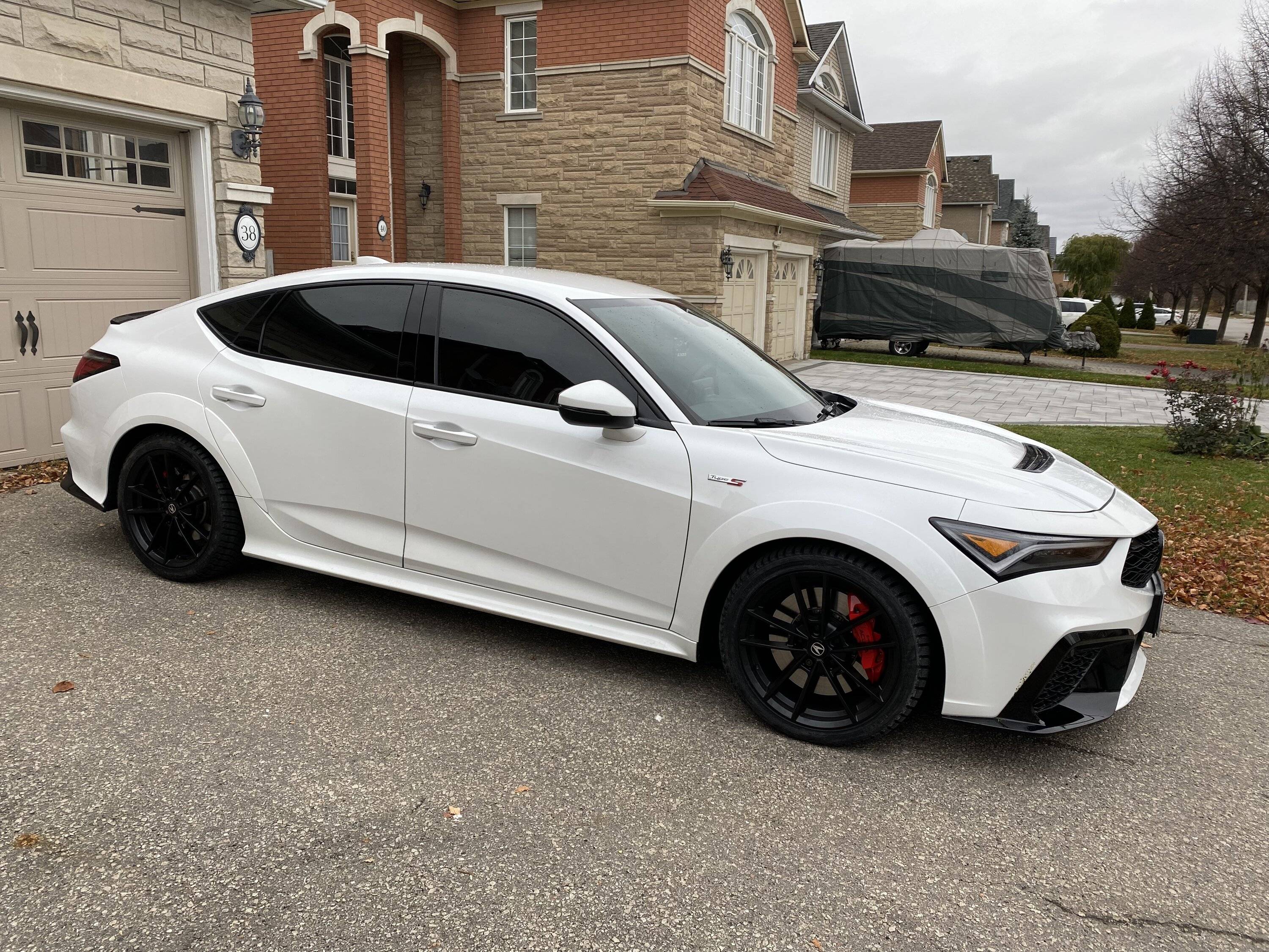

Here is my economical setup. I didn't go for any nice brand stuff and saved some $.
Some no brand wheels. 18x8 +40 offset. The shop says they are called "REV" wheels.. They also throw in some Acura wheel caps for free to complete that OEM like look. :thumbsup:
Nexen Winspike 3 tires. 235/40 R18. Korean made. Some online reviews say they are pretty good for the price.... I will see how they hold up against Toronto winter.

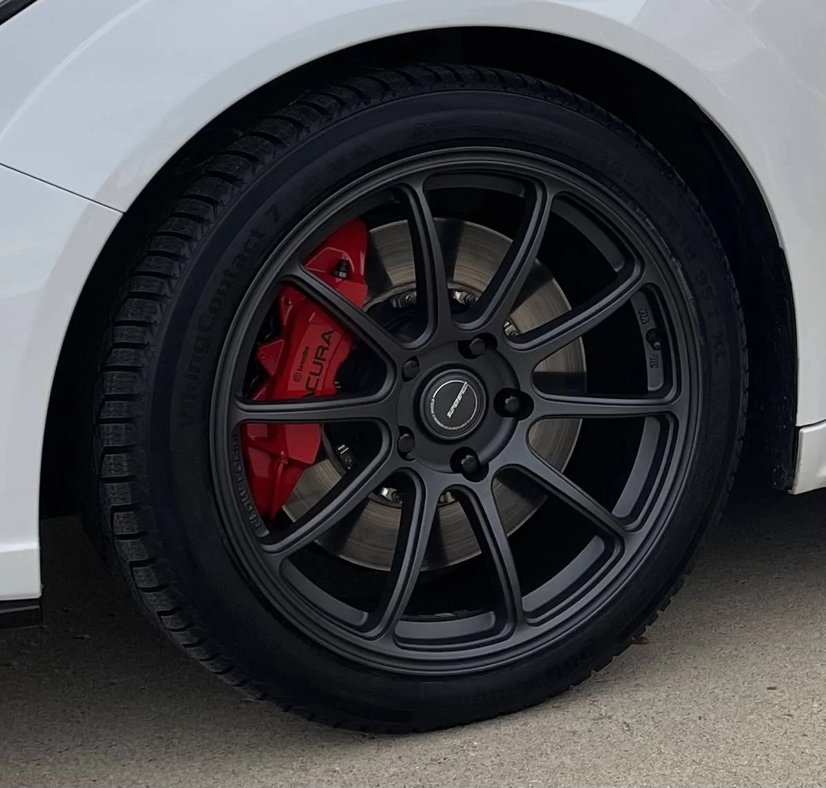

Here is what I did today, my winter setup. Superspeed wheels on Conti’s.
Got them from a Wheelsco, TMPS was supposed to be preprogrammed but it’s not working…sigh. I went for a thorough drive but still don’t sync up. Guess I’m heading to the dealer Tuesday.

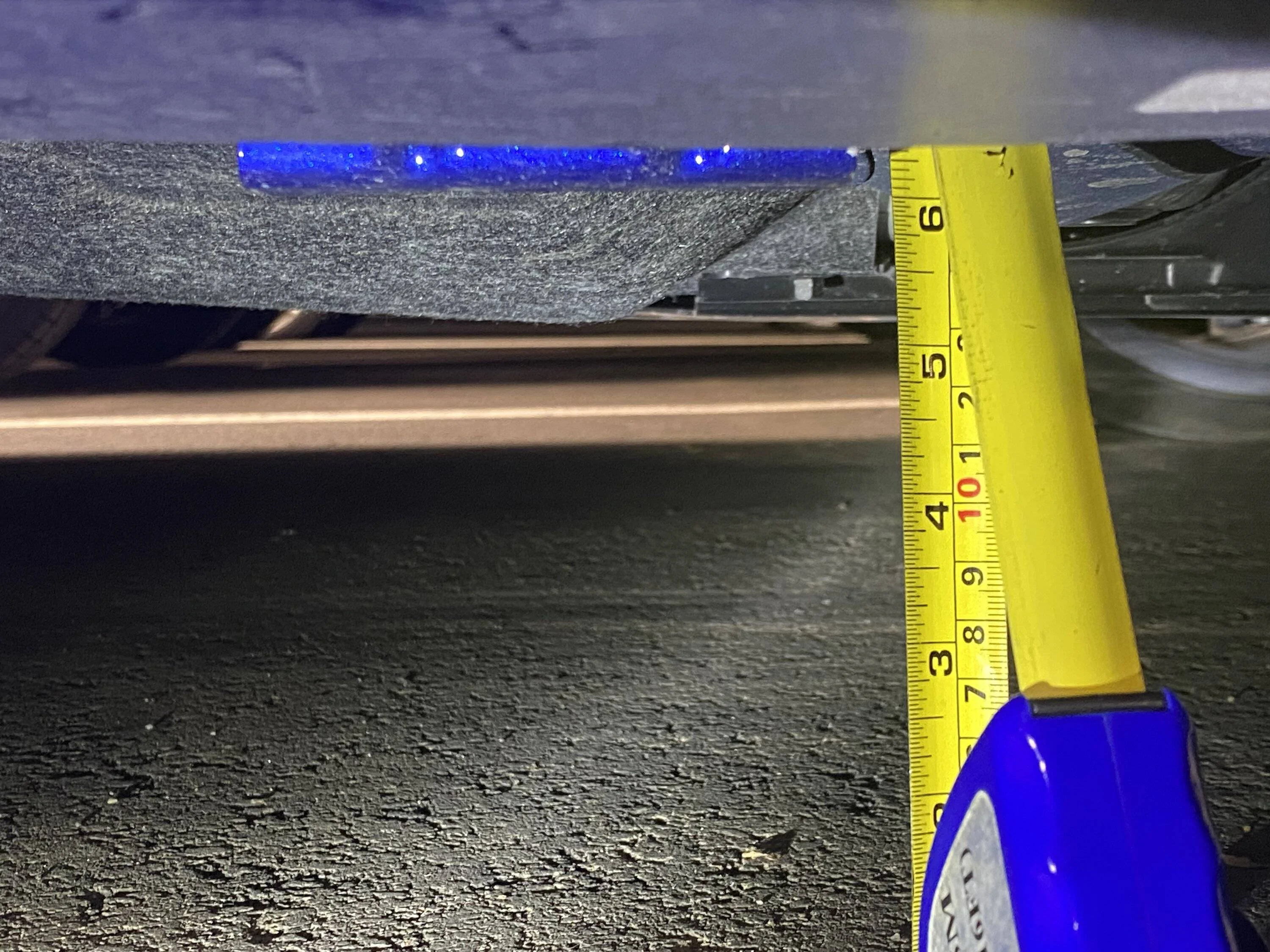

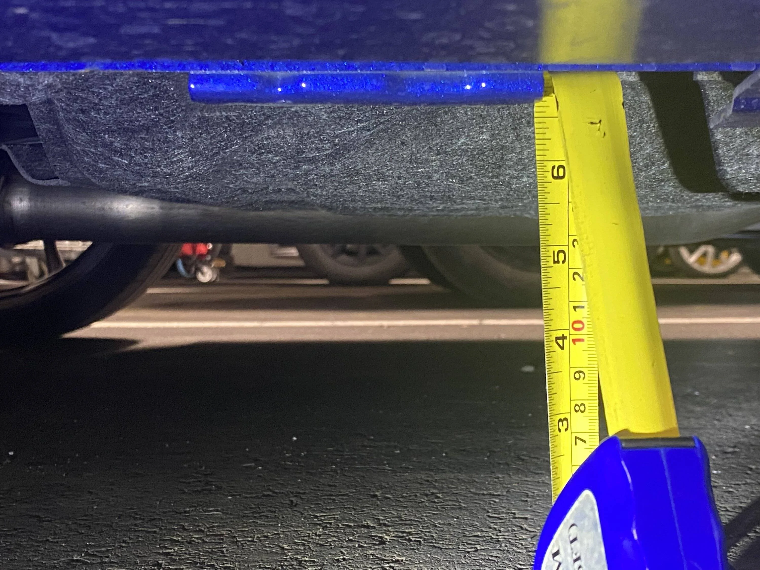

RE: the jack point height; I was wondering about the corner points. I’ve just measured their height as 6’’ at the front and 6.5’’ at the rear. Basically any regular jack should work for those.
For the front center jack point I guess height is irrelevant since even long-reach jacks couldn’t get to it unless the front-end had already been raised quite a bit (with ramps, etc).
