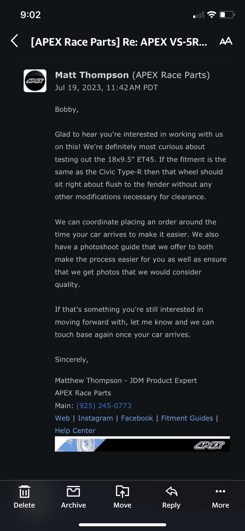

I asked Apex: I saw in this video that EC-7 18x9.5" ET58 fits over the Brembo front brake caliper on the FL5 CTR with a small amount of clearance. Will the ARC-8 18x9.5" ET58 also fit?
Per Matt Thompson (APEX Race Parts Support) <[email protected]> :
ARC-8 18x9.5" ET58 will not fit without at least a 10mm spacer effectively making the wheel an ET48 offset.
So I'd recommend that you confirm with Apex before purchasing
