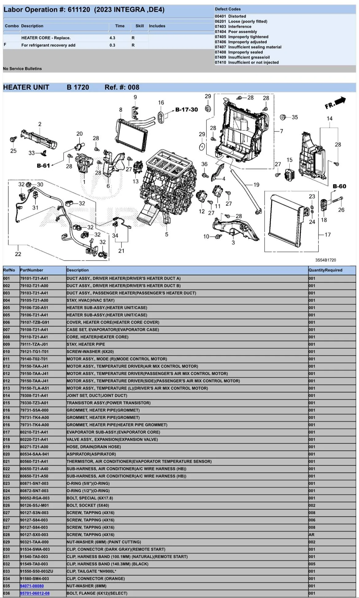

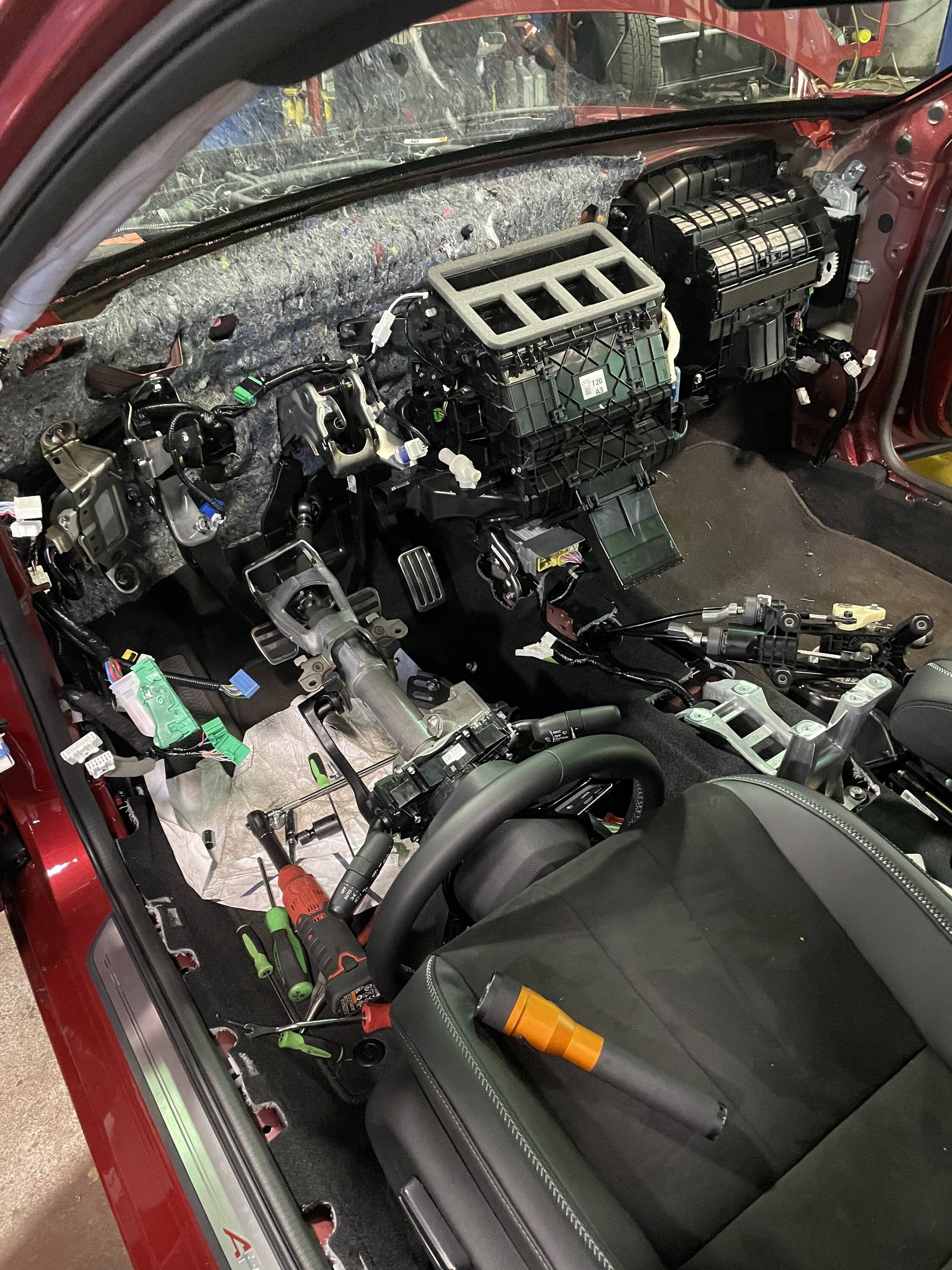

I am a Honda tech, and my project this week has been a 2023 integra with the rattle at 3500-4K. This vehicle is a manual transmission, and it only happens at that RPM range. I just found it yesterday. We found it to be the heater core rattle against the heater box. Also found that the heater box’s mount was broken. The whole dash is out, and we are waiting on parts now. You can see if this is your issue by revving the car to the point it makes the rattle and have someone wiggle the coolant lines that come out at the heater core.
I noticed that my Integra JUST started doing that about two days ago. So I now have three completely different squeaks and/or rattles...this new rattle sounds like it's coming from under the dash and occurs between 3000-4500 rpm. There's still the squeak from the bezel around the HUD, and the hatch rattles. So it's definitely not a quiet ride at any given time. I guess I just couldn't hear the newest one until I took the roof bars off, because they will drown out even your most inner thoughts.
1,477
1,194
number 9 is the heater core pipe retainer. they call it a stay. The top tab was broken off allowing the pipes to touch together.
Is this also to say that it may likely happen again with the same kind of fix & parts until Acura/Honda find a better solution towards a forever fix?
This is exactly what happened to my 2025 ITS and how they had to fix it. Straight from the dealer sale, discovered the noise on the way home, and straight back to the dealer where I was without my new car for almost a month.

I am having a similar issue on a 2025 A Spec 6MT… they told me something about needing to remove knee air bag and fixed the heater core rubbing against something… after seeing this tear down to do that job I might live with the rattle. There is low chance anyone is putting that dash back together with care in that time allotment Acura is paying. I would be worried of more rattles coming from broken clips or elsewhere on reassembly. Does this job actually need to take the entire dash apart or was that just done to find the issue?
If the heater core or one of the pipe is rubbing/chaffing on something, I'd be more concerned with it developing a leak over time and possibly causing more damage. Imo I'd take the risk of slightly more/different rattles over coolant damaging any electronics in the area or soaking the carpet
