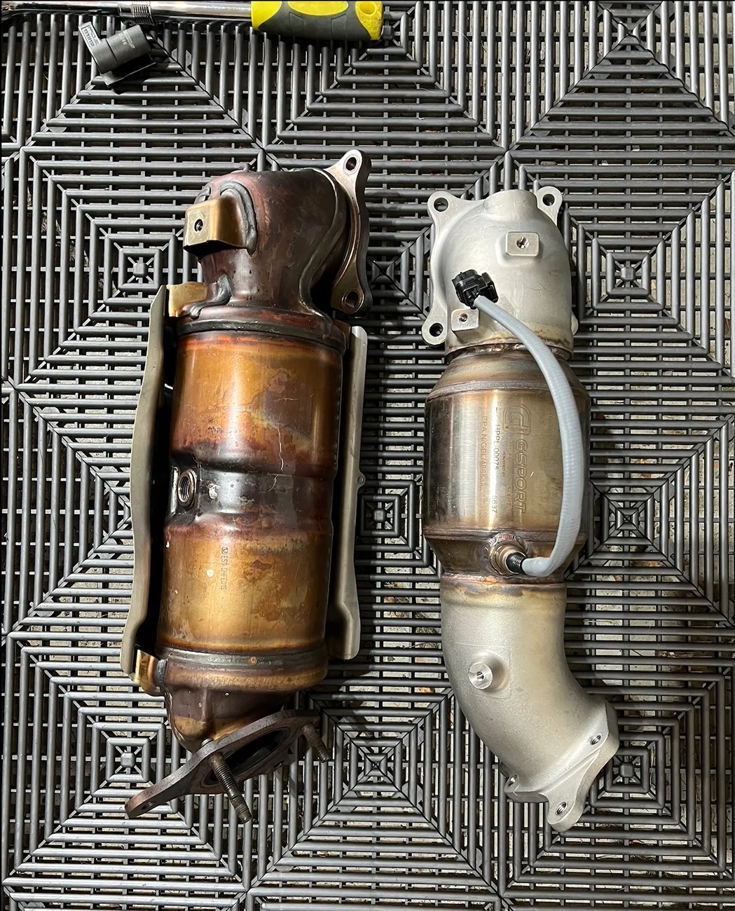

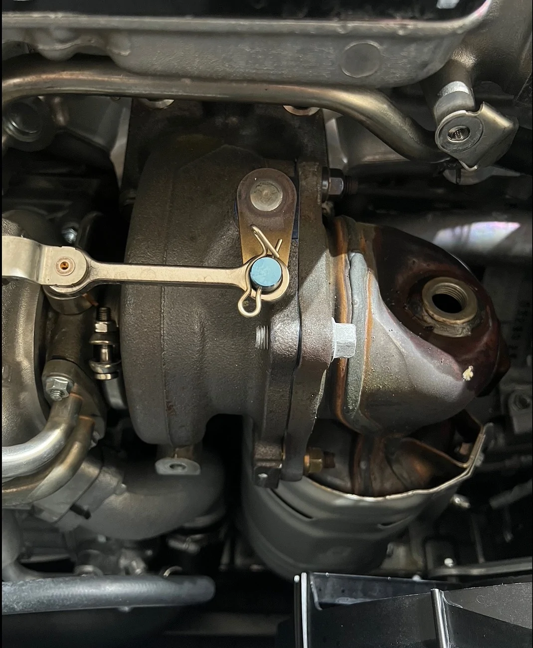

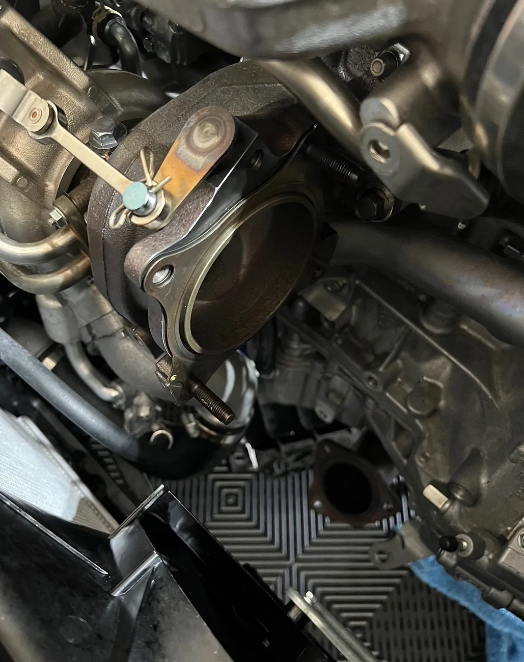

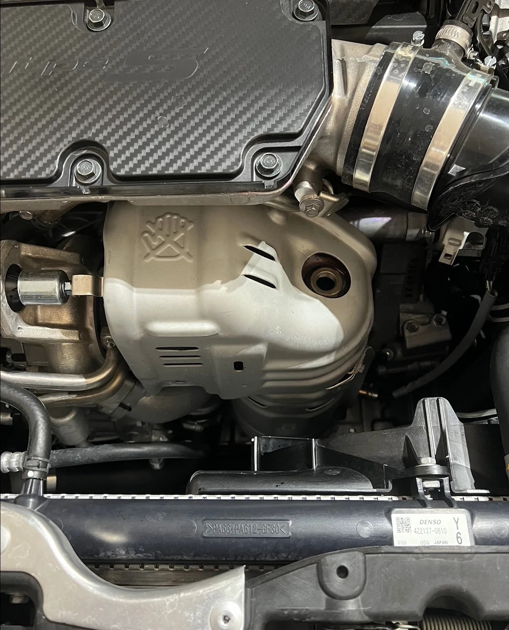

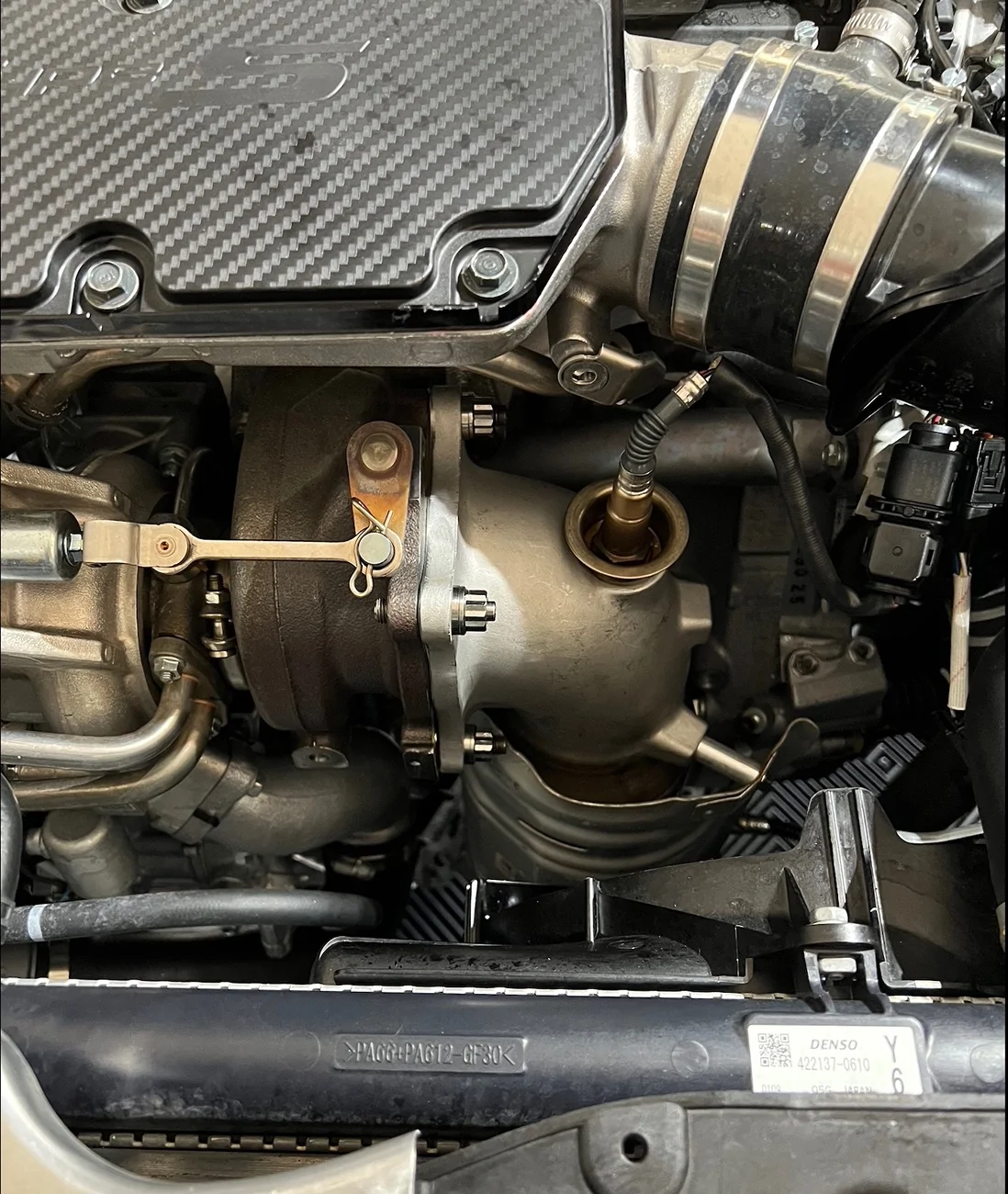

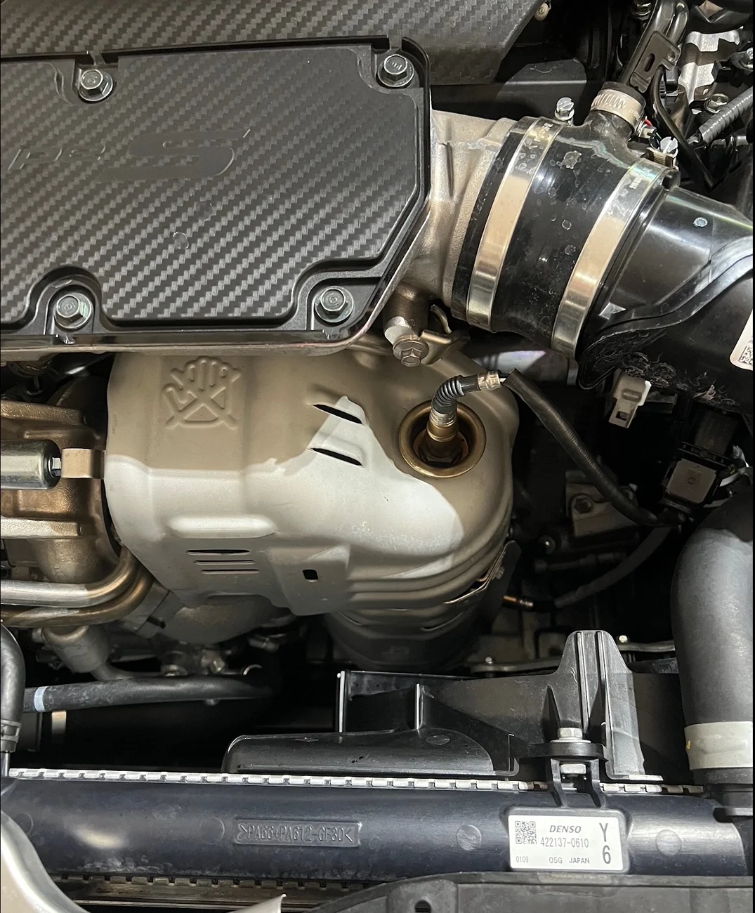

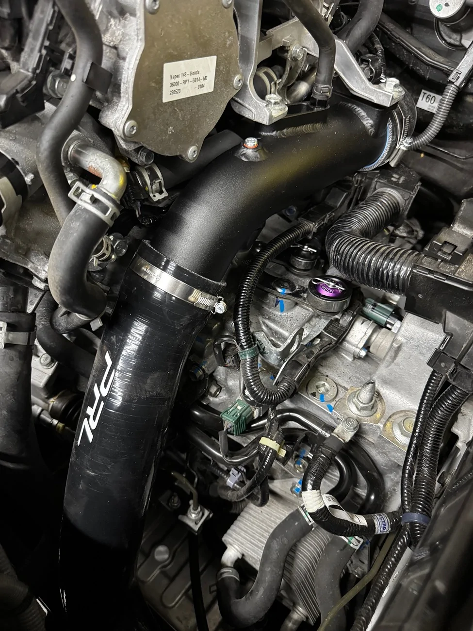

Installed the TSP catted downpipe over the weekend.
Dropped off the upper heat shield at the powder-coater for a high-temp black coating.
My Recaro seats were released from customs in Illinois, so I should have them maybe tomorrow.
The PCI sliding seat mounts shipped out of CA yesterday. I hope to have the seat install completed within the next two weeks.

Curious as to why you didn't go for any of the coatings or the blanket they offer for the DP? Just going for a OE look?

A lot of that stuff is gimmicky to me...especially on a stock turbo.
The downpipe doesn't need to be coated unless you want to pop your hood and stare at a coated downpipe. I just want the OEM upper shield to be coated for vanity purposes.

That totally makes sense. Looking forward to seeing how the black heat shield turns out!

Yeah the coating is only useful if coated inside and out. Even then a wrap still outperforms it. Ideally you'd want both, but benefit to both over just wrap is tiny.
The big benefit to me is keeping heat out of other areas of the engine bay, like the radiator, block, water pump, charge piping, etc. Stock turbo the car already has heat issues two laps in on a hot day, so if your goal is driving reliability there's a lot of benefit to be had with wrap, blankets, and gold foils 😊.
