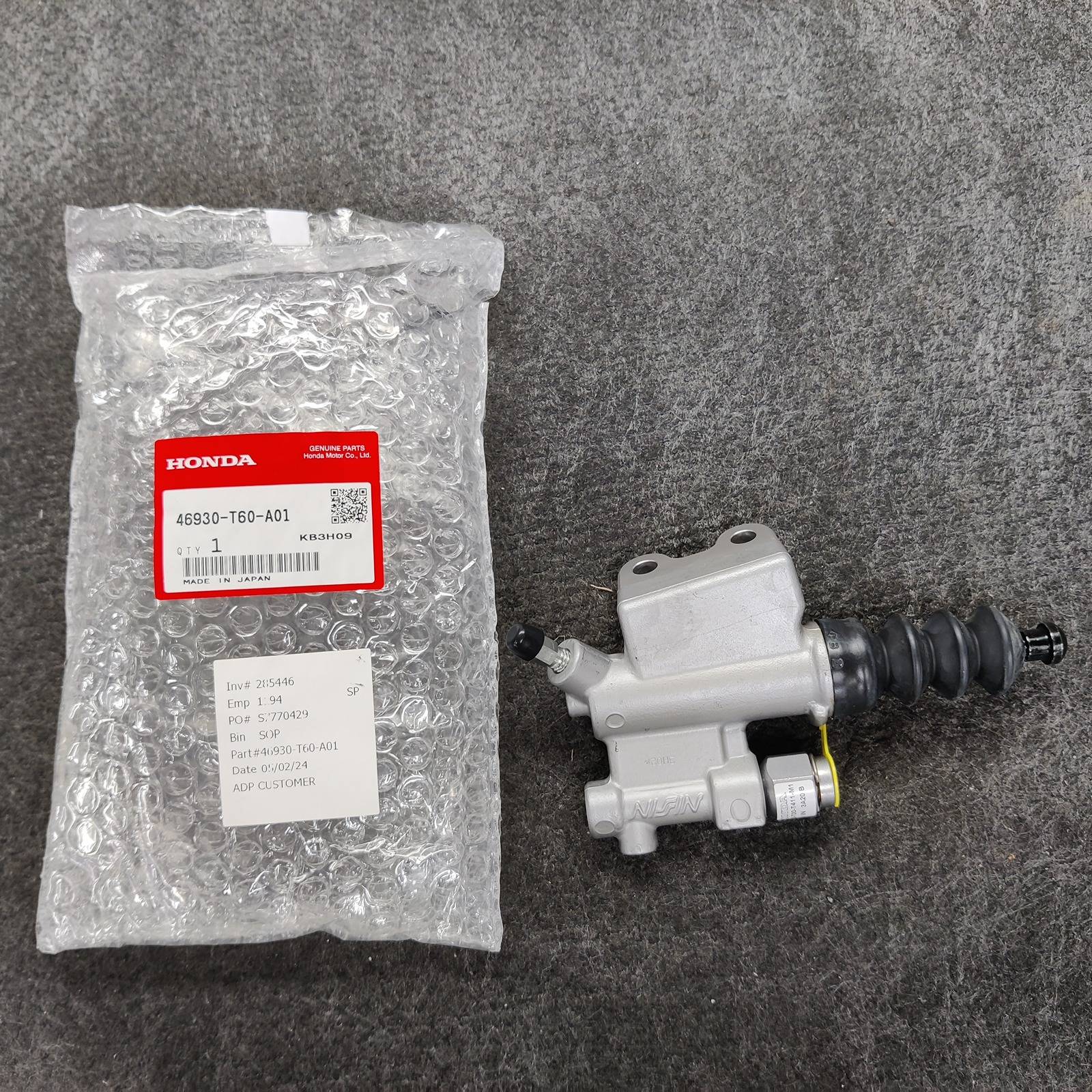

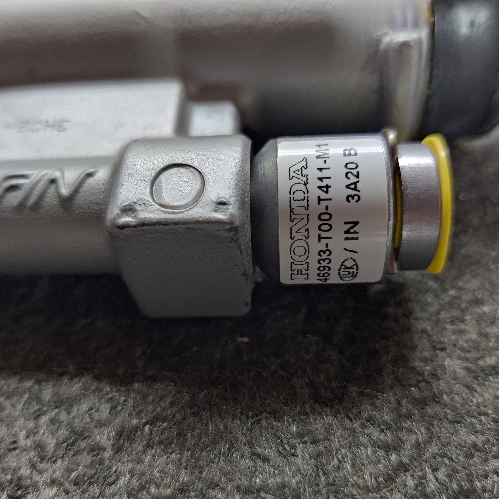

Had some free time tonight so I got started on the CDV delete.
This should take about 15-20 minutes to take apart and remove the the clutch delay valve if you have the right tools.
Tools used:
Safety glasses
Bench vise

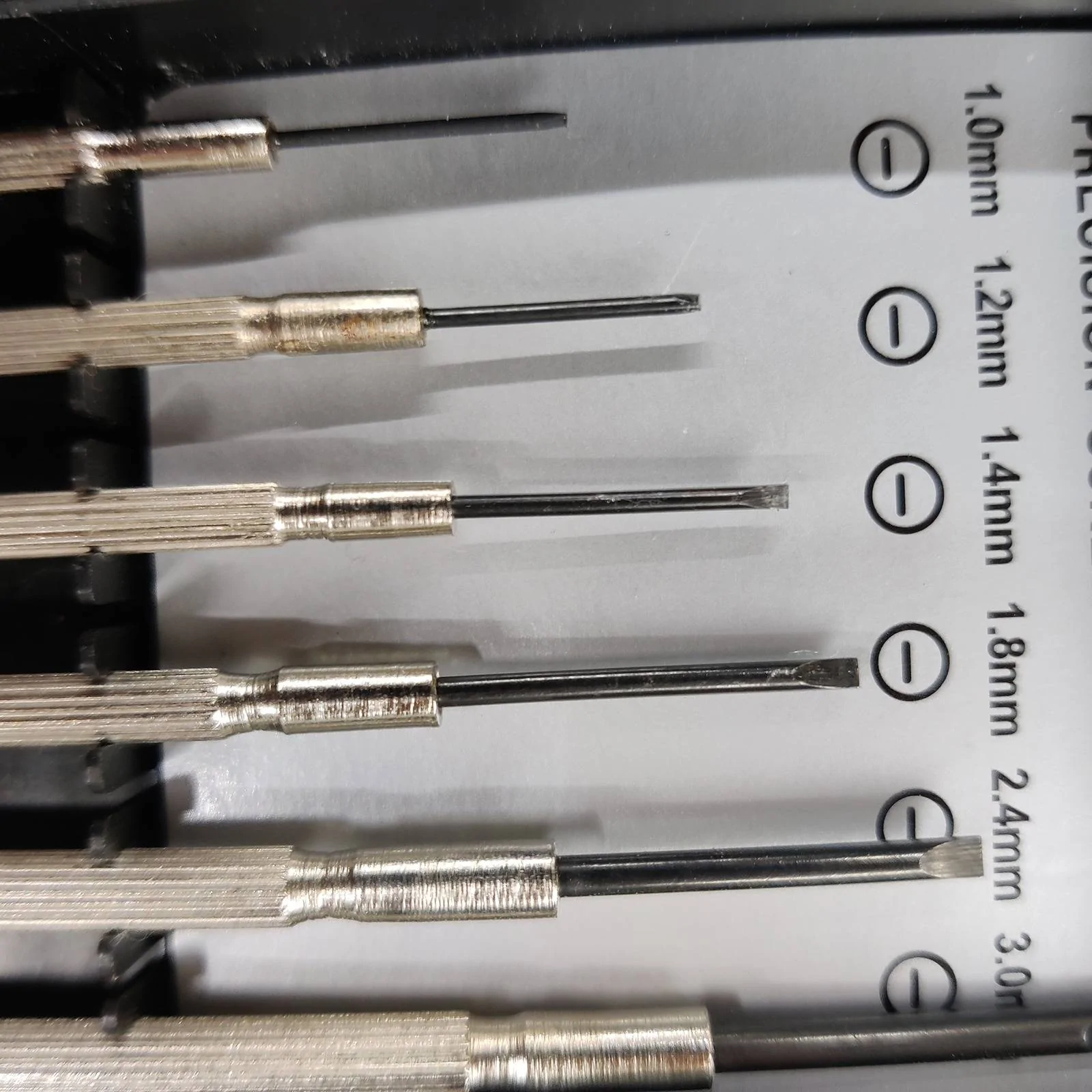

1.4mm precision flathead screwdriver
Needle nose pliers
Pick tool(s)
When doing this mod previously, I used the pick tools and had a hard time with it. This time around I used a precision screwdriver like you'd find in those eyeglass repair kits and it was much easier.

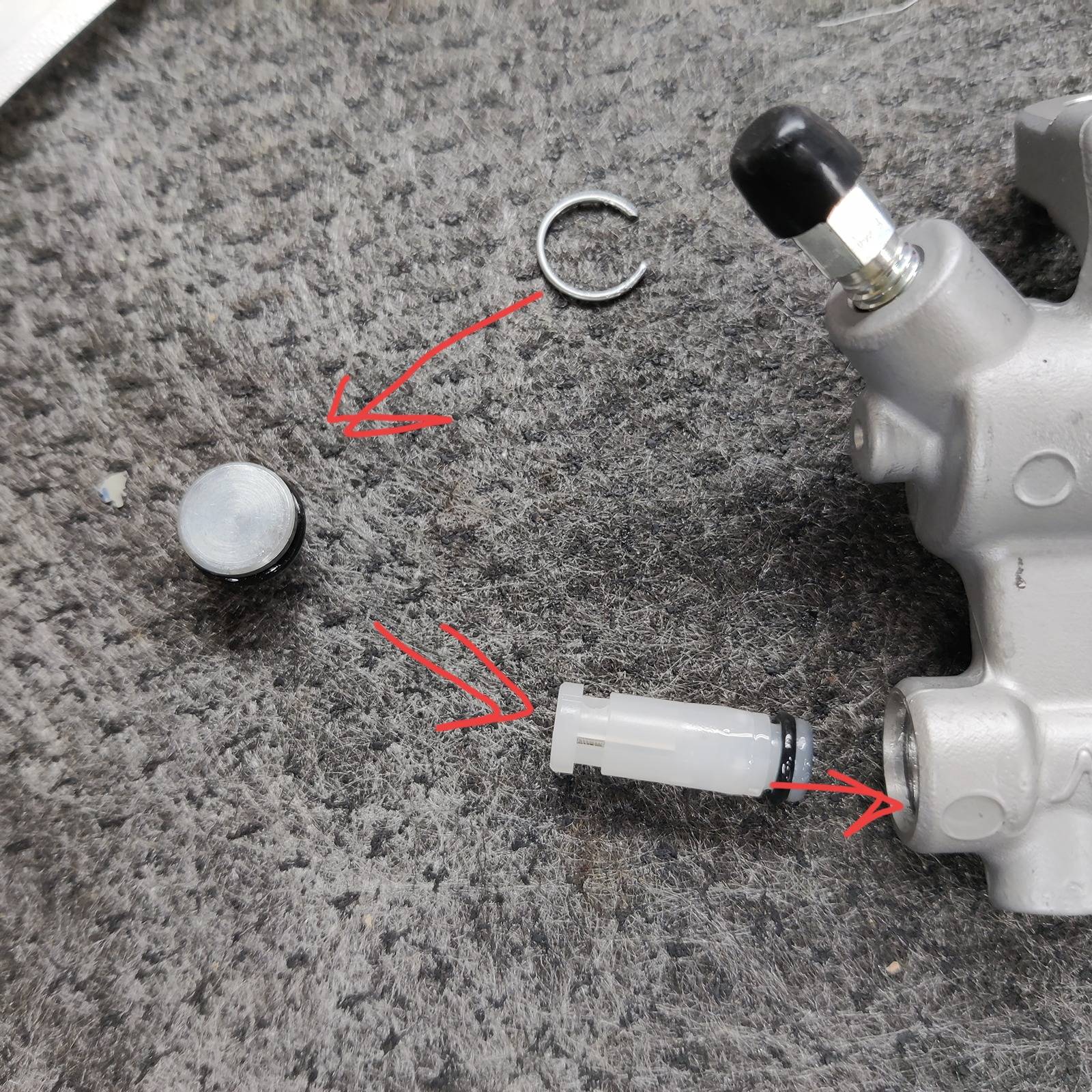

1. Just stick the screwdriver in between the C clip and "scoop" it out from the top.
2. Once the clip is out, use the needle nose to grab at the cap and remove it.
3. With the cap off, use various pick tools (or a wood screw) to remove the delay valve (white plastic piece). Discard or preserve it in a jar like a lab specimen.

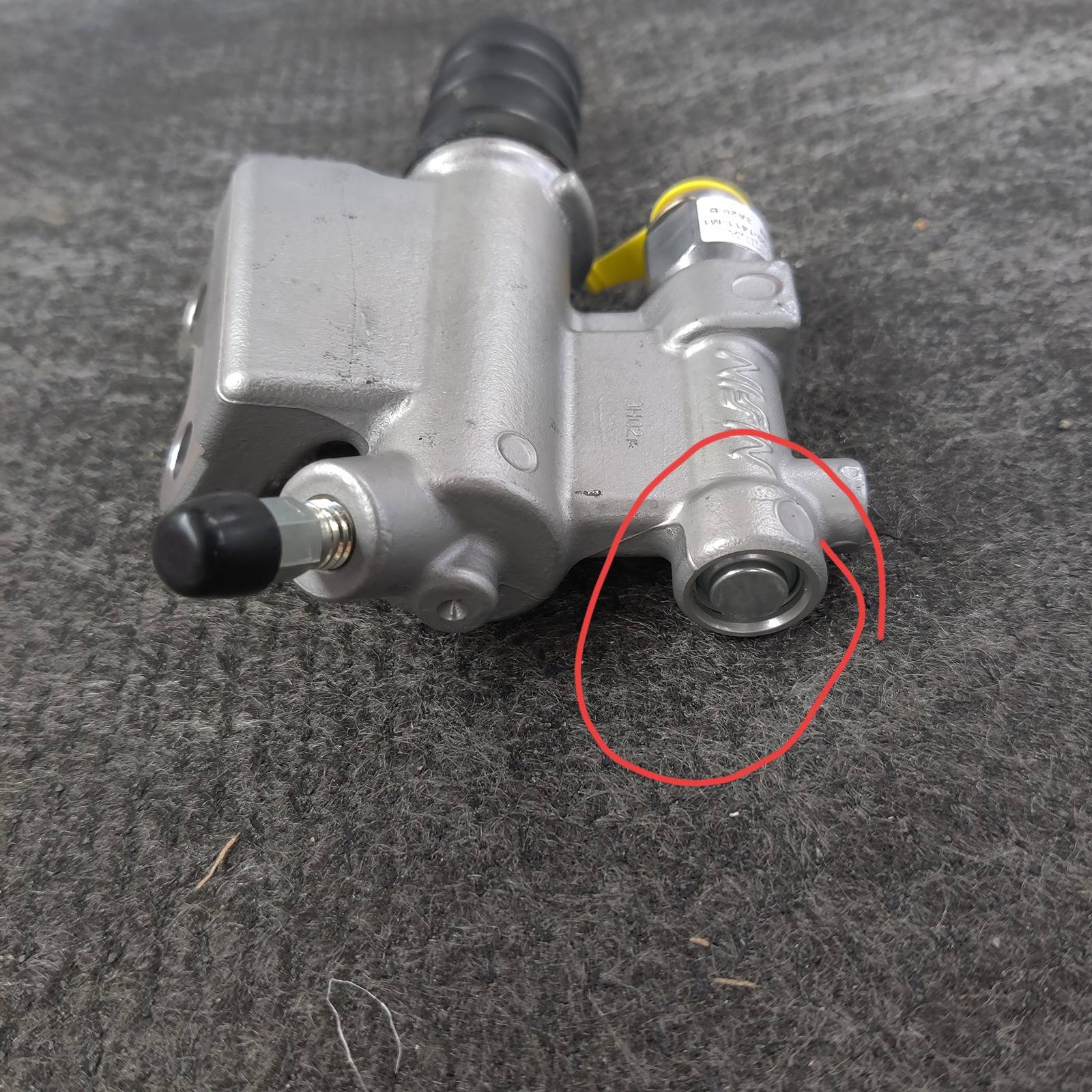

4. Re-assemble the slave cylinder.
I'm waiting on some more parts to come in but I plan to install the modified slave cylinder this weekend along with the Sirimoto stainless steel clutch line and clutch damper delete hard line. Then bleed the system and go for a drive.
