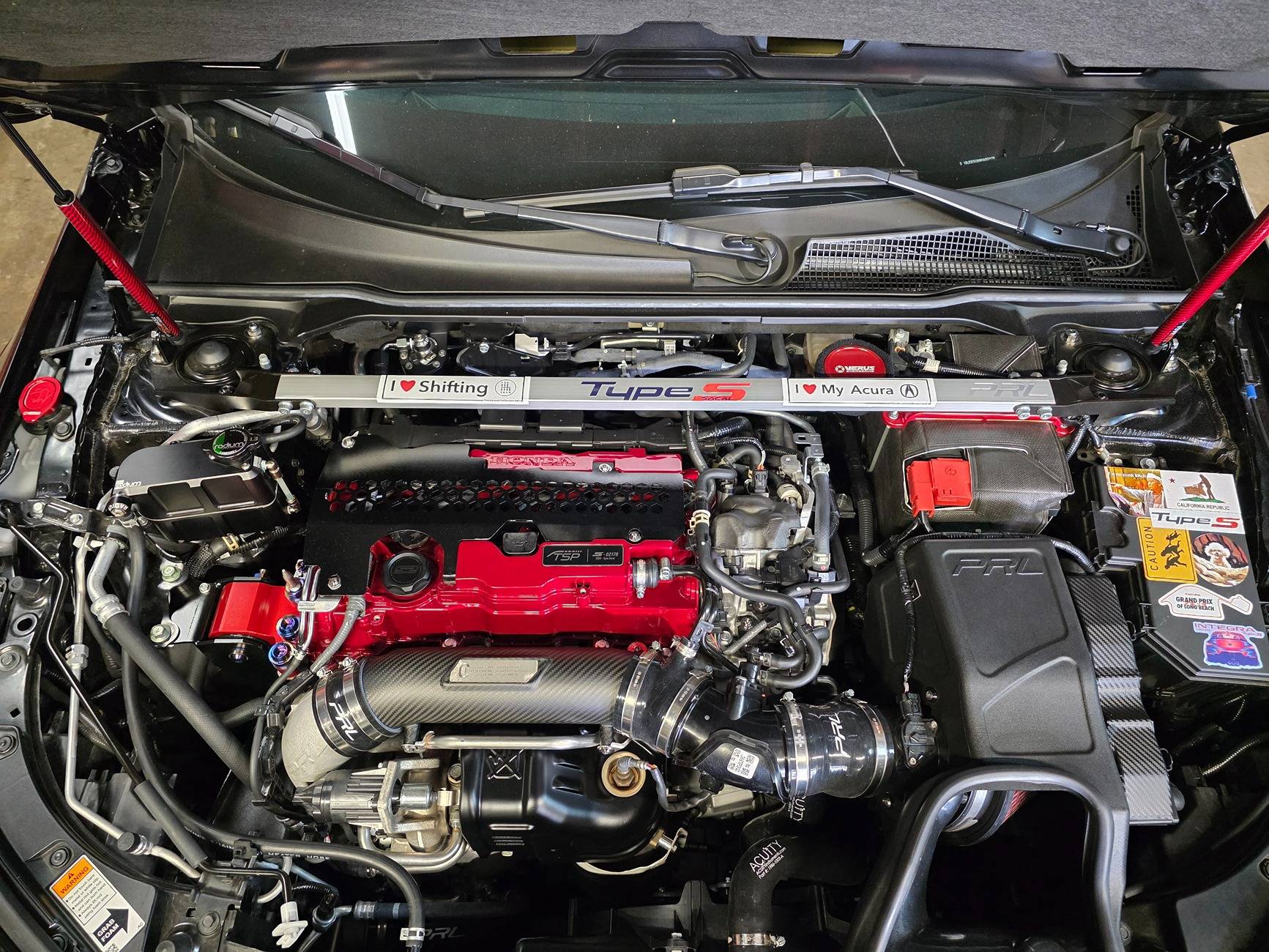

I painted the top heat shield.
Put a base coat of high temp matte black first, then I applied the MBP.
Waiting to see if it will bubble/peel.
New black skunk2 oil fill cap.
TSP valve cover label.
I wanted to put ig addy under the TSP like they have on their website details but I was told no ?.
I put the ChasinJs Ti valve cover label where the PRL used to be on intake tube.
And red Verus brake fluid & washer fluid lid covers. Also some Ti bolts too.

the versus caps really fits well

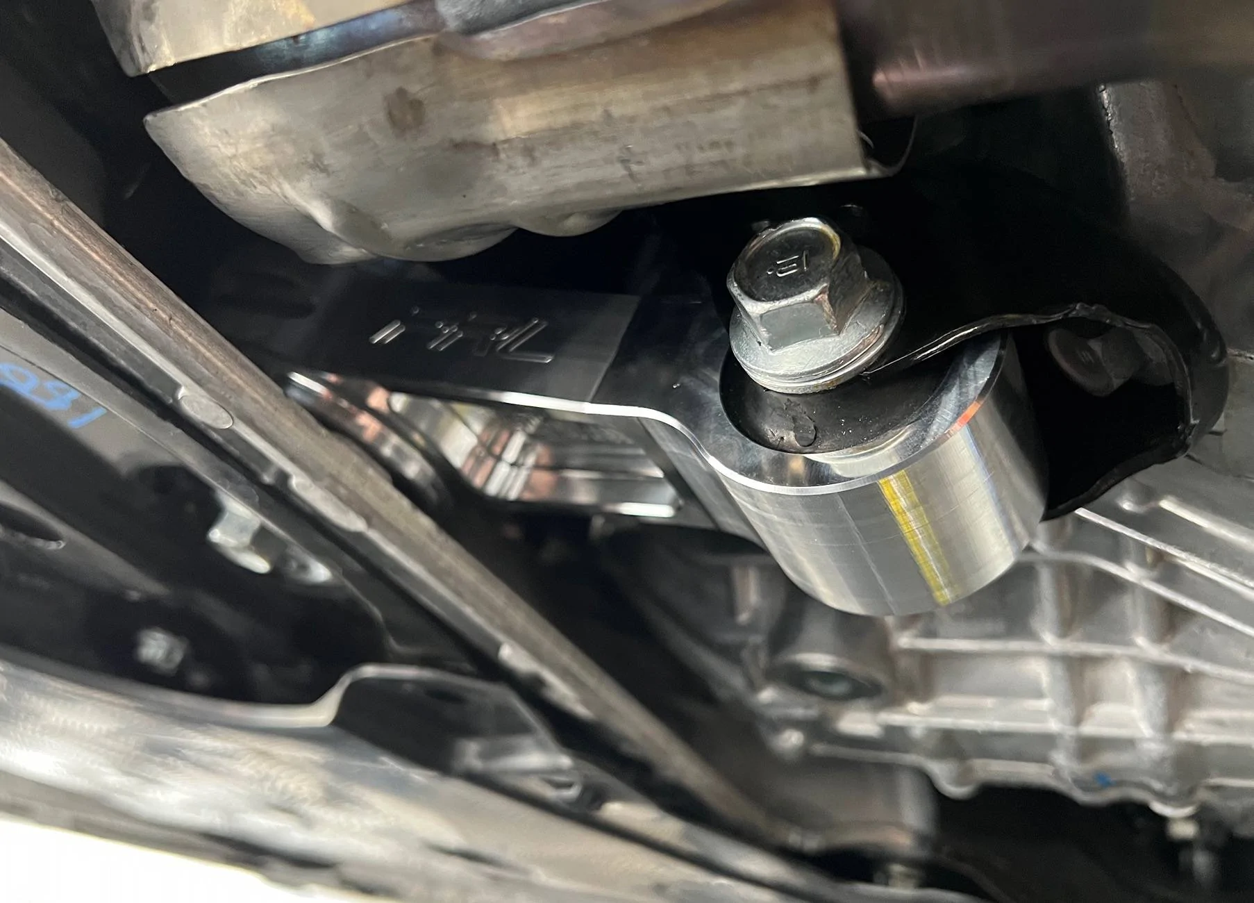

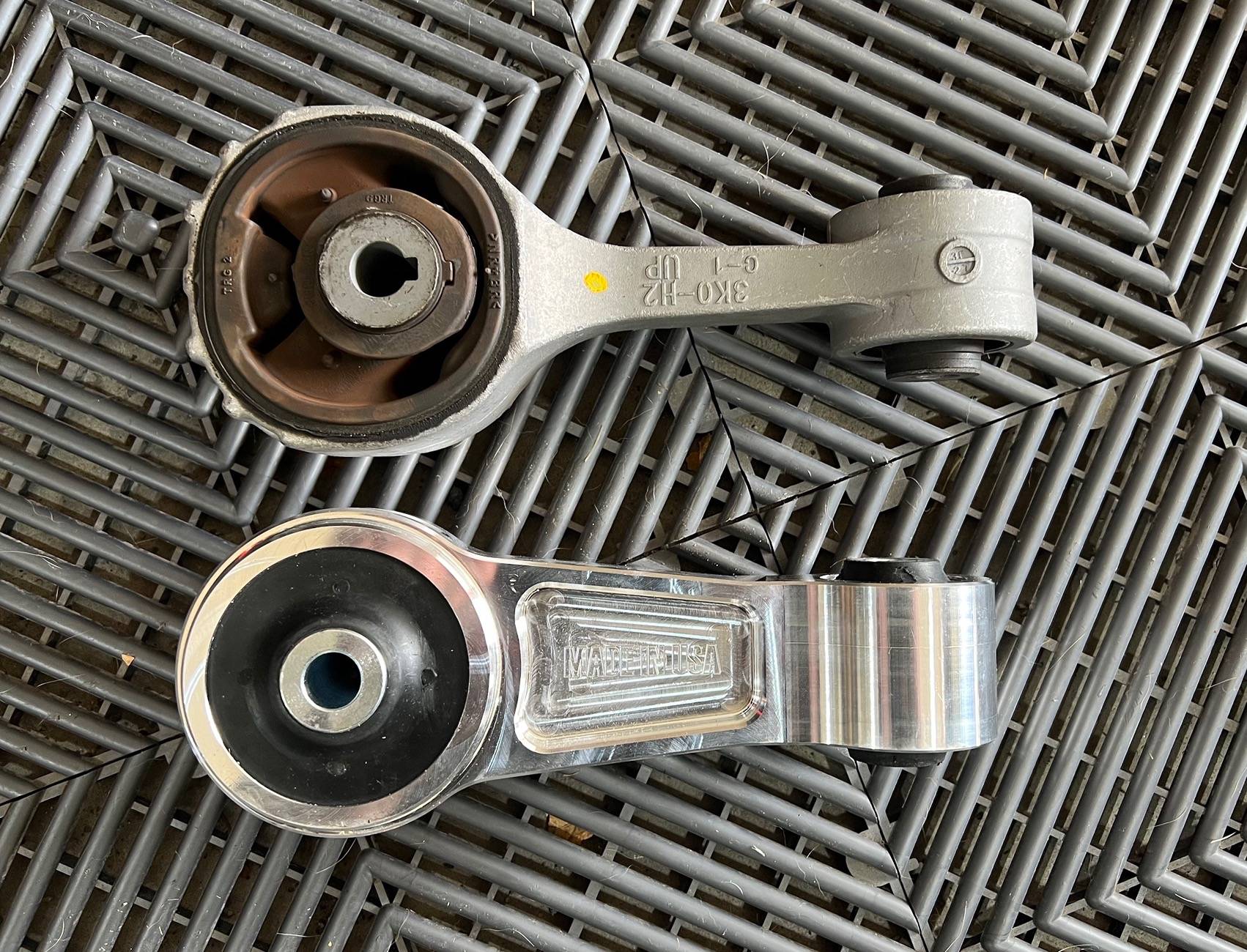

It's 10-15 minute easy installation.
Remove the aluminum floor pan and then two bolts holding the rear motor mount. Undo both bolts and wiggle the OEM mount loose. Feed the PRL mount into place (with "PRL" being in the correct readable configuration) and snug up the OEM bolts and you're good to go.
