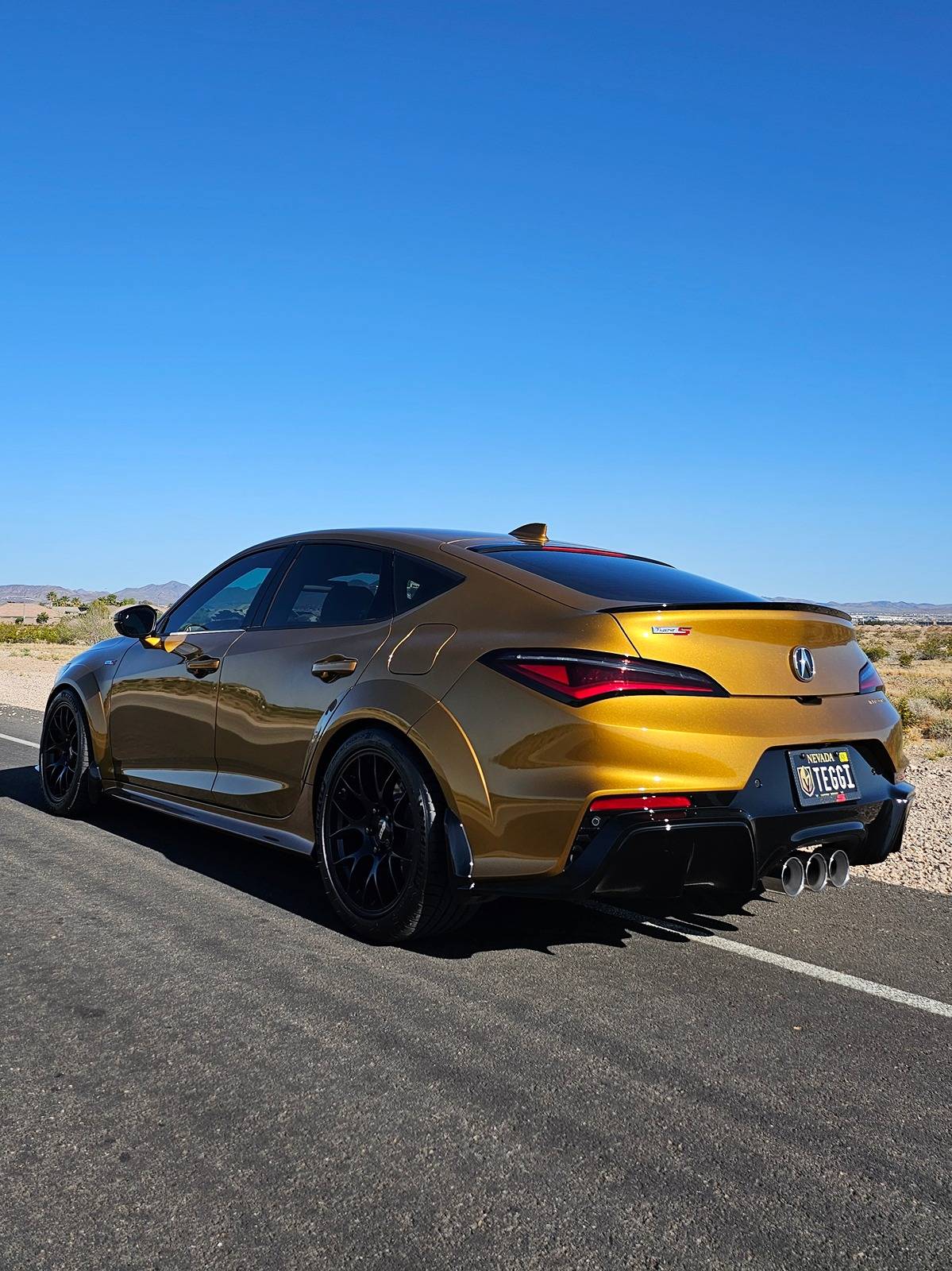

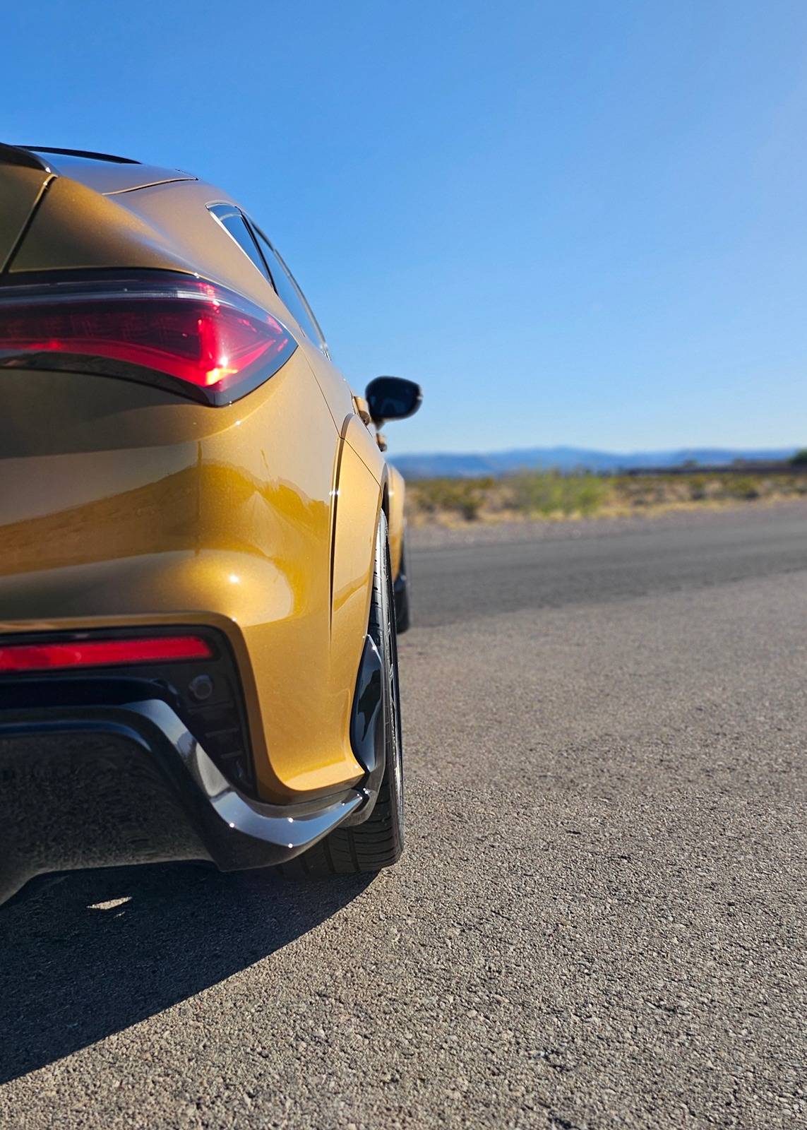

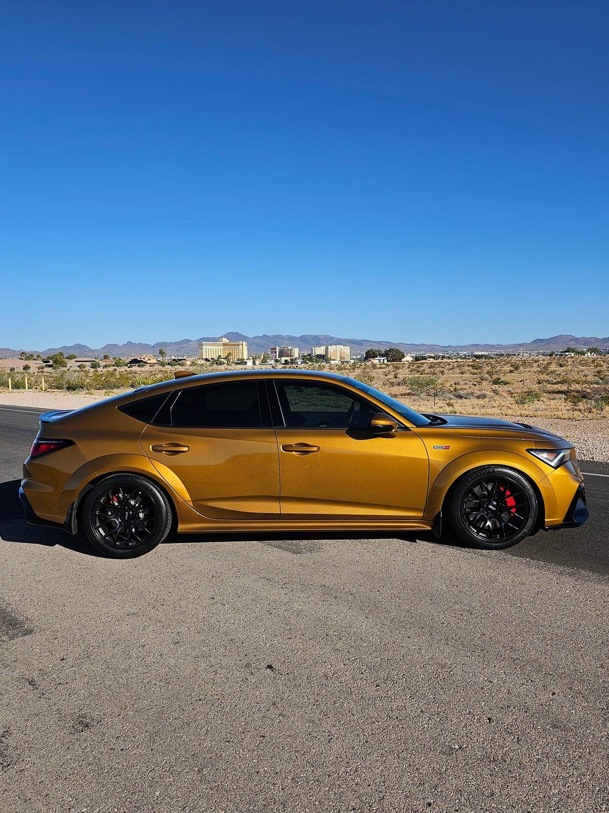

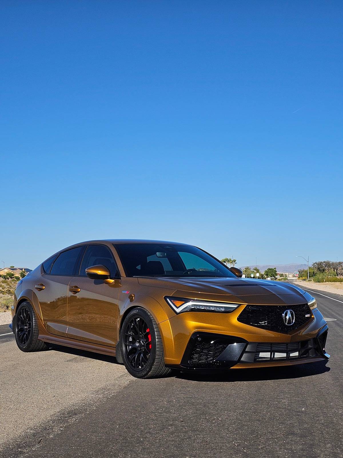

Eibach Prokit installed and RV6 RSB w/their bushings. Also have Bonos 15mm /20mm spacers running 275/30/19.

Which RV6 bushings did you install? All of them? I'm curious re: the compliance mounts and F/R sphericals.

Just the end links for now. I have SPC adjustable camber to install but it looks difficult since the rear bolt has maybe an inch before hitting the fuel tank. Also you need a bolt and nut to attach the lower arm Feedback sensor.
I will say it feels much better in Sport mode. Front seems stiffer which I thought was overly soft. Which may have been updated on later builds from what I have read.
