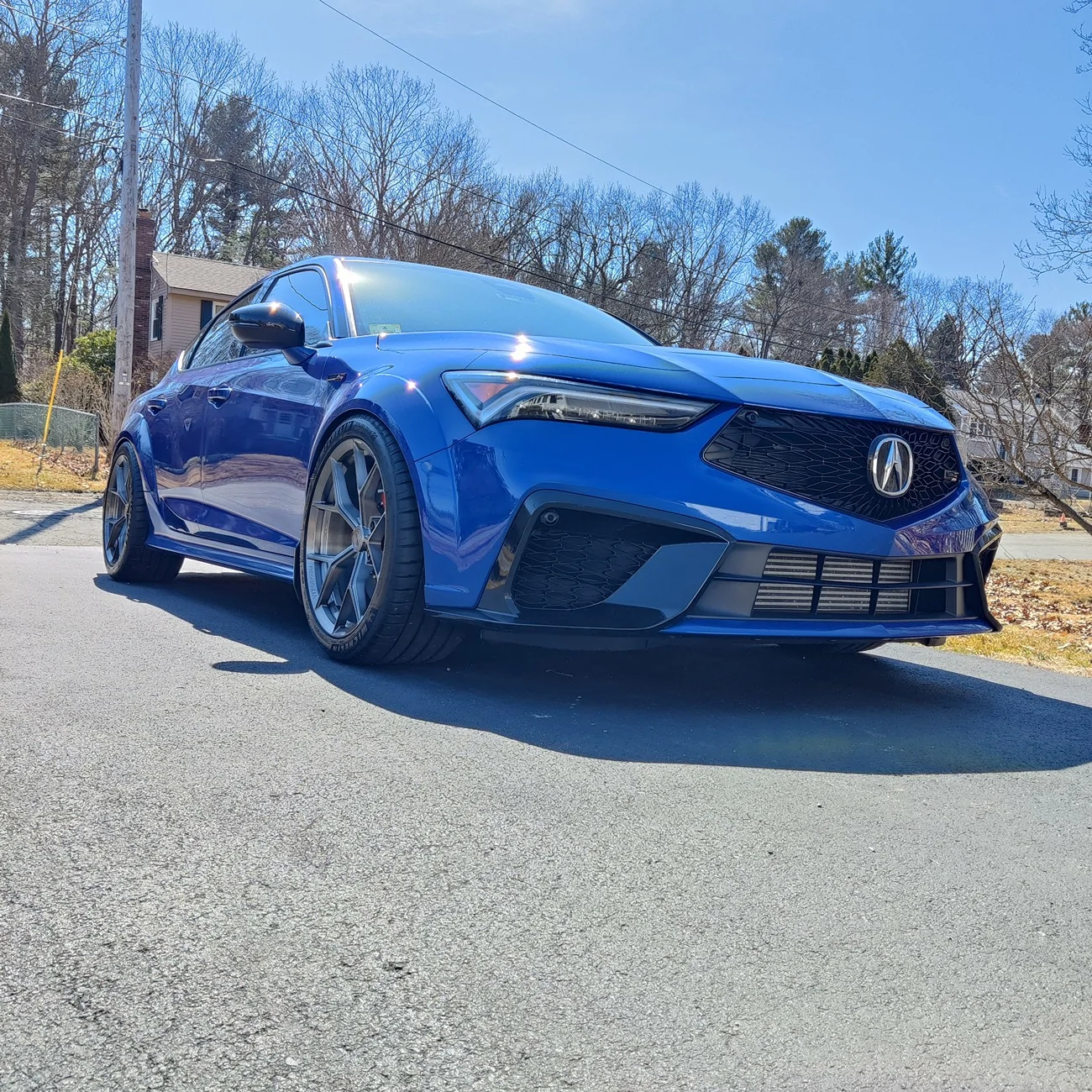

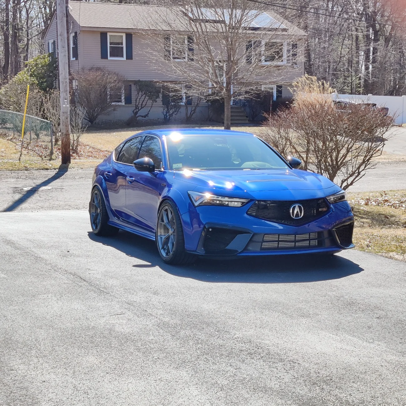

Do you plan to lower and also are you dead set on 18"? I agree with Optronix that the scrub radius concern is fairly negligible in day to day driving.
FWIW if you're looking to run a square setup, 10" +40 is juuuuust about dead flush as far as the wheel goes, as is 9.5" +35. The rears *might* need a couple mm less than the fronts to be REALLY flush but you run the risk of rubbing once you go less than +40 and +35, respectively.
A 275/285 tire will give you the slight poke you desire.
19x9.5 +35 275/30 PS4S for reference, lowered on H&R. A 19", 35 profile tire would not work if lowered, not without some aggressive camber.

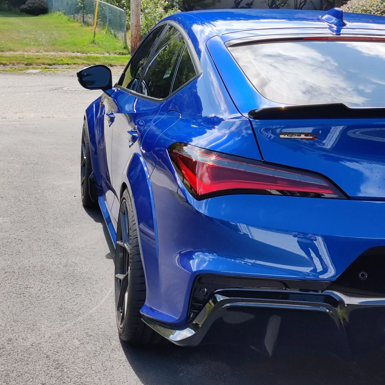

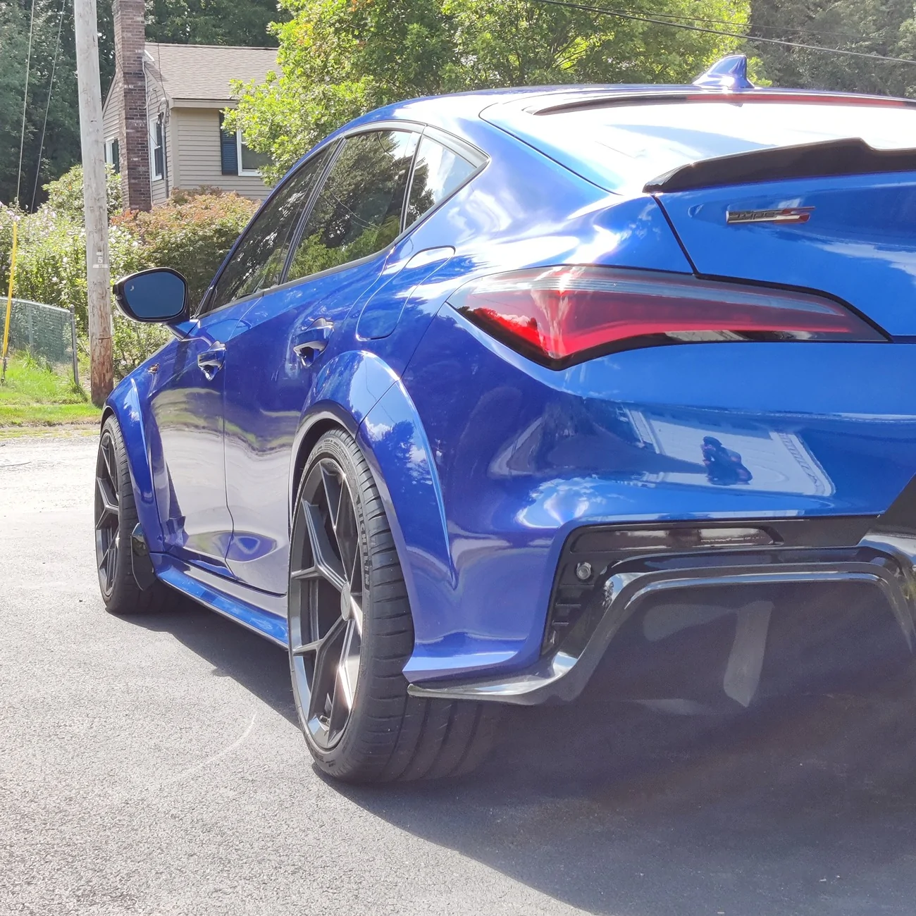

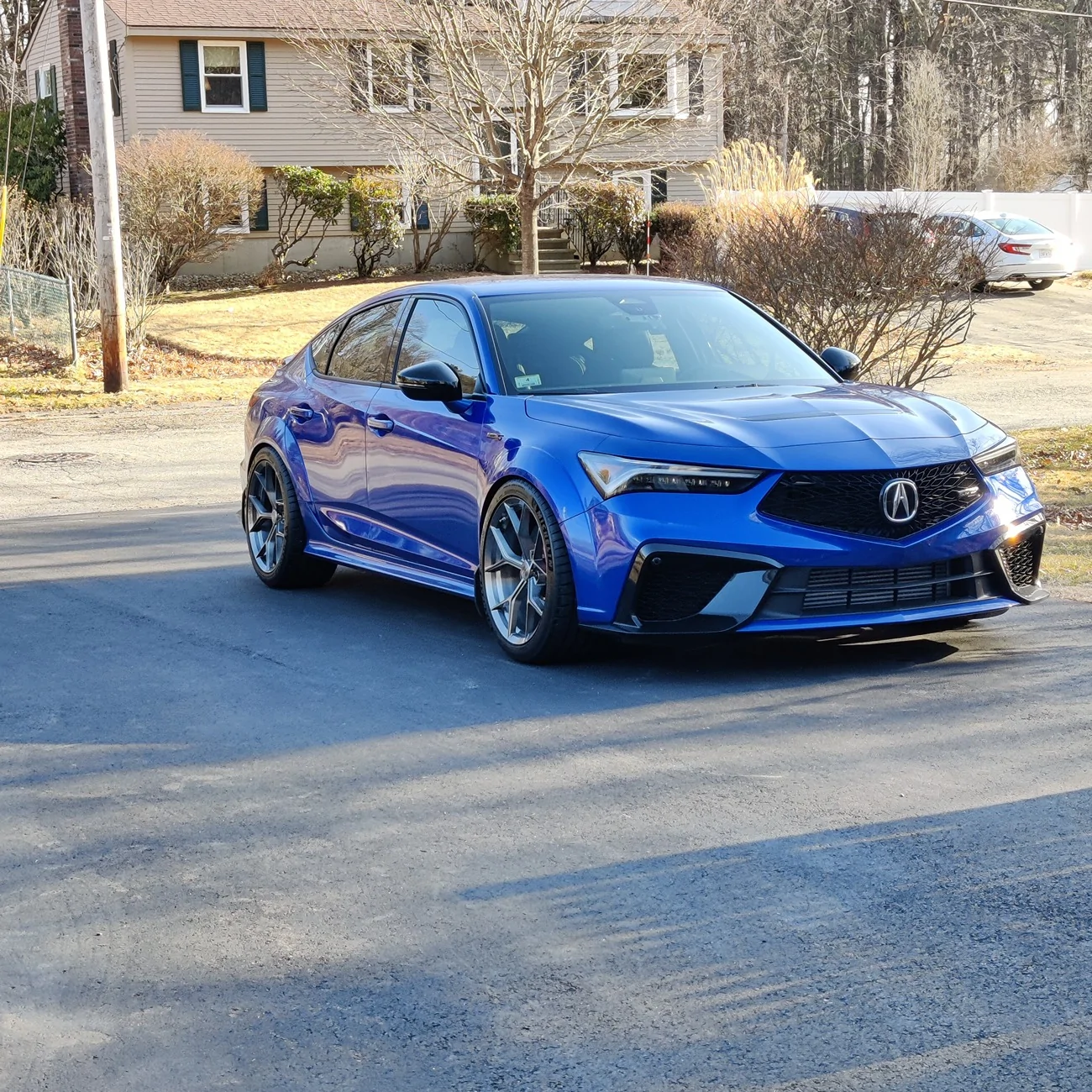

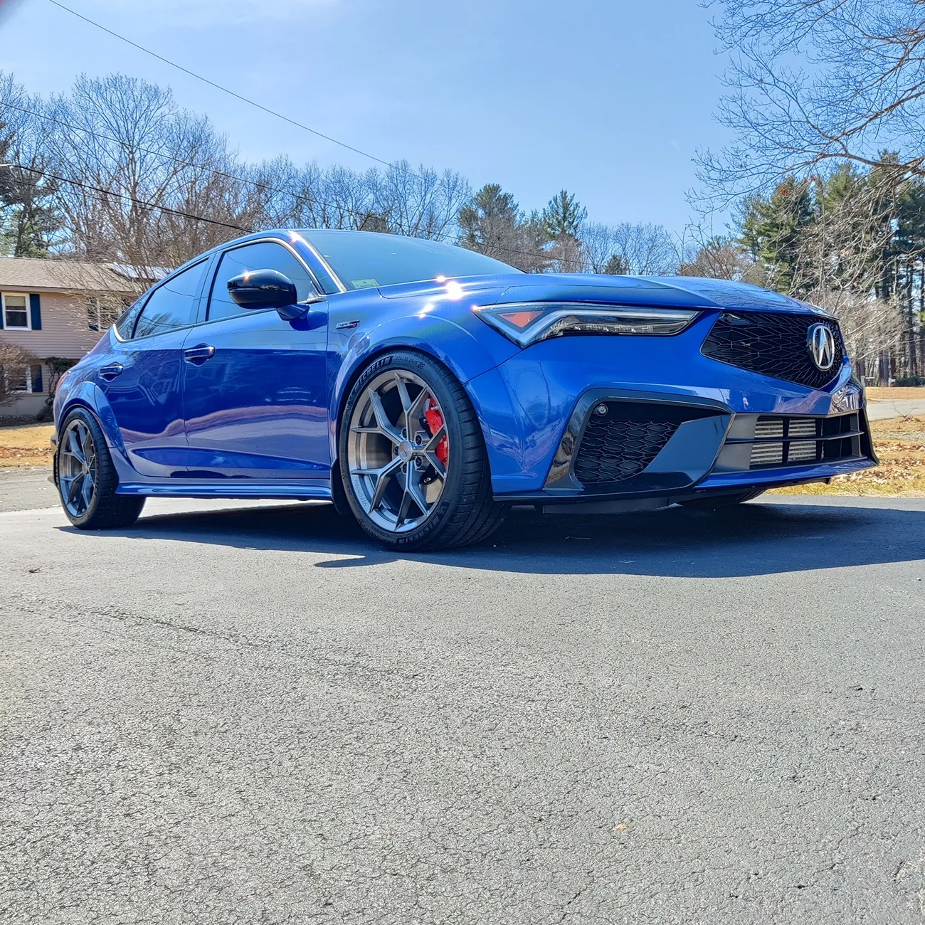

Very valid concerns, I initially had the similar concerns but I took the plunge anyway, because YOLO. I know our region isn't known for glass-smooth roads but overall I haven't had many issues and generally avoid steep inclines and steep parking lot entrances.
I did run a 275/35 initially (pictures below) but ran into some slight issues with rubbing. I feel that a 37 to 40 offset would have worked out great though, if sticking with 9.5" wide. Admittedly, I found that a 35 profile was a bit too dull for my tastes in terms of sharpness and response. Nothing major but just enough. I've been on 275/30 ever since and haven't looked back. So now I have practically brand new tires sitting in my shed. It might be time for us to have another meet over a couple of brews!
I believe @lumper runs a 25mm spacer setup on stock height, stock wheels and a 275/35 tire with no issues. @lumper would you have some pictures you could share?
Also, yes you can correct the speedometer reading with Hondata.
