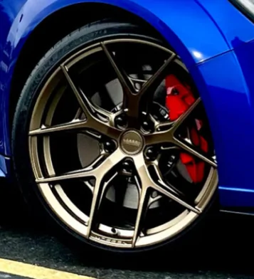

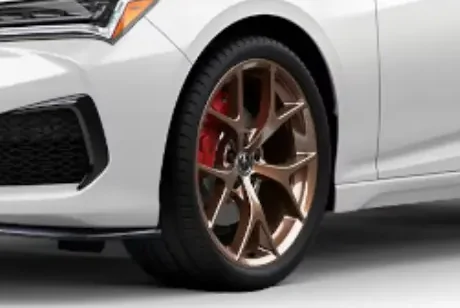

I realize the look is very similar to the ones that come standard on the ITS, but they seem a bit cleaner and closer to the look of the Apex VS5RS.

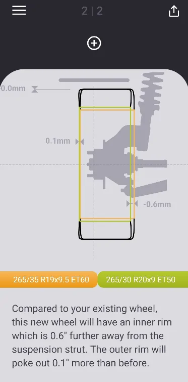

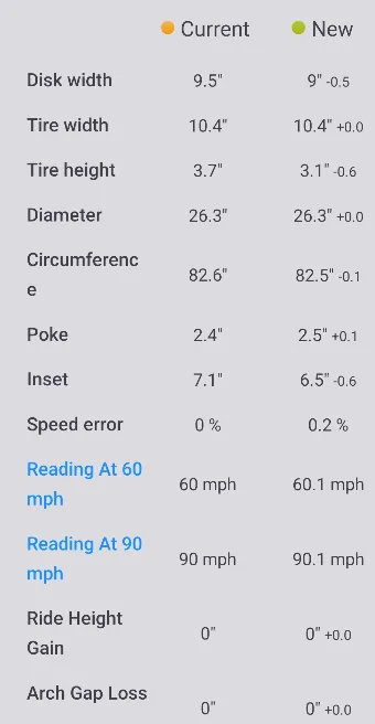

Ok, I appreciate the help & feedback! For the record, this was what I ended up using to get the numbers I calculated:

Ah, I see in the pic that you are comparing to a 265/35-19. The stock tire for the ITS is 265/30-19.
