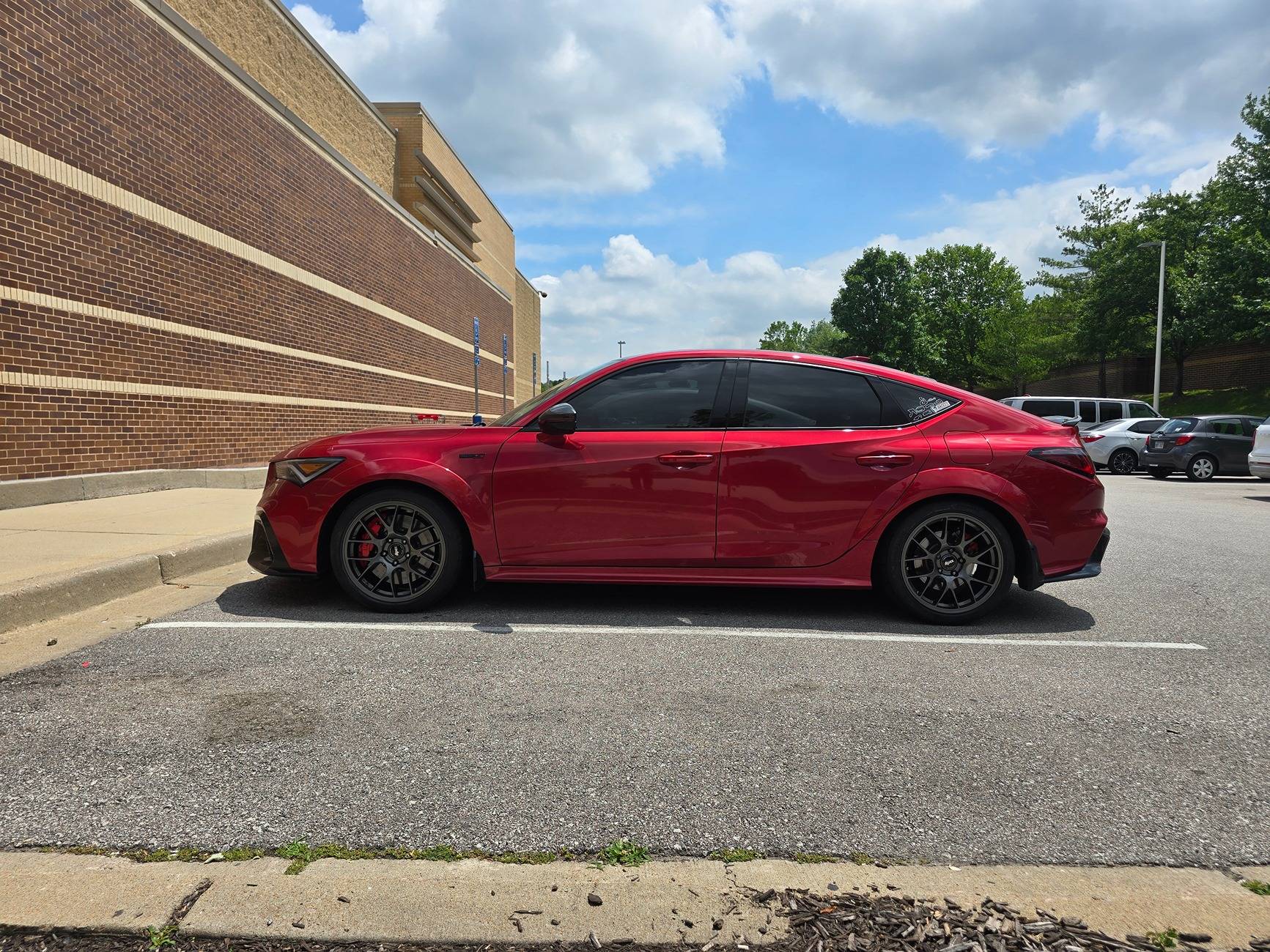

Here's a photo of 18s with a proper 200tw tire.
Acura Integra 18's vs 19's 20250606_121159
