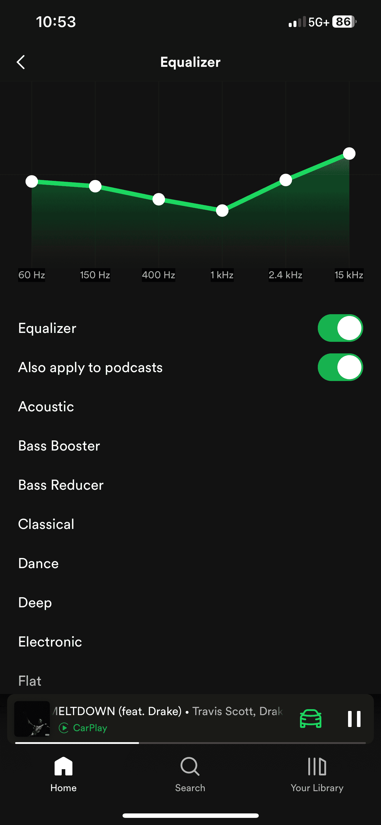

You have to set the EQ manually in Spotify those other settings don’t do it justice here is a picture of my Spotify settings and I listen to everything from rock to rap to heavy metal.

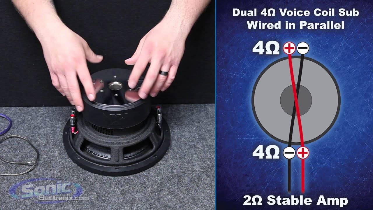

Also make sure your wiring is correct on the sub and that you bought the 4 ohm sub, so a dual coil 4 ohm sub wired like in this picture will give you the required 2 ohm load. If the sub is wired wrong it won't output the sound correctly.

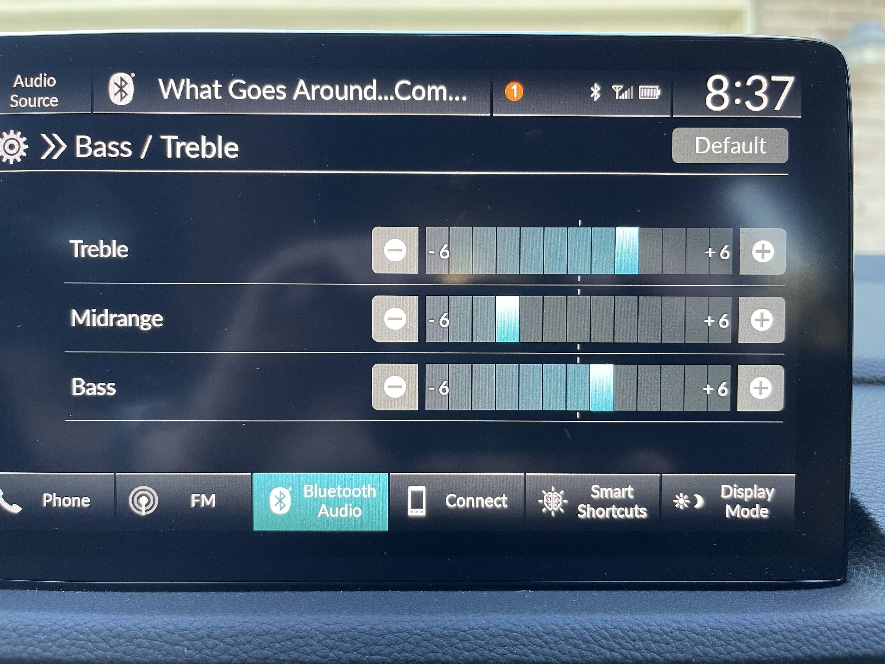

Yup I noticed the leads needed to be crossed and I’m pretty sure I copied your eq pretty well
