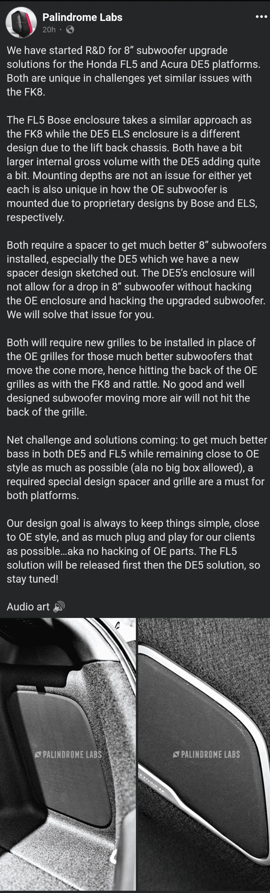

Any update? It looks like Palindrome will be supporting us. But their FK8 solution was $$

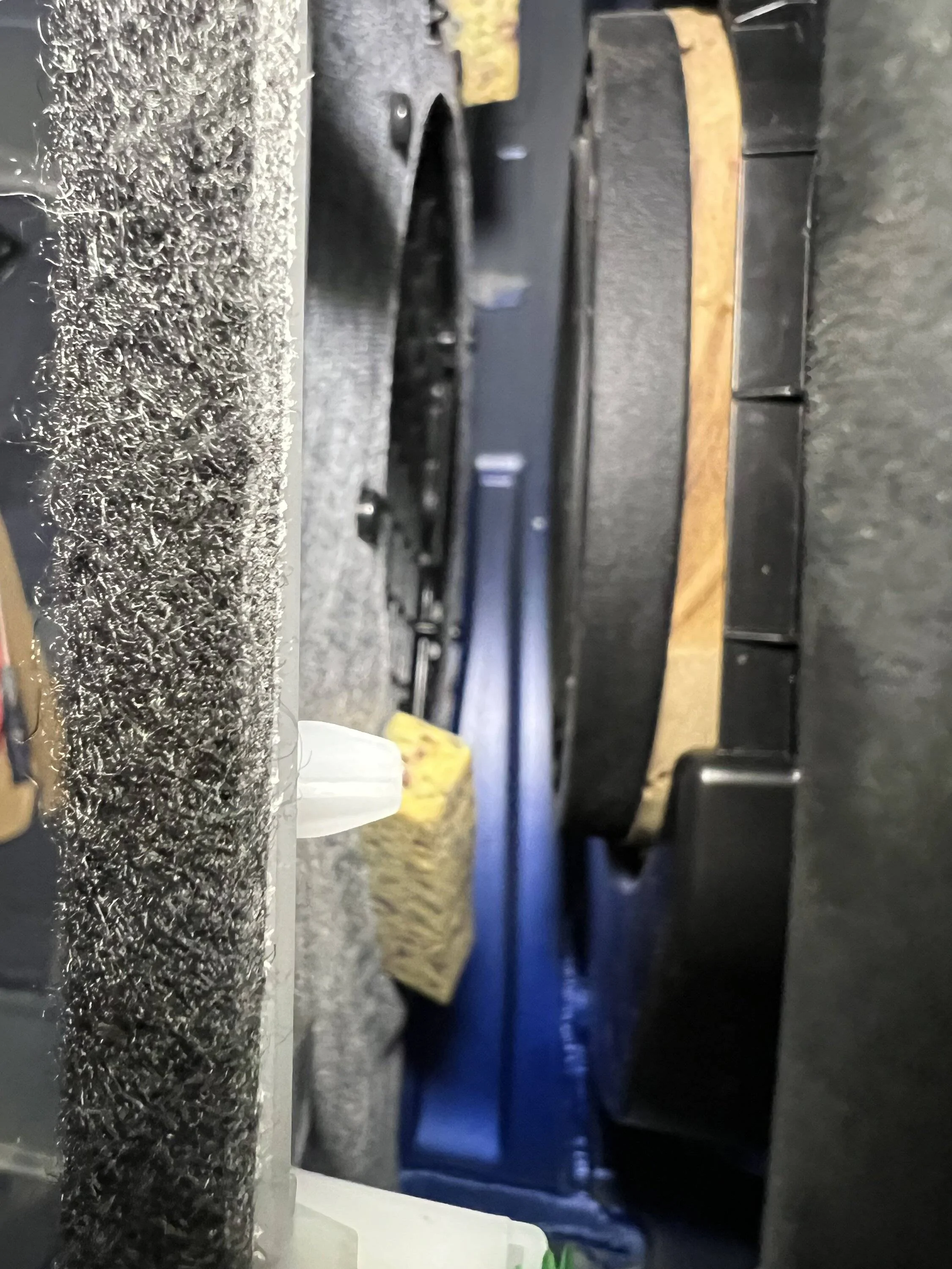

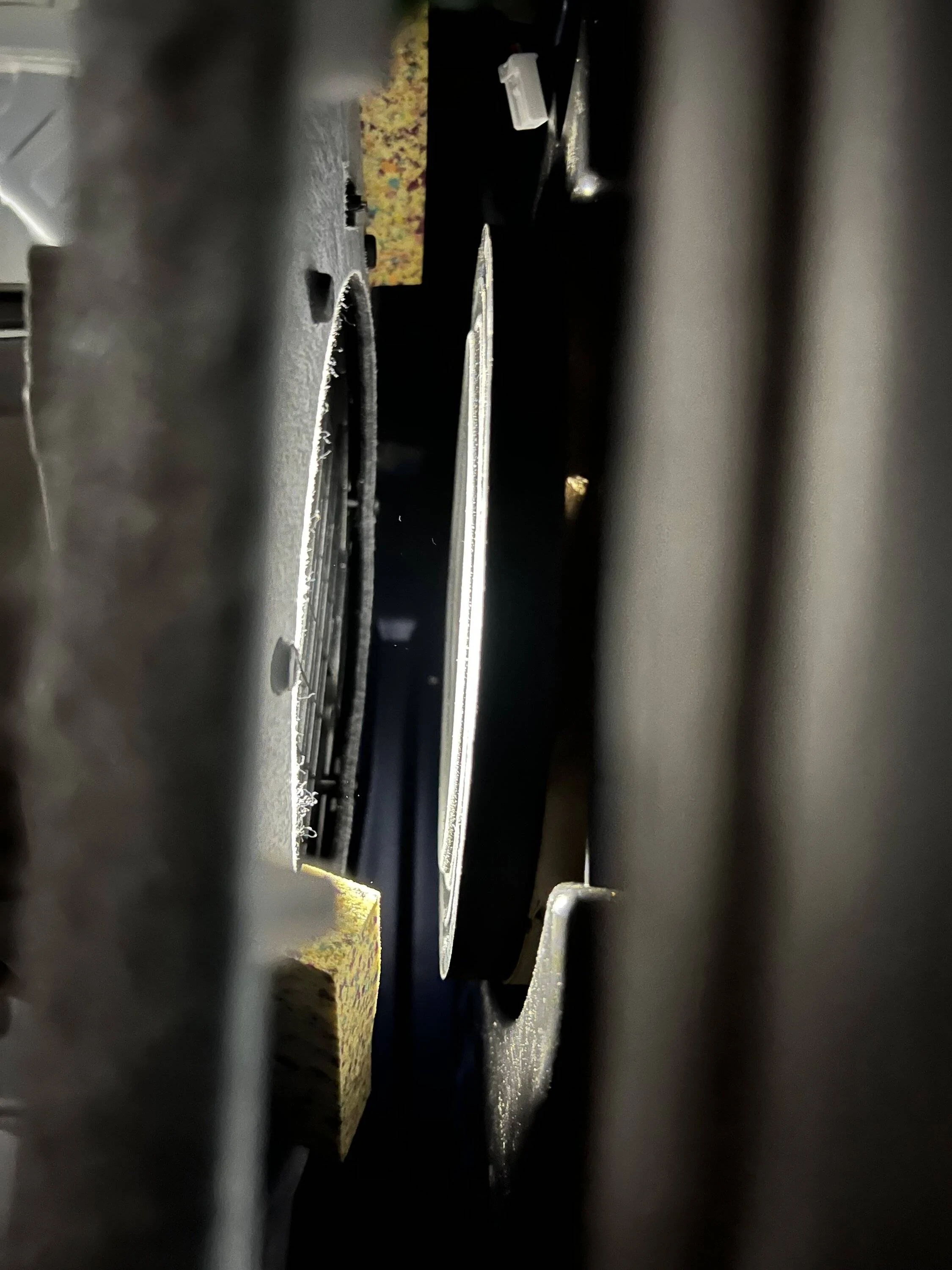

Just to add unless your sub is doing some really impressive excursion. I don’t believe a kit would be needed. See some pics to show the spacing. With the sub being powered by an amp, I don’t get any rattle from the sub hitting the grill.

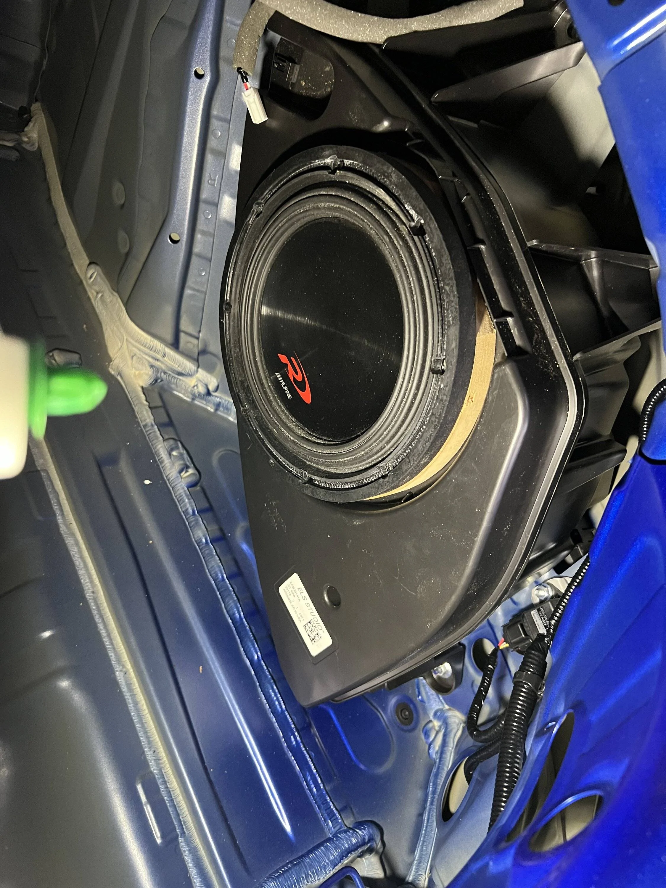

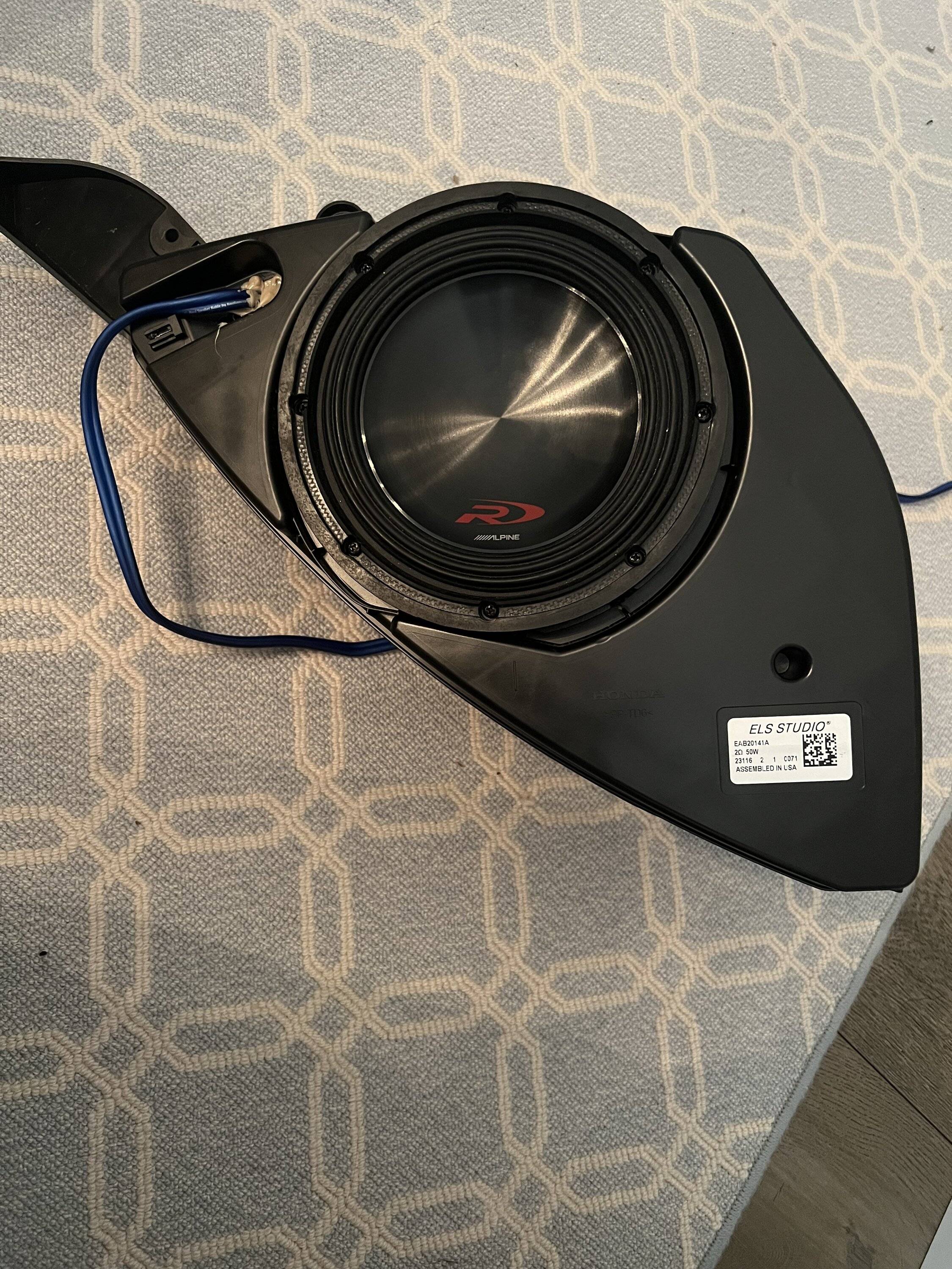

So, update. I’m still waiting on some stuff to clean up my amp install, but I was able to fit alpine type-r with a spacer. I used a wood spacer with the sides cut down and mounted the sub on top.
