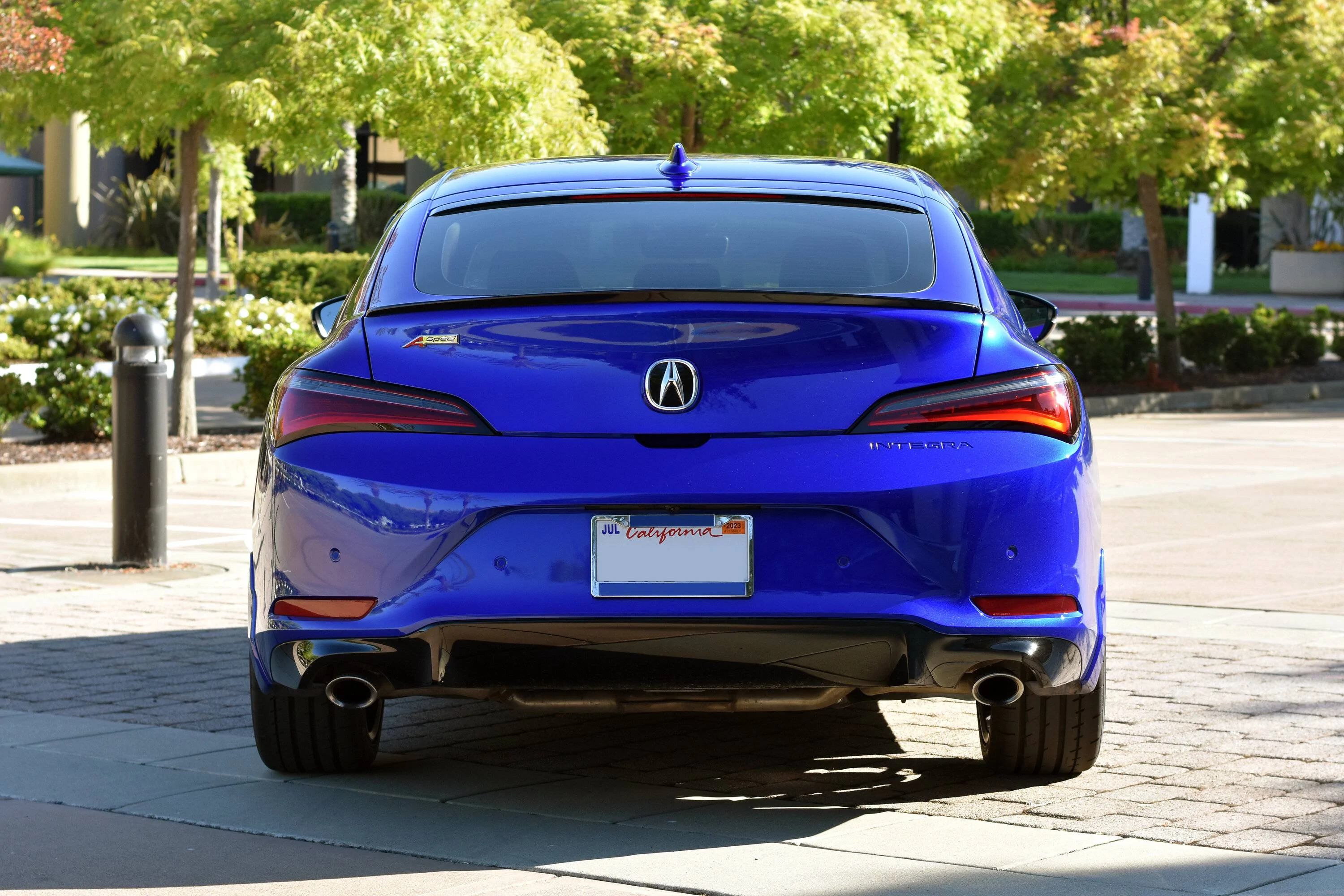

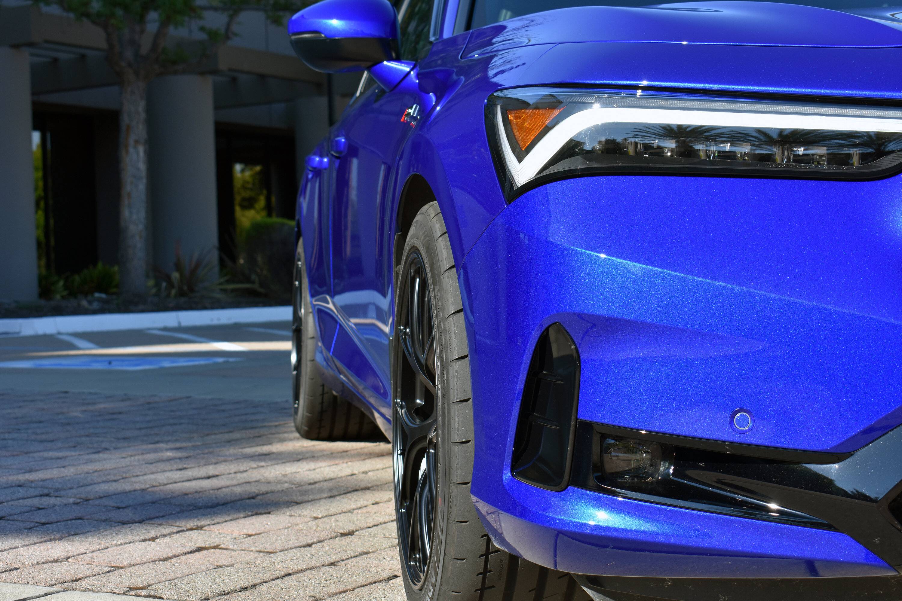

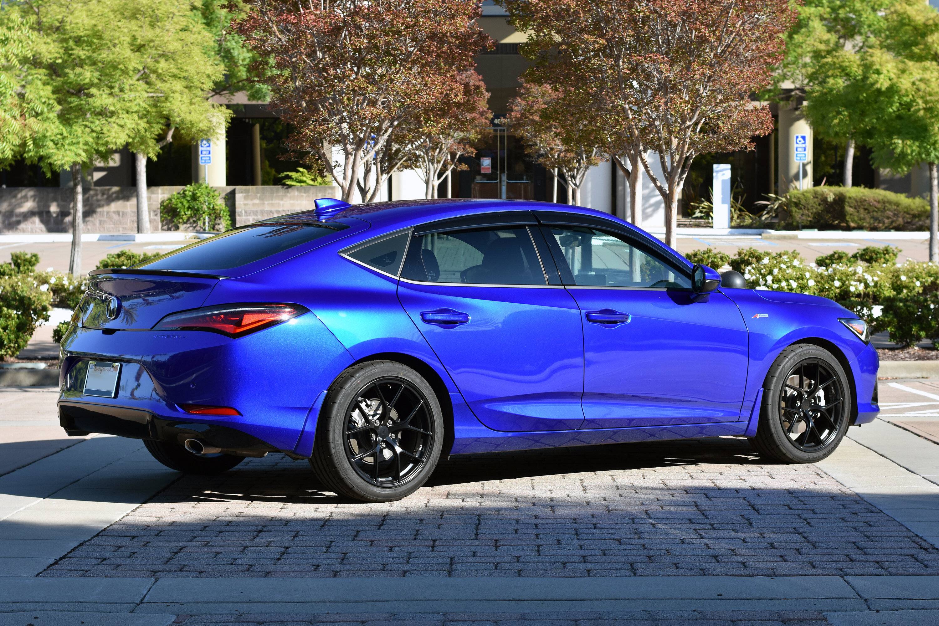

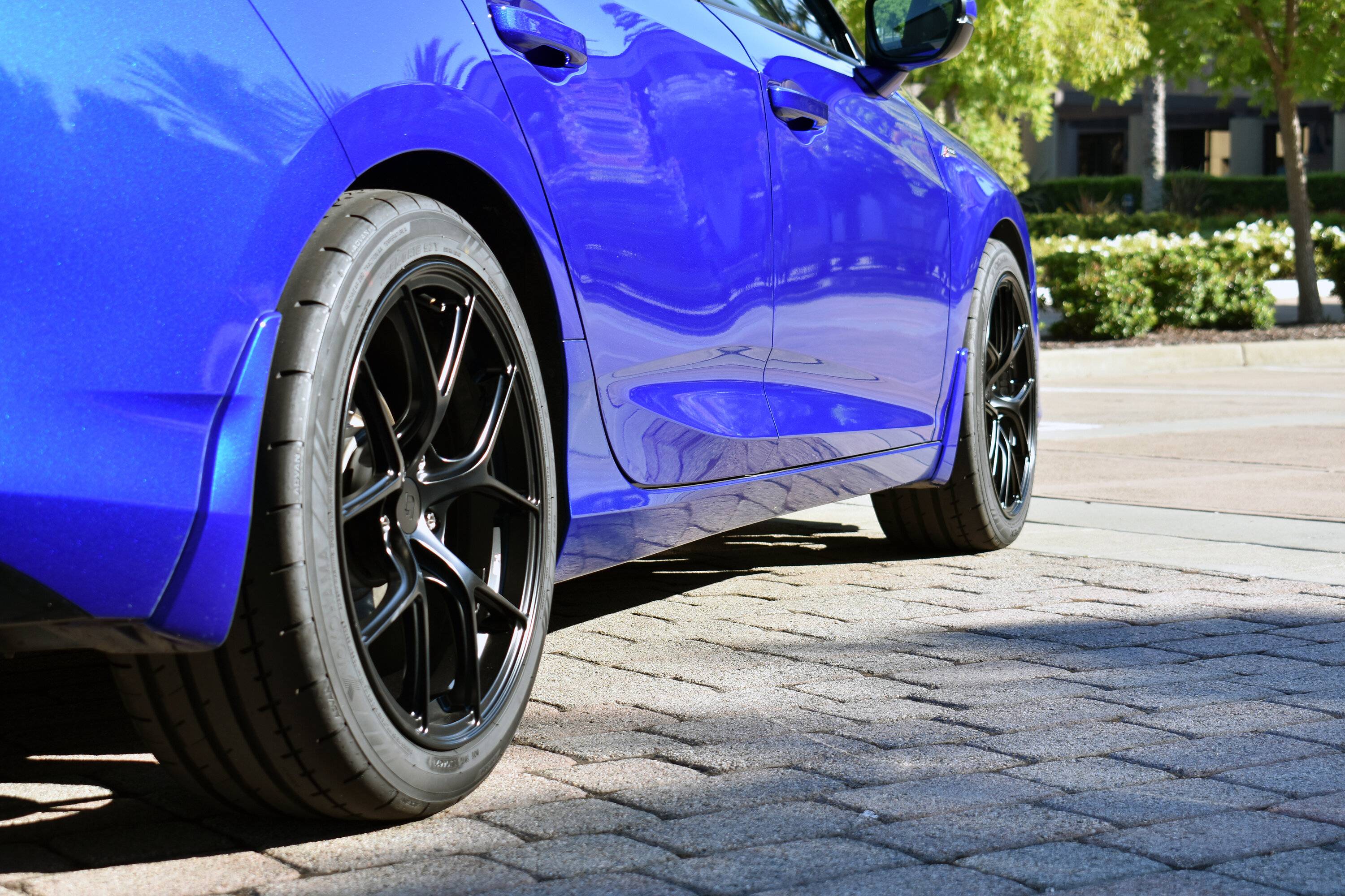

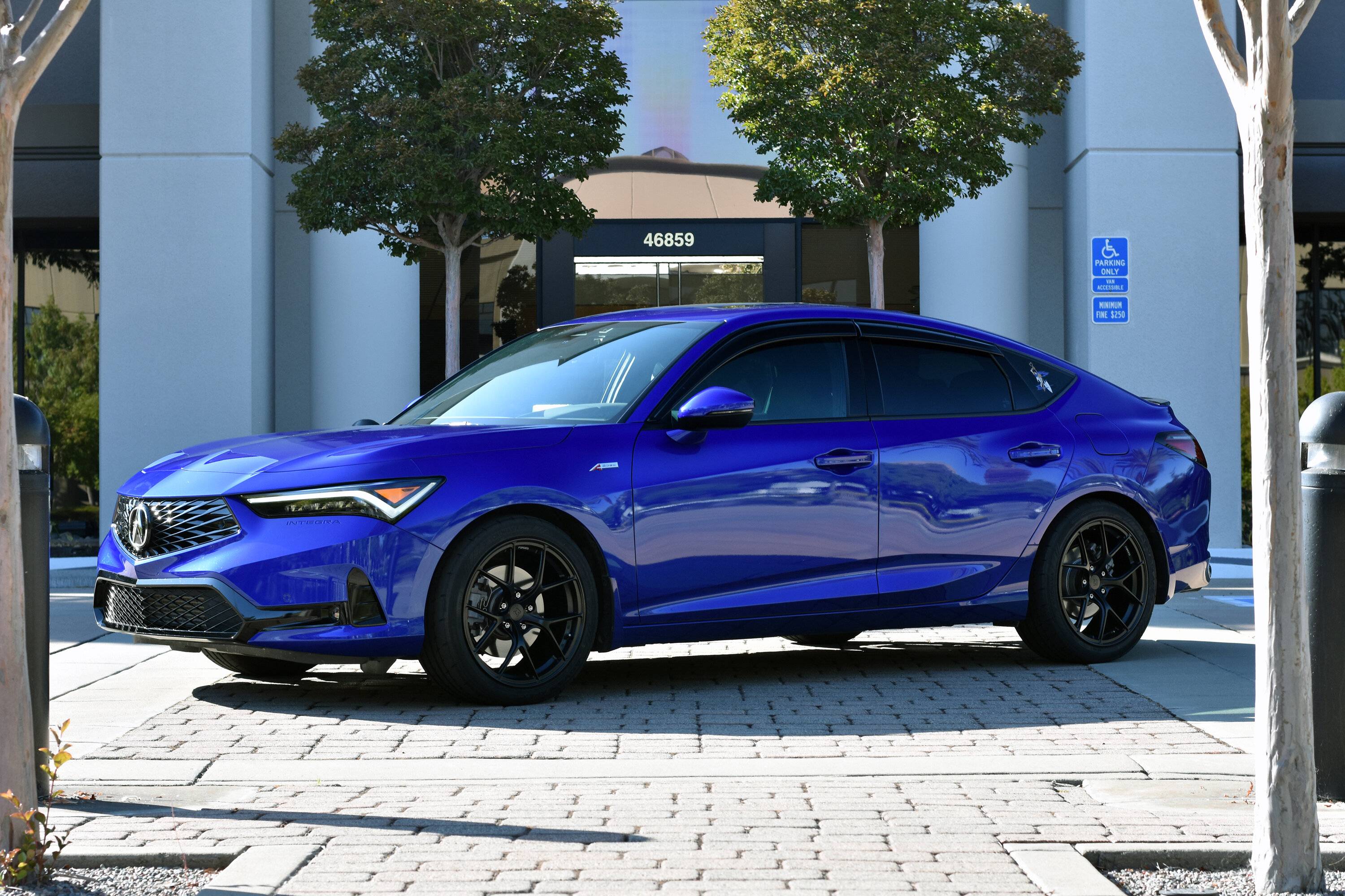

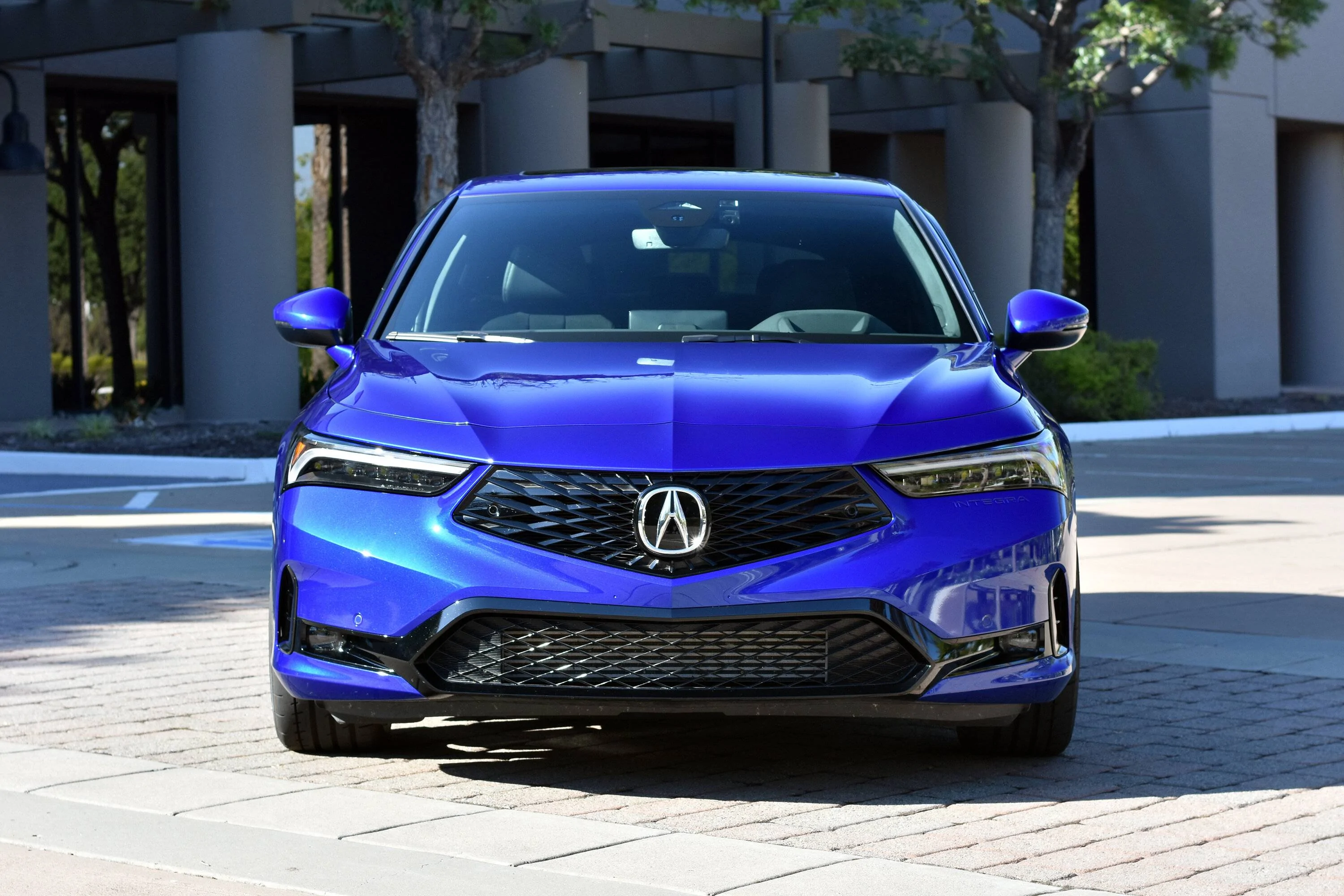

Just put on new wheels on my Integra this weekend :)
- Titan7 T-S5 in 18x8.5 +35, Machine Black
- Yokohama Advan V601 in 245/40R18
- Stock suspension
I measured the OEM wheel+tire at 52.5 lbs. The T-S5 with the V601 was 45.7 lbs. Total weight savings is 27.2 lbs all around, which is nice!
The Yokohamas are noticeably louder than the OEM Continentals, which is expected since it's a 10mm wider summer tire. Will probably switch to UHP all seasons when they wear out. On the other hand, tire grip is substantially improved, you can carry more speed during hard cornering.
+44 offset would have been perfect in my opinion, but +35 looks good. Front end is flush at the top of the fender, rear is slightly tucked. Plenty of room for a BBK.

Very nice combo. So you're saying that 18x8.5 +44 would be perfect? Are your wheels sticking out too much since the fronts are flush with the top of the fender.
+44 would bring these closer to OEM spec (18x8 +50). With +35, there is ~9mm more clearance inside the wheel well, and the wheel sticks out ~21mm more. With +44, the inside clearance would be the same, and the wheel would stick out ~12mm.
+35 is fine appearance-wise, it doesn't poke out. I'm also running 10mm wider tires and stock suspension, no rubbing or anything.
FYI the back end of the car's body is wider than the front, so these wheels are flush up front and almost flush in the back.
