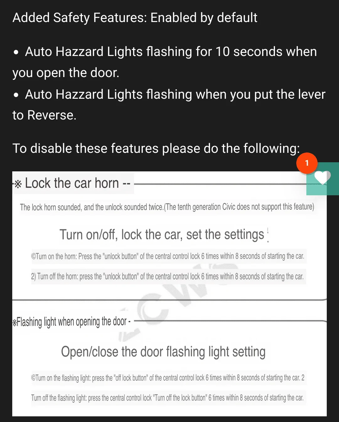

Instructions to disable the modules "safety" beeps
Acura Integra Auto Folding Mirrors installed Screenshot_20240315-203443
