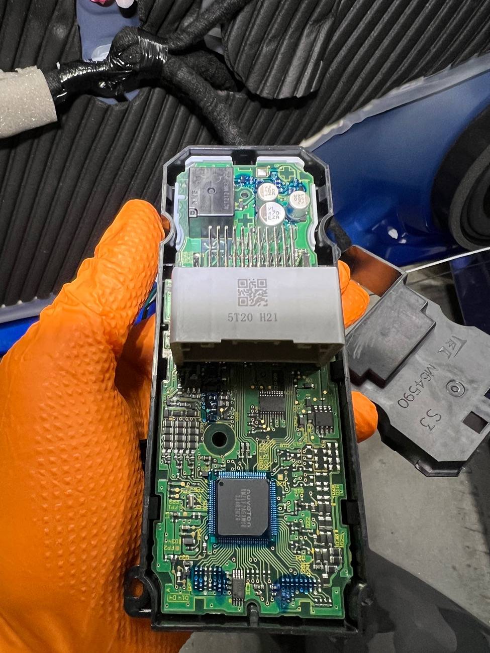

I am still trying to track down the folding issue, and I've taken a look at the window switch to check for the folding chip. It does have a chip, but it looks a bit different from what I found online. Has anyone encountered something like this before? Thanks for your help!
Is this the switch module from the the kit or the original with the car?
The switch in the picture above is from the kit, and I just finished installing the passenger side. Everything is working great, so it looks like both sides need to be in for the mirrors to function. What a relief!
Now I just have the puddle lights and illuminated door sills left to install. Exciting!
