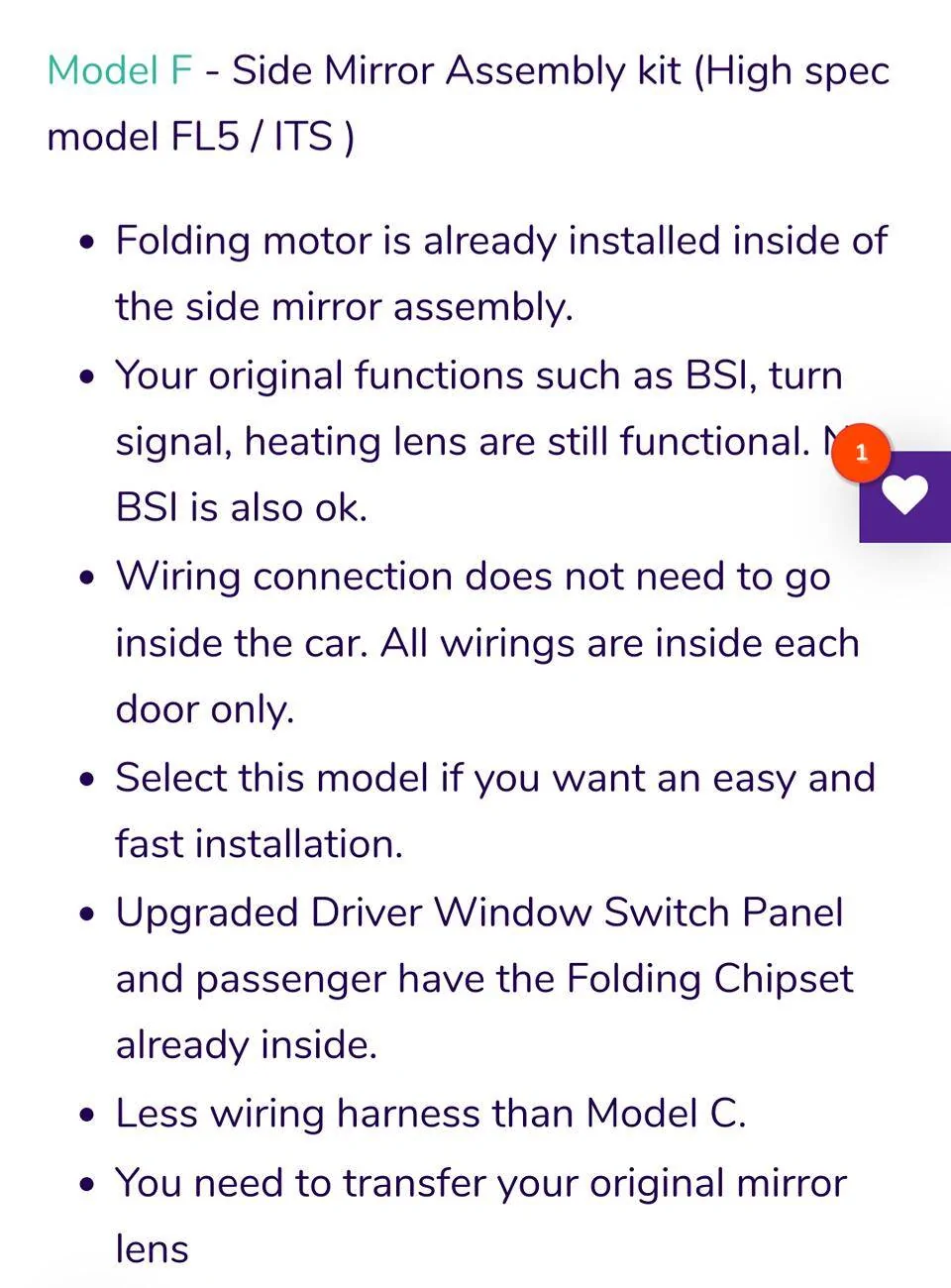

Was just looking at Mikstore for the C/F kit and looks like they changed up their folding mirror kits to cheap kits without CAN integration and the window switch assembly panel. Wiring connects from driver side to passenger side now and they just provide the mirror switch with folding button 👎🏽👎🏽👎🏽
Oh well, if I was planning to do this should've bought the kit sooner.

That's not true. Kit C includes the wire that connects both sides but is not needed with our cars. Kit F excludes this extra wire.
You're correct, my dumbass was looking at the wrong product on their site.
