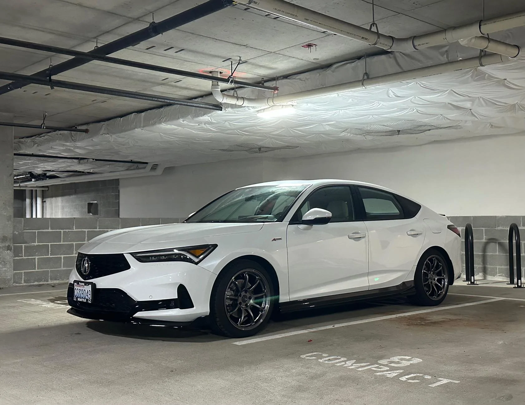

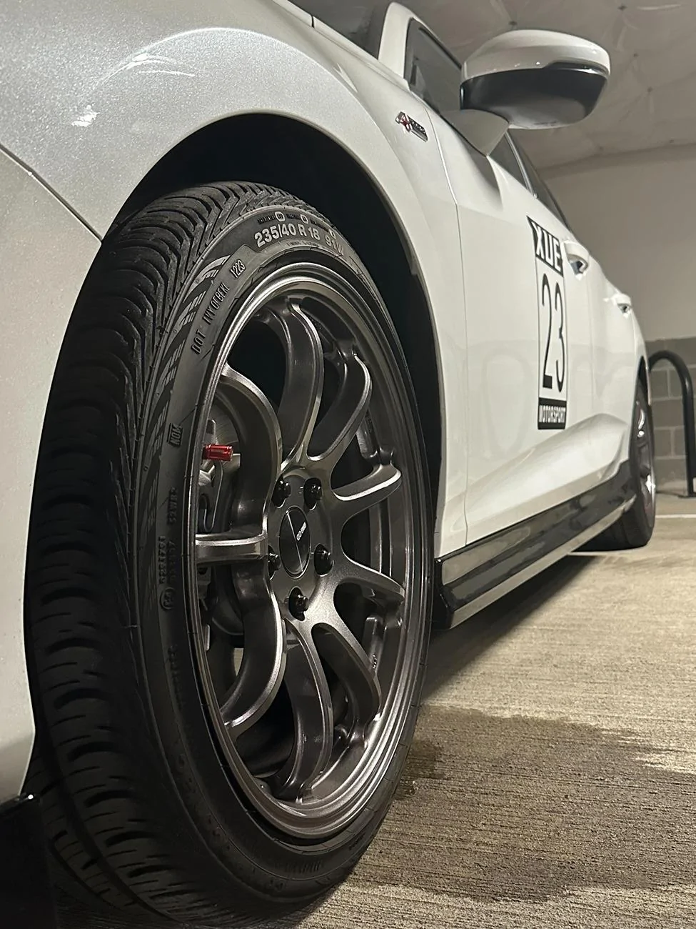

I got them from a guy locally - he bought the wheels brand new but did not clear his sti brakes. Sets were 1600$ on Ebay back in June. I was not specificallty looking for PF09, but I know they can be hard to get. You can also try 18x8/8.5/9, et 35-50. All the specs that falls between the range can fit.

Yeah I found 18x9 with 42mm offset. Thinking that might work, your car looks great! How does the front lip install? Do you have to drill into the factory front bumper?

18x9 with 42 will work, check the fitment on willtheyfit.com, it will tell u how much the wheel sticks outward than the OEM wheels. Then you can check if they rub or not, although it shouldn't if u dont plan to drop your car.
