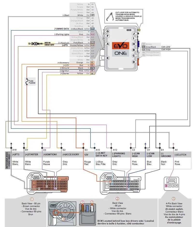

Can someone have access to the Type S wiring diagram and confirm that the wires colors from the base 2023 matches the 2024 Type S?
3,429
2,909

I will be following this. What about flashing the units firmware? This is something Fortin will still have to supply. I don't think the DE4 or 11th Gen civic firmware will work would it?
If wiring are the same I think it would work and it's something I'm willing to try soon... would like to have someone with the shop manual that confirm this...
