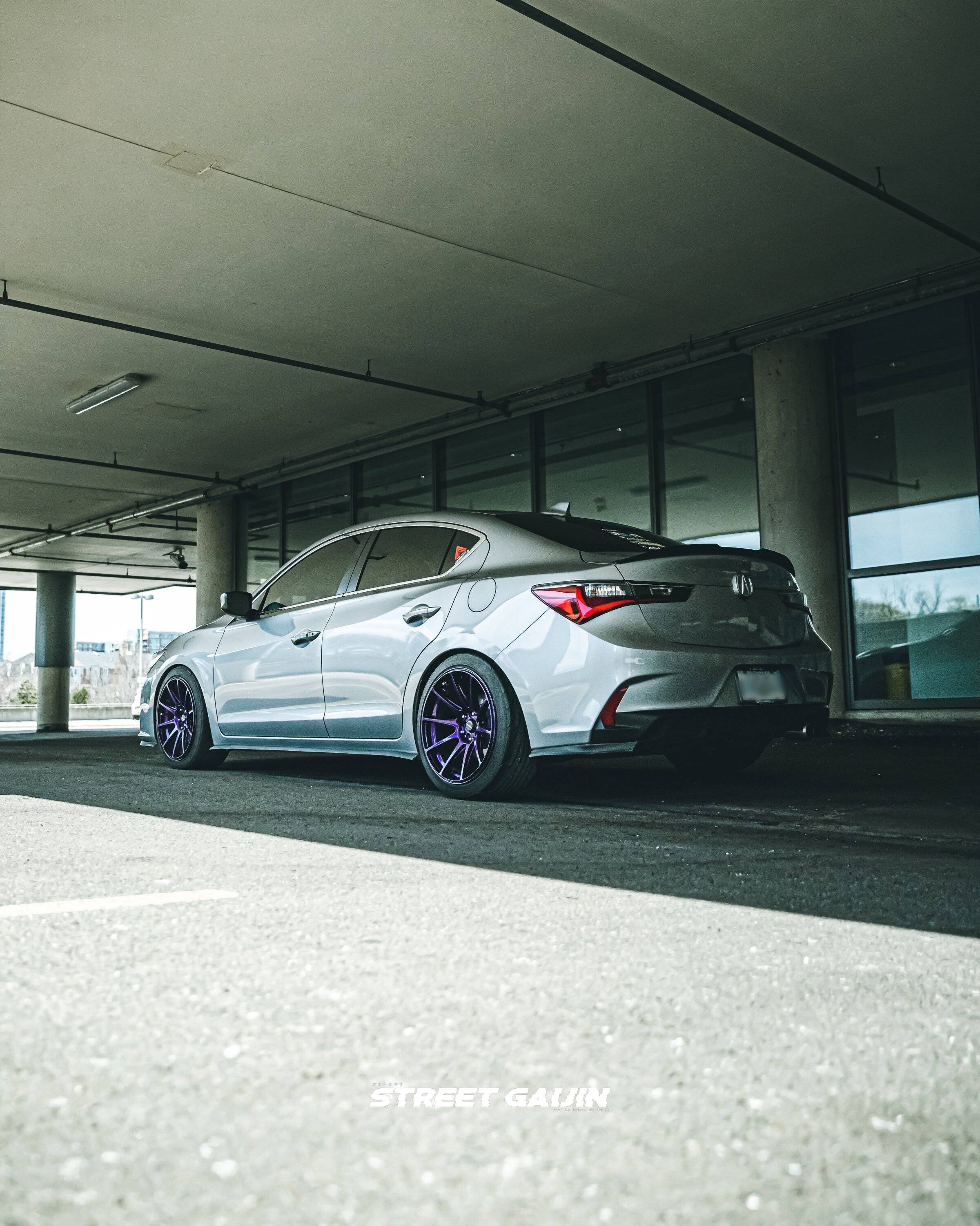

How are the springs working out so far? Should I pull the trigger and get these or wait for the official dedicated springs for the Integra?
Interested as well as I might use my ILX Eibach Prokit + rim setup for the rest of the summer
E10-201-001-01-22
1.3 in (Front) 1.5 in (Rear)
Judging from the weight of my 2019 ILX (3,122 lbs)
vs 2023 Integra (A Spec with Tech 3,073 lbs manual)
it should hold up fine
My Lunar Silver just got delivered yesterday 🙌
