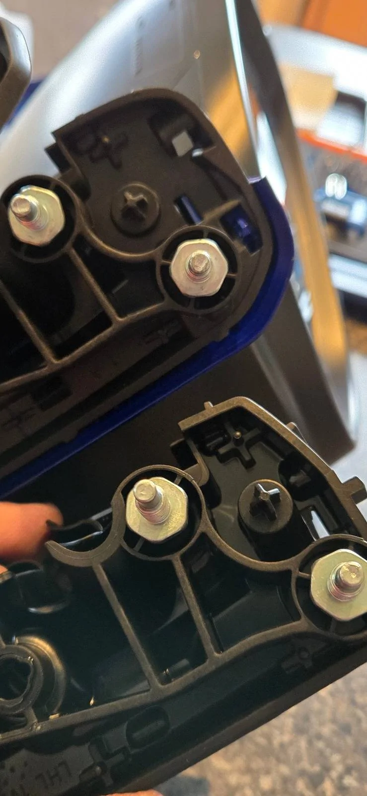

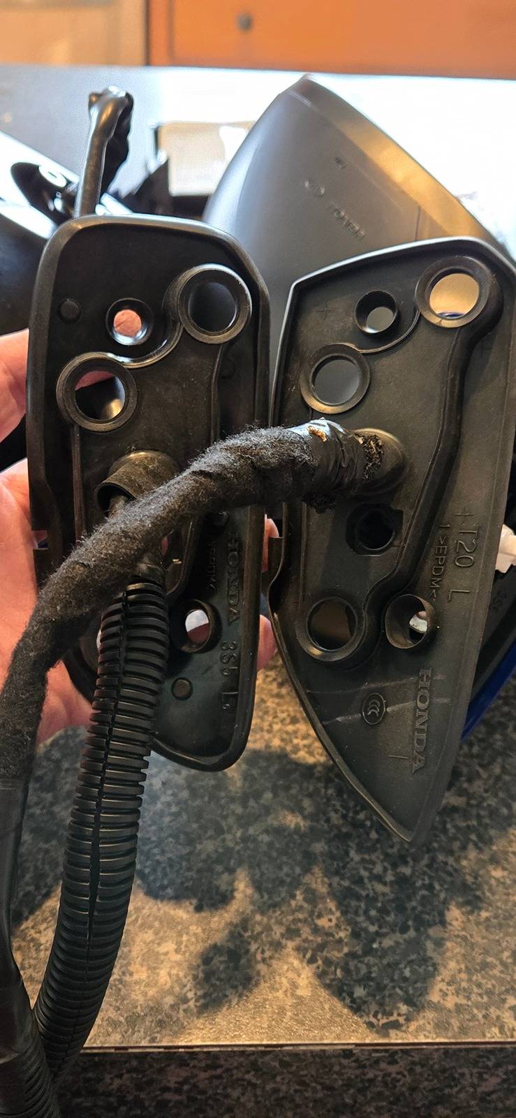

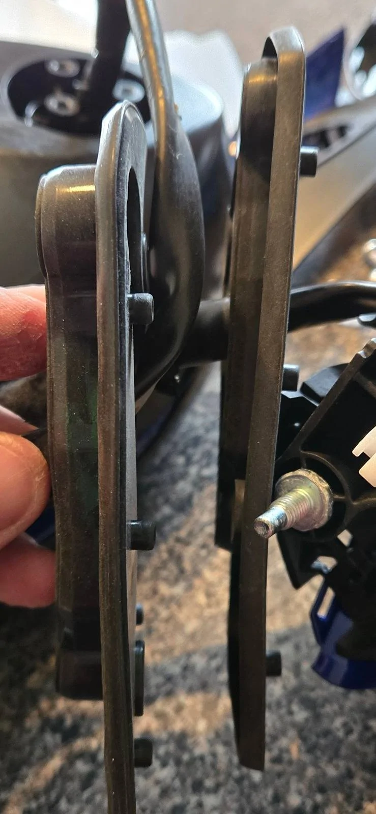

Just completed the install of the model F kit. I followed the Civic SI installation instructions and only the steps for the grey, black, and green wires. I decided to swap the entire base as it seemed like my original color matched Type-S base covers wouldn't fit. This was a bit of a hassle due to the need to de-pin/re-pin the connectors. Which I found went more smoothly inserting a thin, straightened out paper clip in the side of connector where the wire is inserted and then gently pulling the wire out, which also pulled out the paper clip along with it. The de-pinner included with the kit was hit or miss using it form the other side of the connector and couldn't be used on the wire side. Here area few pictures of the differences between the bases, my original is on the left in each image.

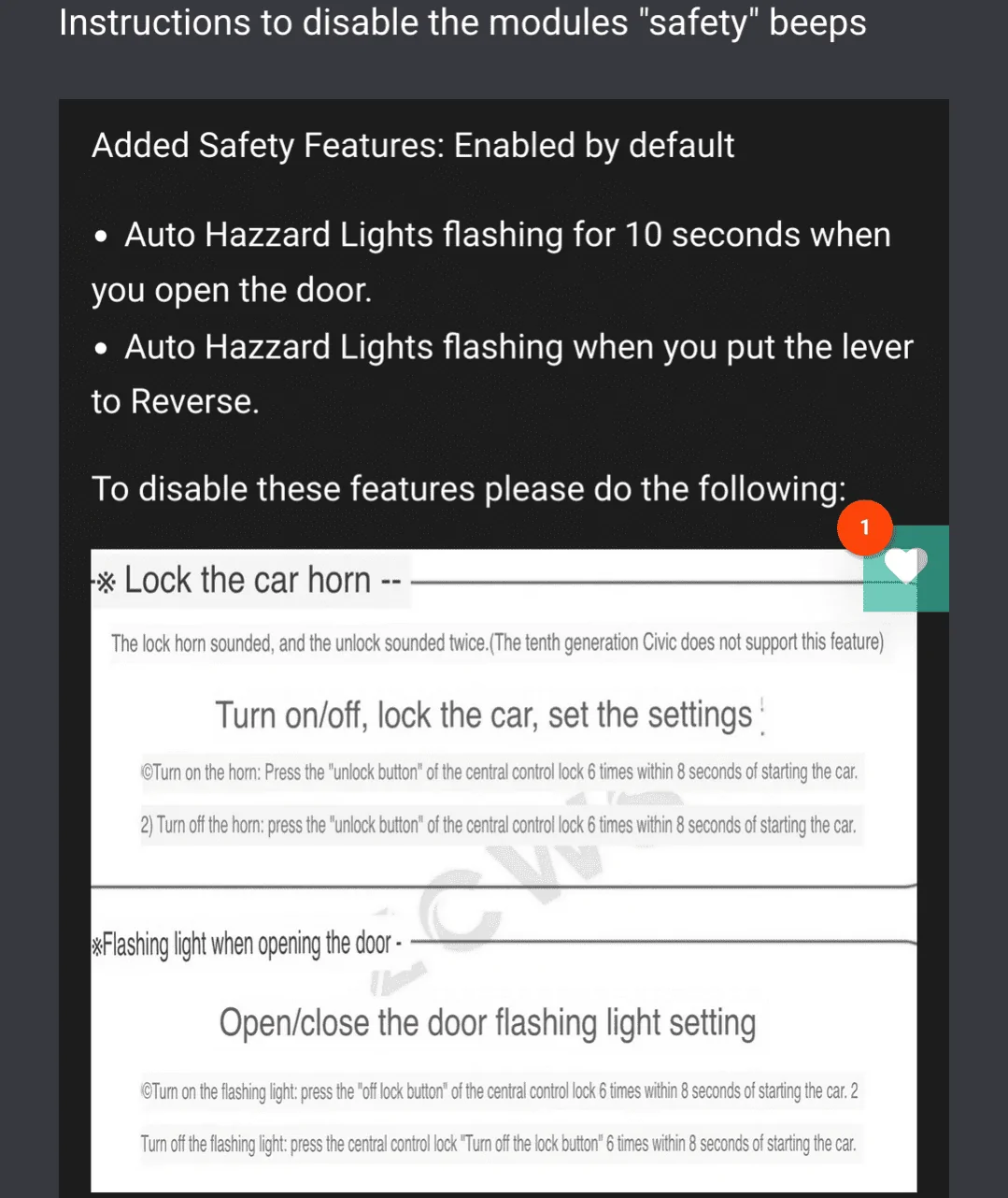

Instructions to disable the modules "safety" beeps
