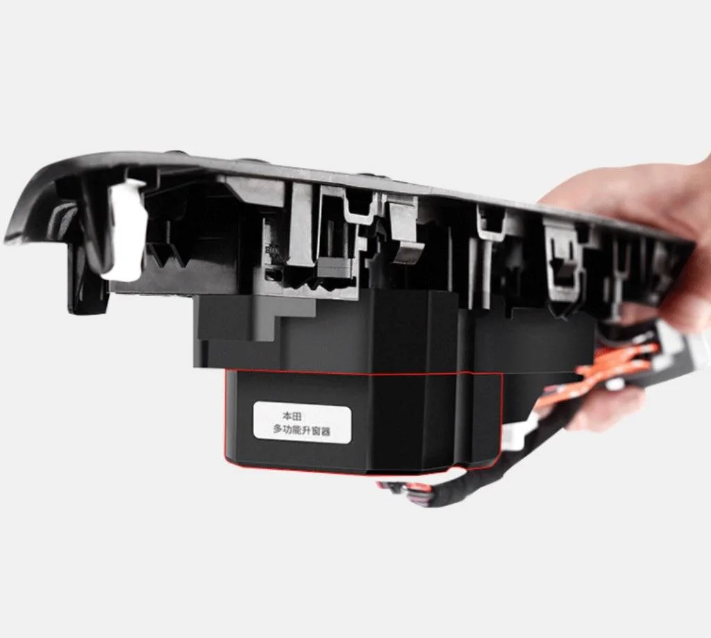

You could be right. I also wanted the "hold lock to roll up windows" feature, so I got the module. I'm not certain if the auto-folding on lock would work without the module though.

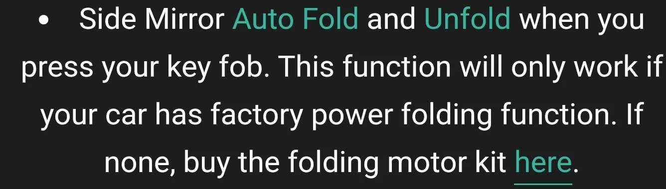

So, without buying the additional can-bus adapter it would only fold with the switch?
I thought since it integrated with the dash even showing an option that the chip set on the new windows switch would fold them automatically without any additional hardware.
The canbus is needed as stated on their website to auto fold when locking

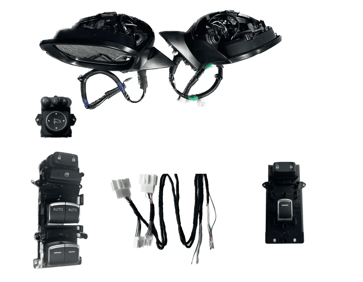

The kit I used was from the MikStore Model C.
No wires need to be ran between drivers and passenger doors.
This kit comes prebuilt and ready to install minus mirror covers.
This is originally for a civic and our Integra mirror base that secured to the car is a bit different, it also is painted to match the car vs civic black plastic.
I at first was hoping to switch over the mounts plastic trim but it wasn't possible.
To switch the mount and rubber seal you have to depin the connector. Luckily the MIK kit comes with a pin extraction tool( a sewing needle would also work).
Once pins are remove you can swap the gasket material and plastic painted trim between your factory mirror and this folding setup. Take photos of the connector prior to removing pins so you can reinstall.
To remove door panels pull window switch controls, screwdriver and plastic pry bar is needed. Once removed a single screw is exposed that secures the panel. Remove this and pull door panel to release the snaps that hold it on to the door.
Now the new wiring portion. The MIK kit comes with 3 wires for the driver side(Green, White/Silver, Black). All 3 connect to window switch connector. The MIK documentation does a good job showing this. One thing not mentioned is on this connector before you add the pins pull out a locking tab on the front. This allows the pins to easily slide in. I didn't see this at first and had a difficult time getting pins in.
The other side of two of these wires (white/silver, black) go to the mirror connector for folding power. The green wire goes to the mirror switch connector.
For the mirror removal/installation lower window all the way down. There 3 bolts that secure the mirror on the top of the door panel that need to be removed. Prior to removing them discconect the existing mirror harness and unsecure it from the door. Note( pay attention to the mirror harness routing and how it goes around the window track)
This is also a good time to pry off the factory mirror cap. If you push the mirror glass all the way down you can expose two clips behind the glass. Painted clips that match the cover are exposed way in the top back. Taking two screwdrivers you can depress these. If you don't have enough access remove the mirror glass first. Once depressed slide the cap out. I grabbed it where the blinker is and pried up and out.
Now remove all 3 bolts and pull the mirror and harness out.
Same procedure for passenger side but this side only needs 2 wires to be ran. The wires connecto to the windows switch and go to the mirror connector for powering the folding motor(white/silver, Black).
Kit Model C

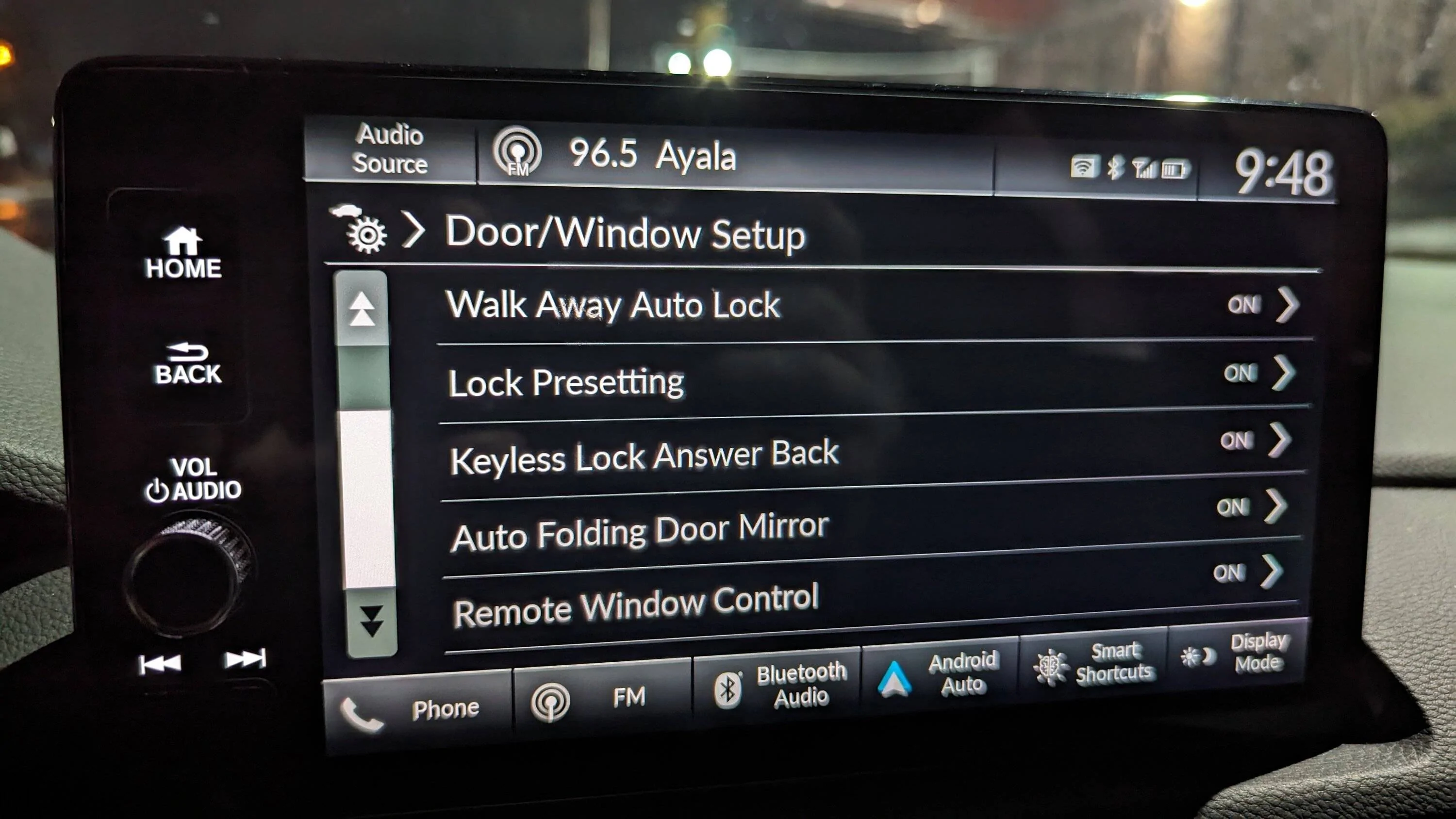

The menu option is now available to disable the powered mirrors in the vehicle setup menu. Image below.
