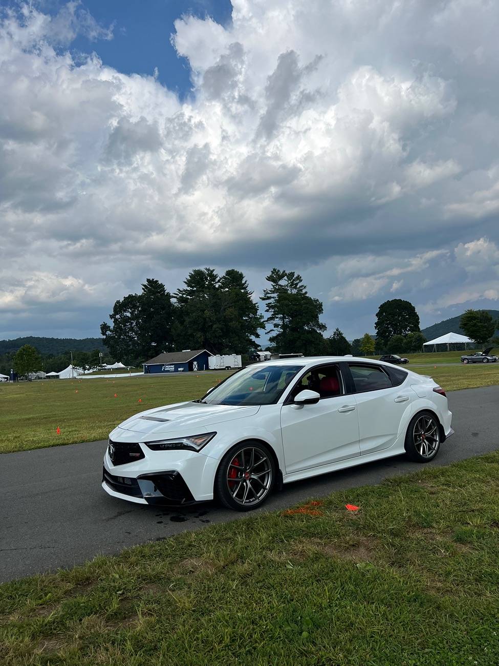

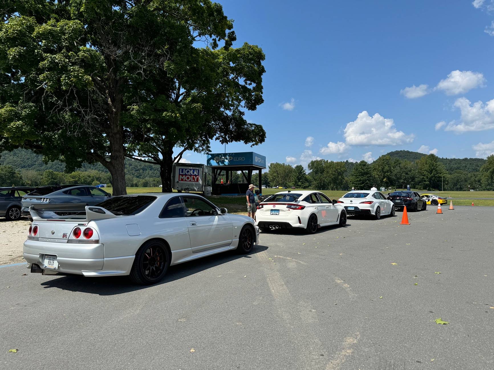

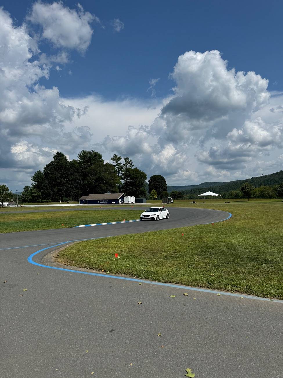

Did my first HPDE and track driving ever this Monday. Learned so much about the car and driving in general. Already planning another.
Apologies for the wind noise and shaky camera. Gopro was freezing and Staff moved the day along really quickly so we had a ton of time on track and I did not have the time to set up proper mics.
My best run of the day was a 48.860 during the 10-minute heats where I seemed to get into a better rhythm. They did a solo timed stint at the end where I managed a 49.59. My buddy in front of me in the Black FL5 ran a 47.98.
Looks like a fantastic day and GOT DAM that R33 GTR!
We jokingly gave him a hard time given everyone in our group was driving a type r/s. That car is really sorted and has some time with Misha on the ring. He was in a 550 whp setting, which was impressive because the integra was more car than I was driver, so I can only imagine how that felt.
It is running a G30 900 and 800 wheel on full kill. He ran a 49.38.
For posterity:

I just love the R33 in particular. Gives me all kinds of 90s-era JDM goosebumps.
I figured his license plate implied a built engine (RB28).
You and me both- R33 is my favorite. And your assessment is correct it is a 2.8L.
