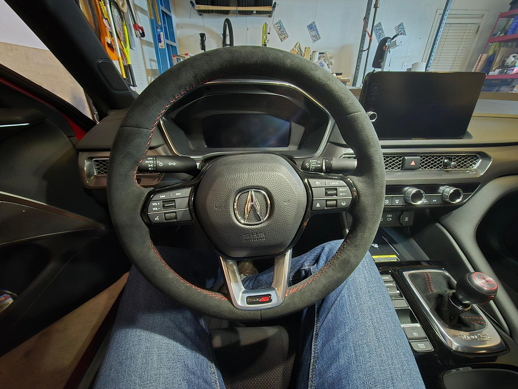

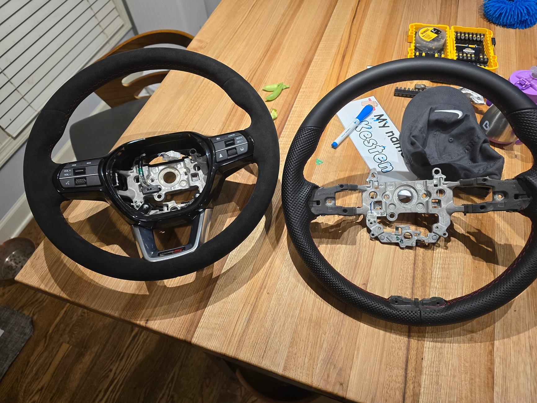

Got the Alcantara wheel on. The factory bolt was tightened down way beyond torque spec. I almost broke a 10mm Allen socket trying to get it out. I did break that same Allen head socket on the way in, but thankfully given my German car ownership history I have a ton of torx and triple square around, and it just so happens that all the corners of a 10mm Allen line up with the points of a t55 torx spline.
Super easy install, didn't even need to add felt tape coming back together.
If you plan to do this, I recommend marking off the wheel plastic back against the column plastic with blue tape and cutting it, that way you can align it to the same position later. There are three airbag release clips, one on each side and one off to the bottom left, and an Allen head is about the best thing to press it down with. A small flathead would slip around the springs a ton and be annoying.

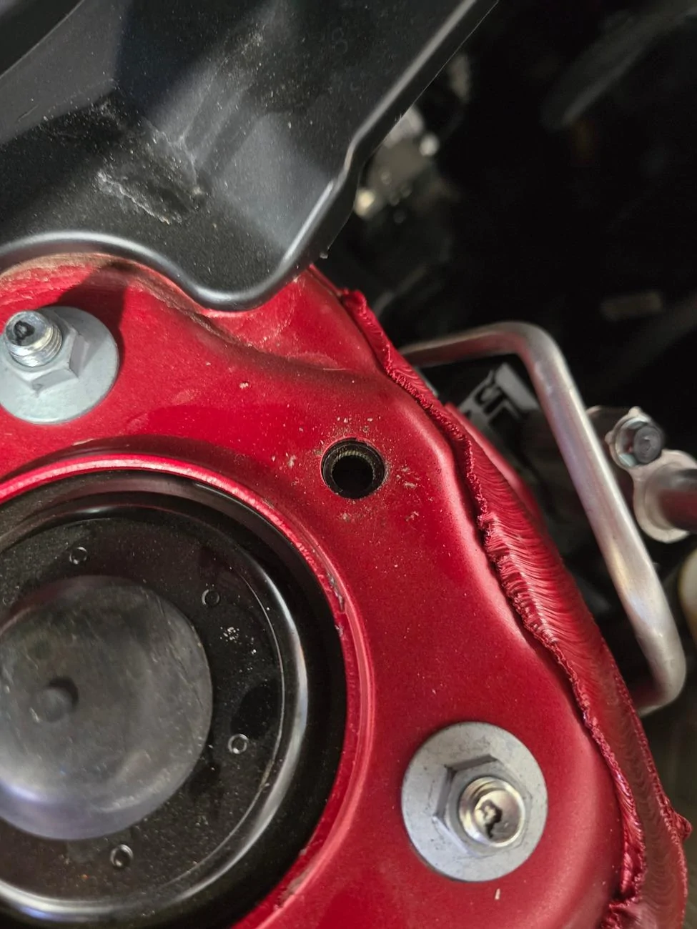

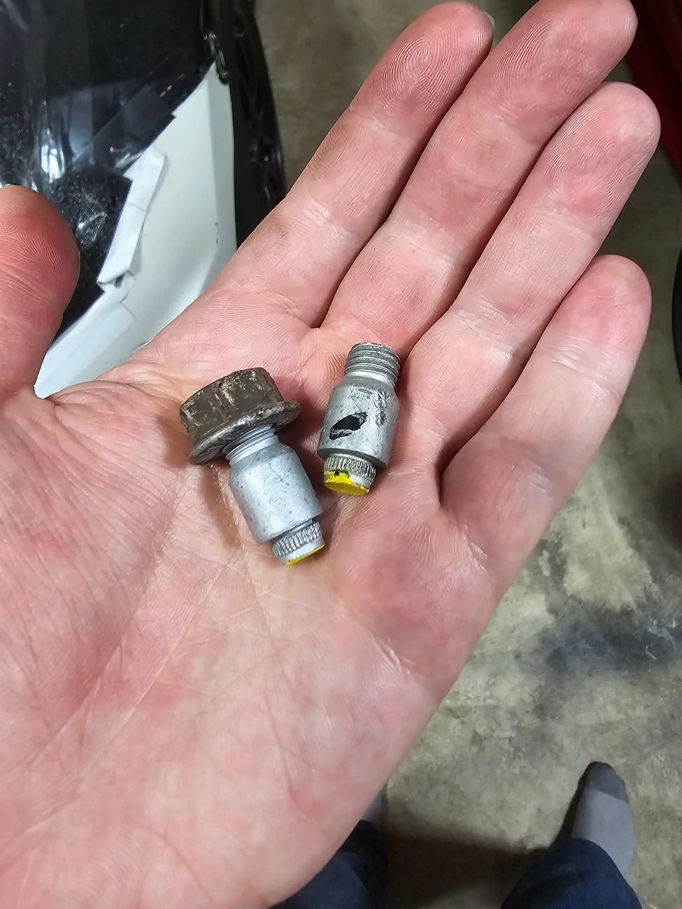

Well this was easy. Free camber. We'll see what it looks like when I get it to my mechanic!
I was going to do this but the shop that mounted my tires talked me out of it. They're a tuner shop and work on all sorts of performance cars and the guy had never heard of pulling strut tower pins to get extra camber before, and insisted it could be a safety issue and to get actual camber bolts if I wanted more camber.
It is literally just a pin used to align the strut during install? Is it exclusive to Honda/Acura?
797
512
It's definitely not unique to Honda. I know some bimmer used it as well.
I don't see how they could even suggest it's a safety issue considering the pin does not hold in any direction, and comes right out. When the car is sitting on the ground the strut nuts apply only some slight horizontal forces, but nothing vertical since gravity keeps the strut top pressed against the metal strut seat. The pin does nothing here since it could easily be wiggled out. With the wheel hanging, the strut nuts hold the weight of the wheel and suspension assembly, and again the pin does nothing.
The strut pins are used to ensure a specific factory alignment on camber and to allow for greater machining/assembly tolerance without having to do a camber adjustment on every car. I believe even the Honda manual for the suspension has a procedure for removing the pins to correct camber issues.
It's also not uncommon for people to slot strut bolt holes themselves for added camber in track applications. As long as the new hole doesn't exceed the size of the strut nut, then you're totally fine.

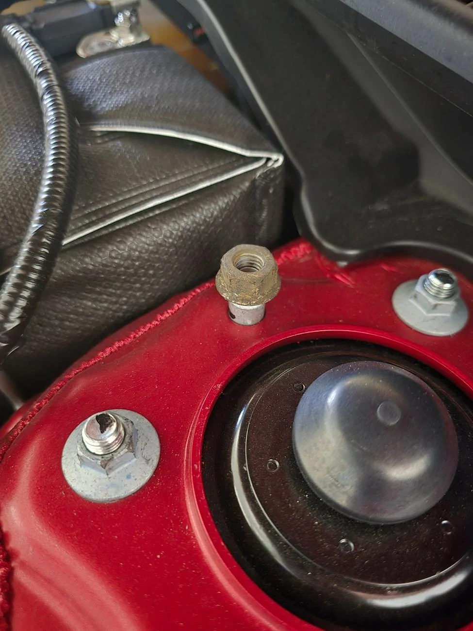

The pins were SUPER easy to remove. I just used an old nut from the lower arm strut pinch bolt on my gti and intentionally cross threaded it onto the pin. It wasn't the same thread but it was what I had available in my junk drawer so why not?!?
You can also just grab a set of nicer vice grips and clamp down hard on it, then wiggle and pull. Pretend you're a dentist pulling teeth. Loosen the strut nuts slowly and it will slip/slam into place. It will toe you out, but there's factory toe in, so it won't become undrivable or anything. Then just take it to a shop and have them align toe to 0 or slight toe in depending on what kind of turn in you're looking for.
I haven't loosened mine because I want a true before check on a rack. I'm pretty confident factory alignment is not in great shape and acura service manager rolled his eyes at me in disbelief that "a new car would be off on alignment". It might be a tad petty, but I'll show him the proof, 😂.

When I pulled my strut pins I think I picked up like -.1 deg camber. It was very nominal.
797
512
I'll do a before and after measure. If I can get an additional 0.3 total, that would be huge.
It doesn't sound like a lot, but if you start at 3.0 total and add 0.3 total, that's a 10% gain from doing basically nothing. It will make a difference, and since it's getting an alignment anyway why not!

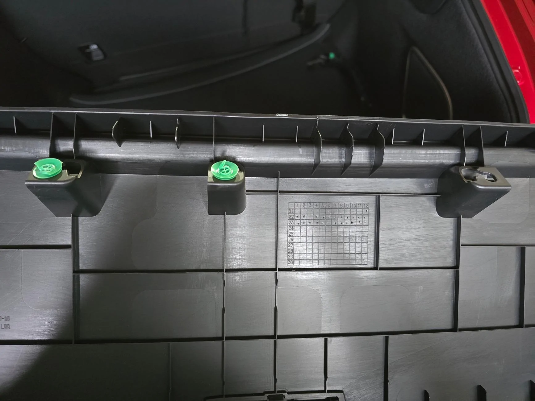

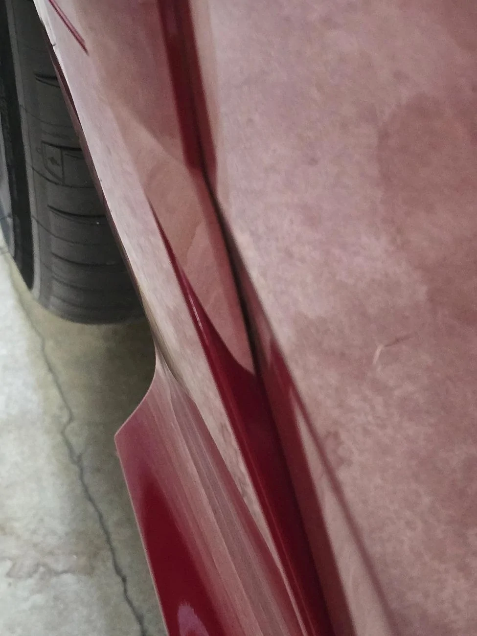

Well, I took apart hatch trim to put in the CF spoiler and I found two broken clips and one entirely missing. No wonder the hatch plastic flexed so much and rattled. The broken pieces weren't in the sheet metal, so someone clearly knew about it, cleared it out, and didn't replace the clips. I bet it was the dealer tech that installed the black badges.
Acura Integra Back on Track 20240720_122936

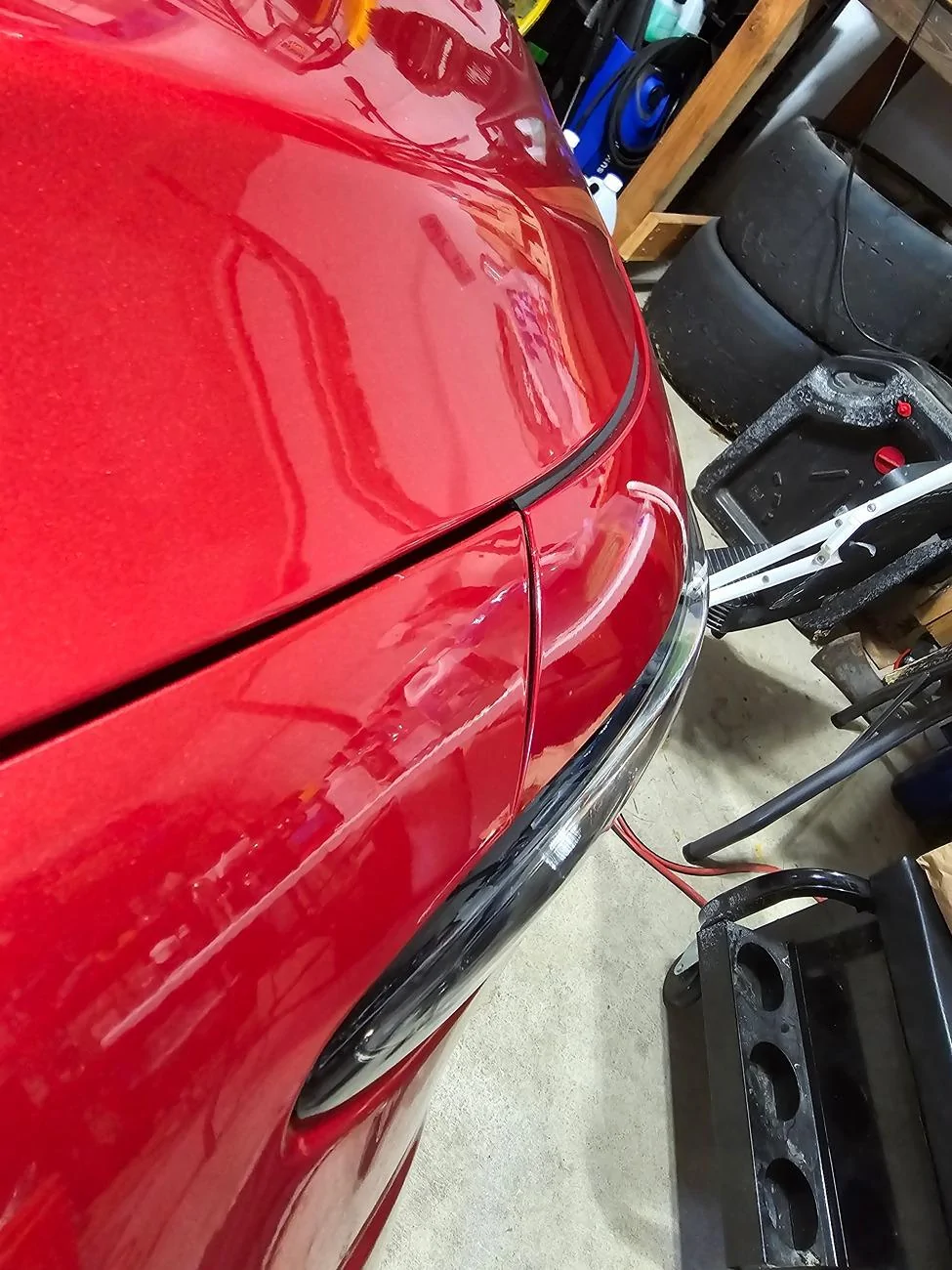

I'm also going to try to fix this delaminating stick on fender bit today...
Acura Integra Back on Track 20240720_115152
I was also going to try to adjust the hatch closure adjustment bumper to even out the mismatched hatch to rear panel level, but the adjuster on this side is already totally out and the one on the other side is totally in. There is zero room left for adjustment, so I'll just have to live with it 😔
Acura Integra Back on Track 20240720_115112

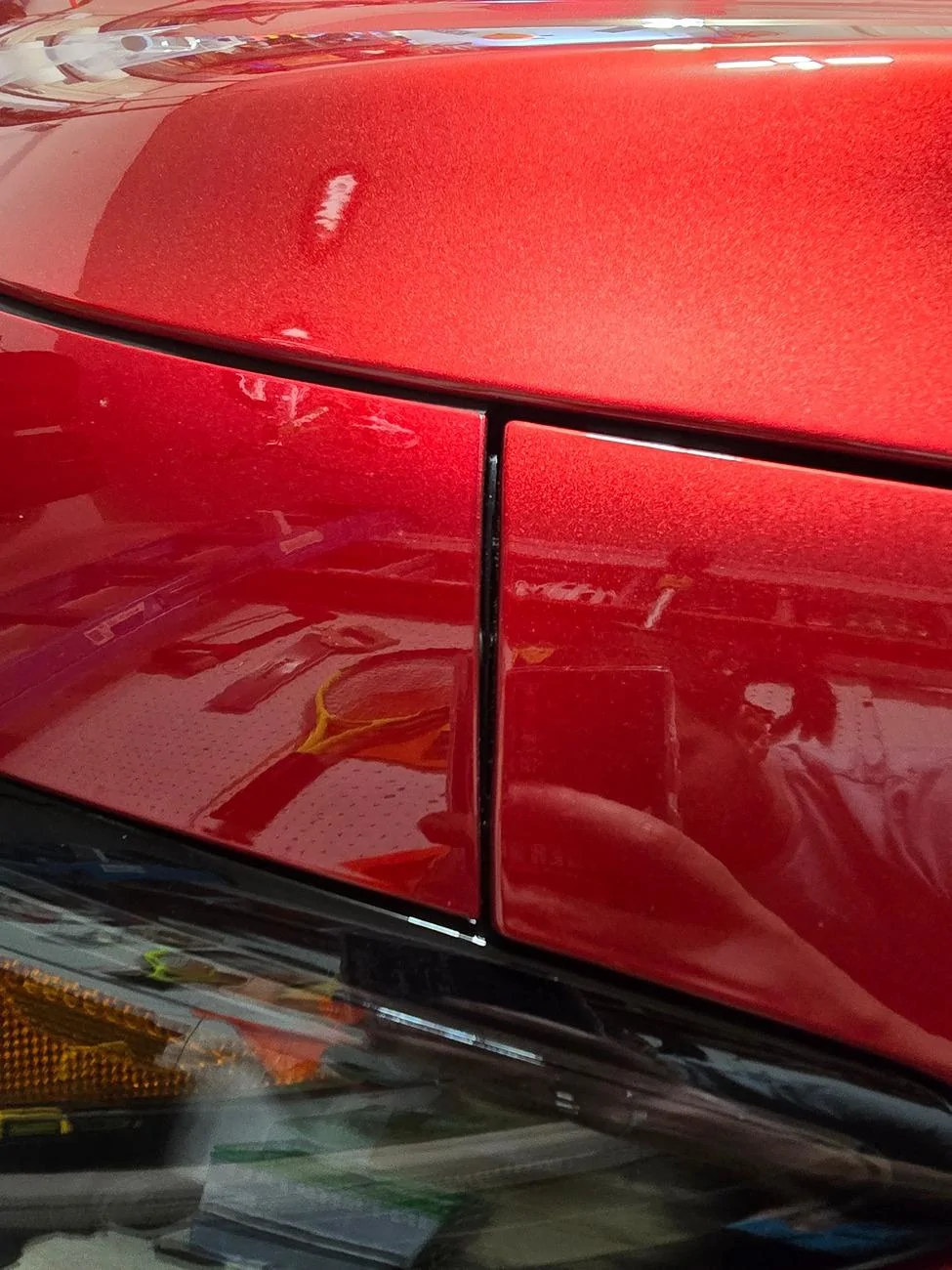

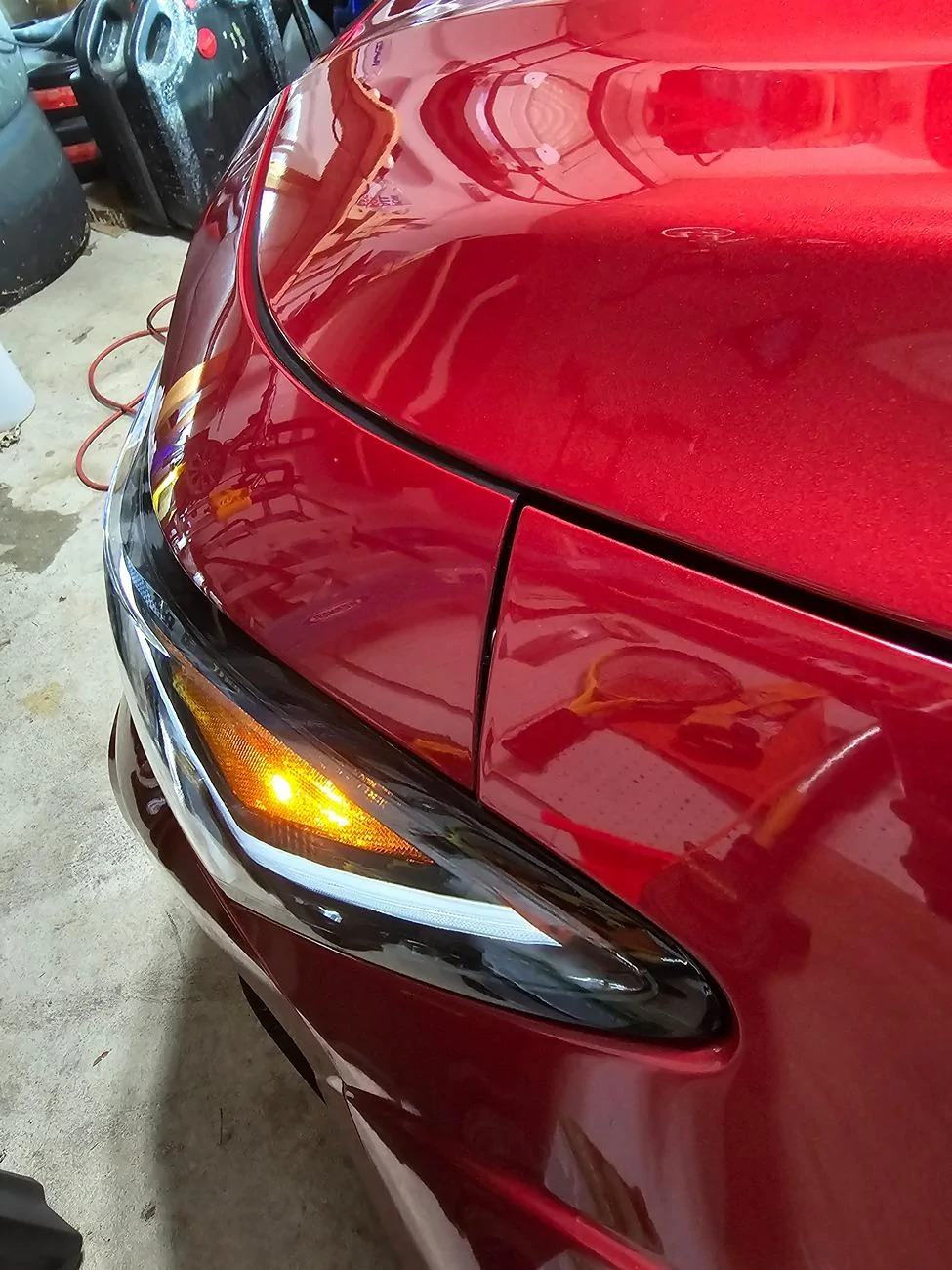

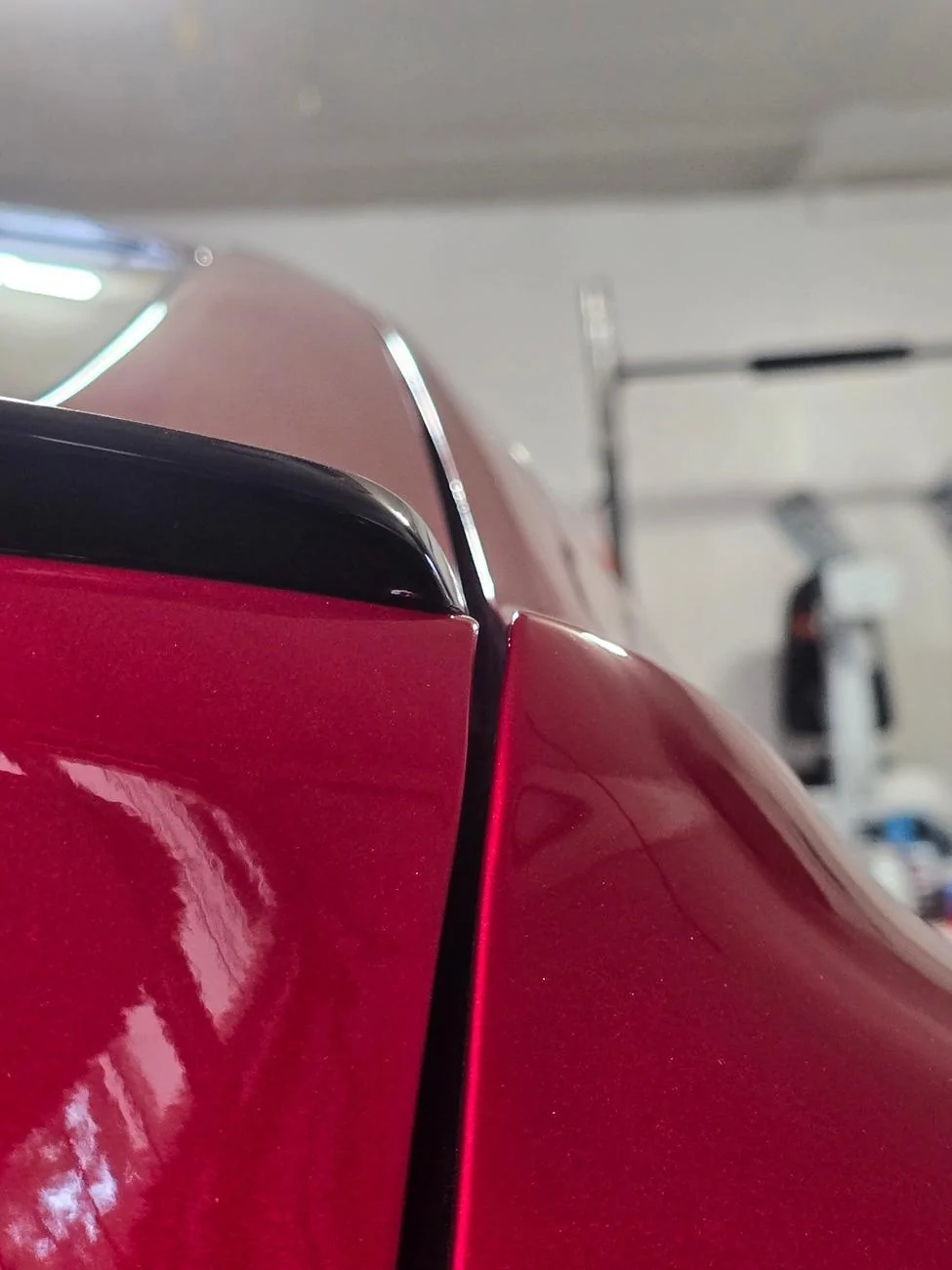

Also, if anyone has any ideas on how to fix this horrendously aligned and mismatched cowl to fender body alignment, please let me know. I'm thinking maybe pulling the cowl, heating it up, and flexing it into position...?
Acura Integra Back on Track 20240720_115359
Acura Integra Back on Track 20240720_115352
Acura Integra Back on Track 20240720_115519

Lots of little crap. I try not to look too closely at anything for fear of finding something! Lol.
I have the LCM and I think it’s great for hiding panel misalignment.
