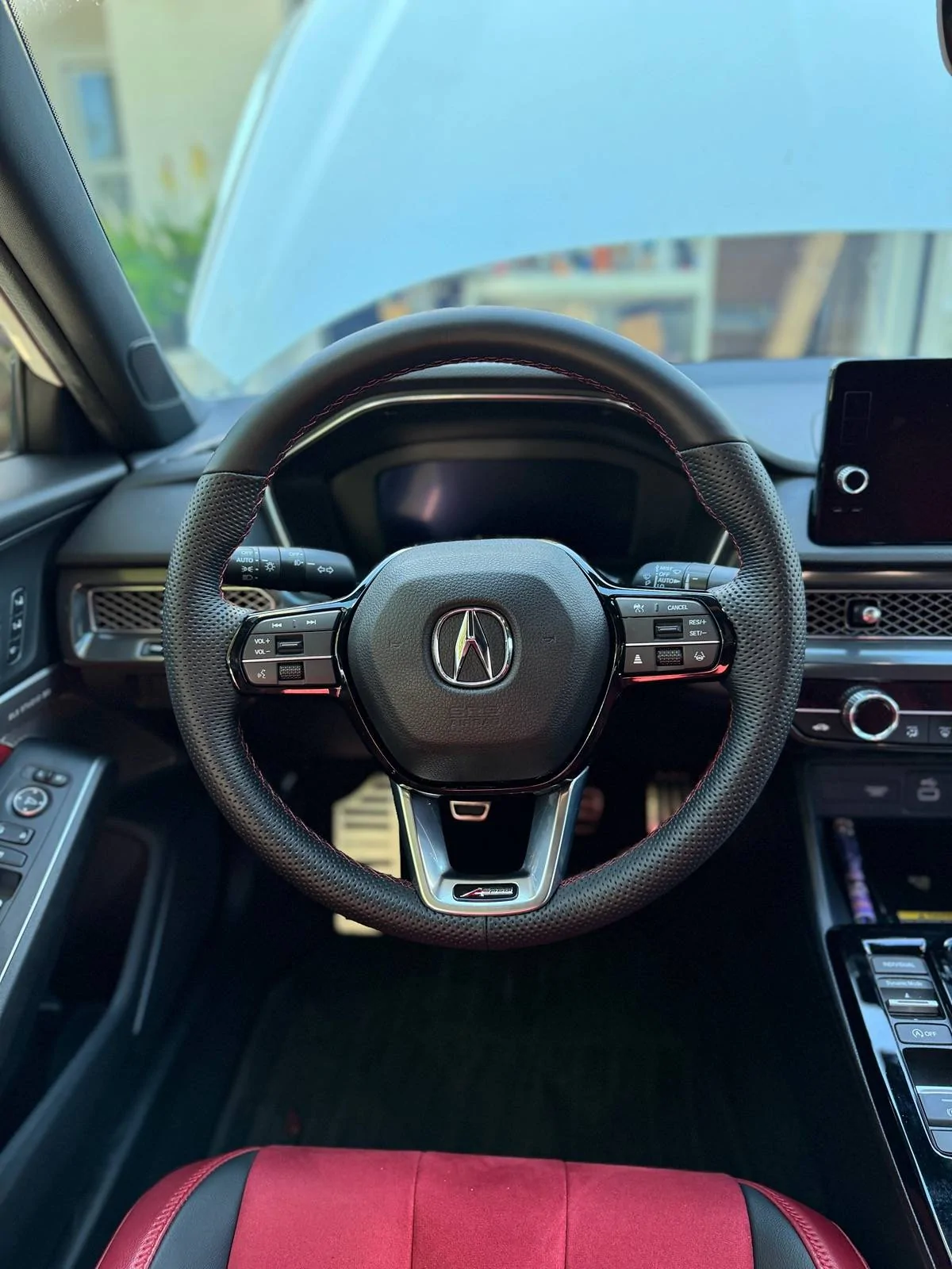

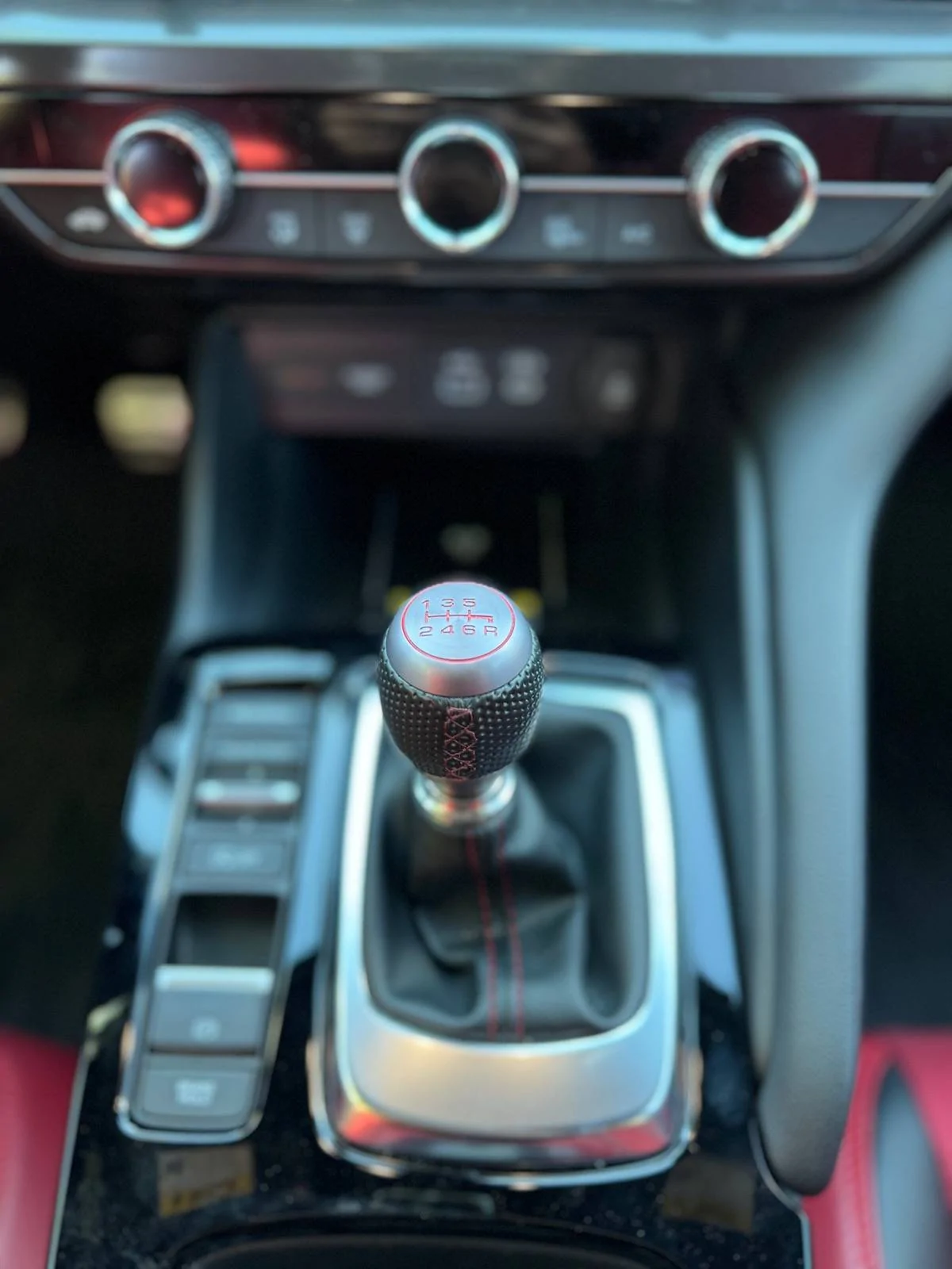

Type-S steering wheel and shift knob āœ…

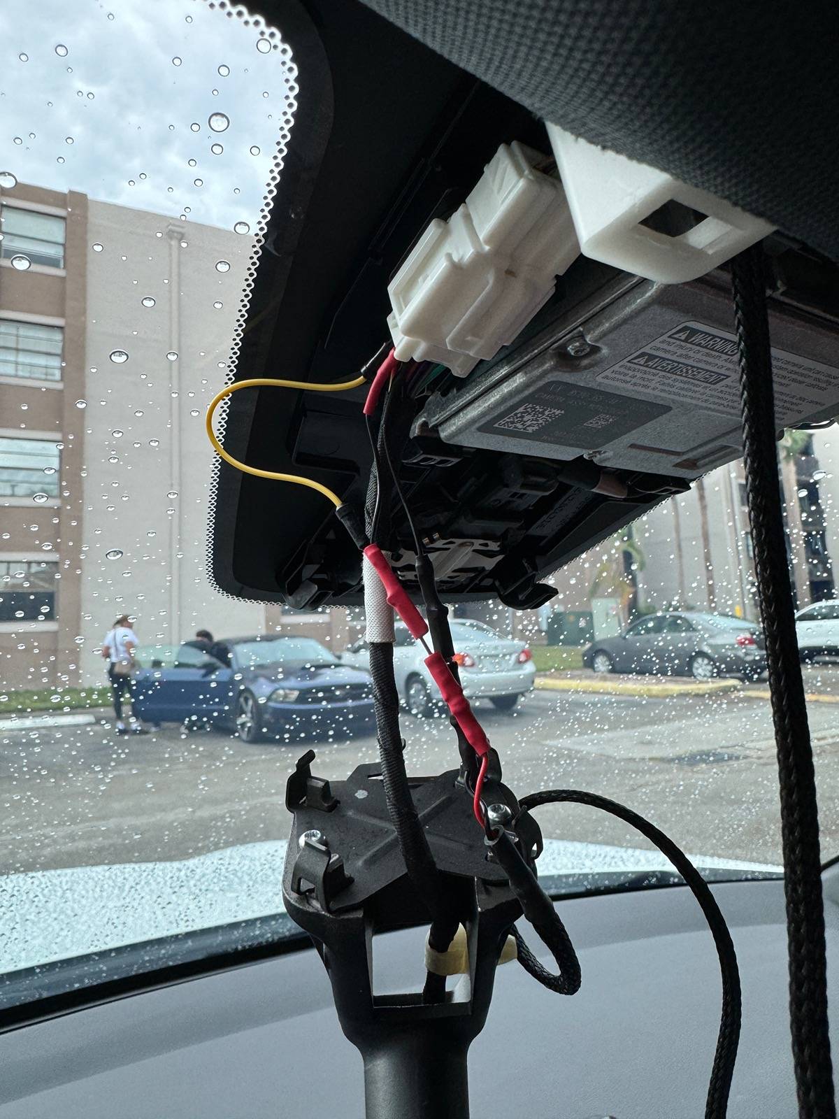

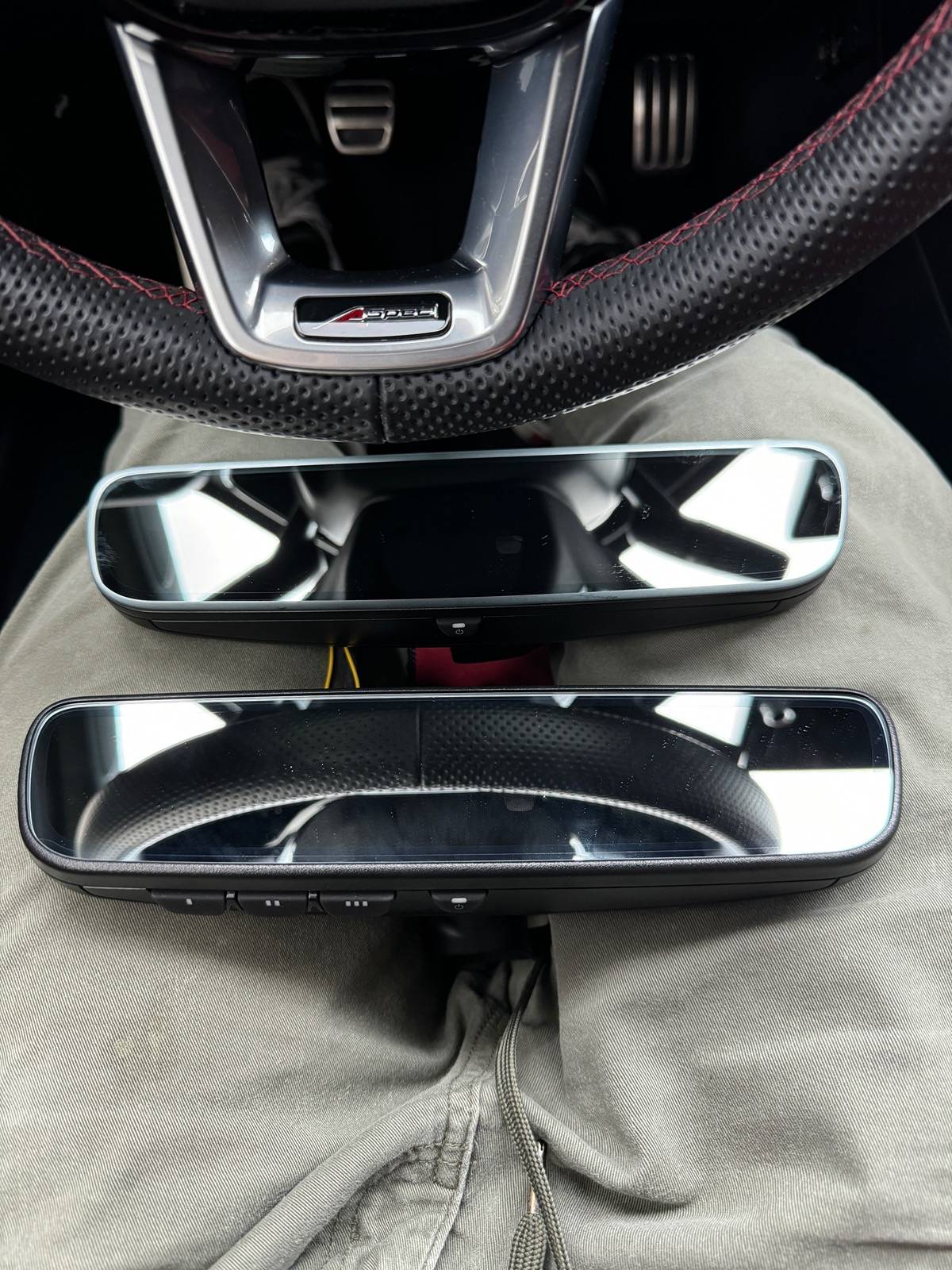

Frameless Homelink Mirror āœ…
For those wondering how this was done, you need to find a 2022+ civic homelink mirror. Itā€™s generally plug and play requiring a jumper wire between the yellow and red wires (my yellow wire). My wiring looks a little different because I also wired my valentine1 to the same connector. To elevate the mod I swapped the faces of both mirrors to retain the frameless look. Pretty easy.
Hi Bao. Do you happen to have a part number for the Civic mirror?
Iā€™ve read a few other threads on mirrors, and I see a few variations. Would you say this is the most cost effective way, or do you recommend the Accord route? I donā€™t mind going the used route.
sorry I thought I had been replied, I DO NOT RECOMMEND THE ACCORD ROUTE. If you search eBay for "2022 Honda Civic mirror" look for images for ones with home link. A lot of the listings do not include the part number but this one is T20-A11. Good luck!
I bought mine for $100 and the listing did not specify the mirror had home link or the part number. I've found used listing for the correct part number for about $200. Happy searching

Is swapping the oem frameless mirror to the civic mirror housing plug and play?
yes. its as simple as removing the face/disconnecting the connector and swapping. If im being honest the frameless is so unnoticeable it might to be worth almost cracking your frame if you're not careful. If you attempt I recommend you do it to your stock one first to see if you're successful.
