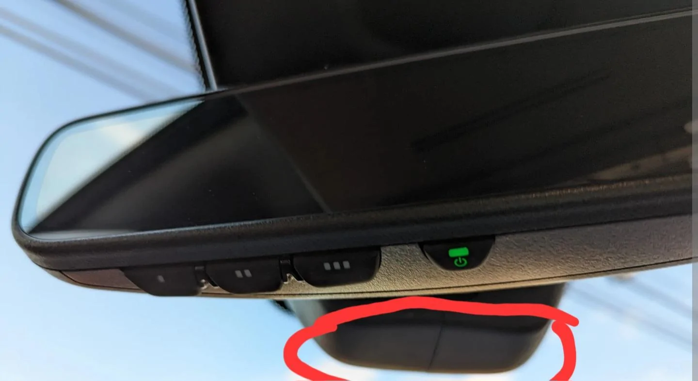

I think I may have figured it out - the buzzing seems to be coming from the trim piece right above the rear view mirror. It was buzzing yesterday as I was driving and held that piece and it stopped. Go figure.
I'll mess with it when I have the time or maybe I'll just wait to tape that area up when I install a fitcam.
I found my issue. It's this piece sits behind the rear view mirror. I just added tape around and no more buzzing nosies
Yes! I have a buzzing from there! It goes away most of the time if I put pressure on it. Where did you put the tape?

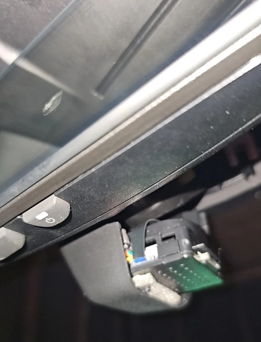

I have Fitcamx. The buzzing was internal. I just added foam tape on the board. No more buzzing now. I am so happy
