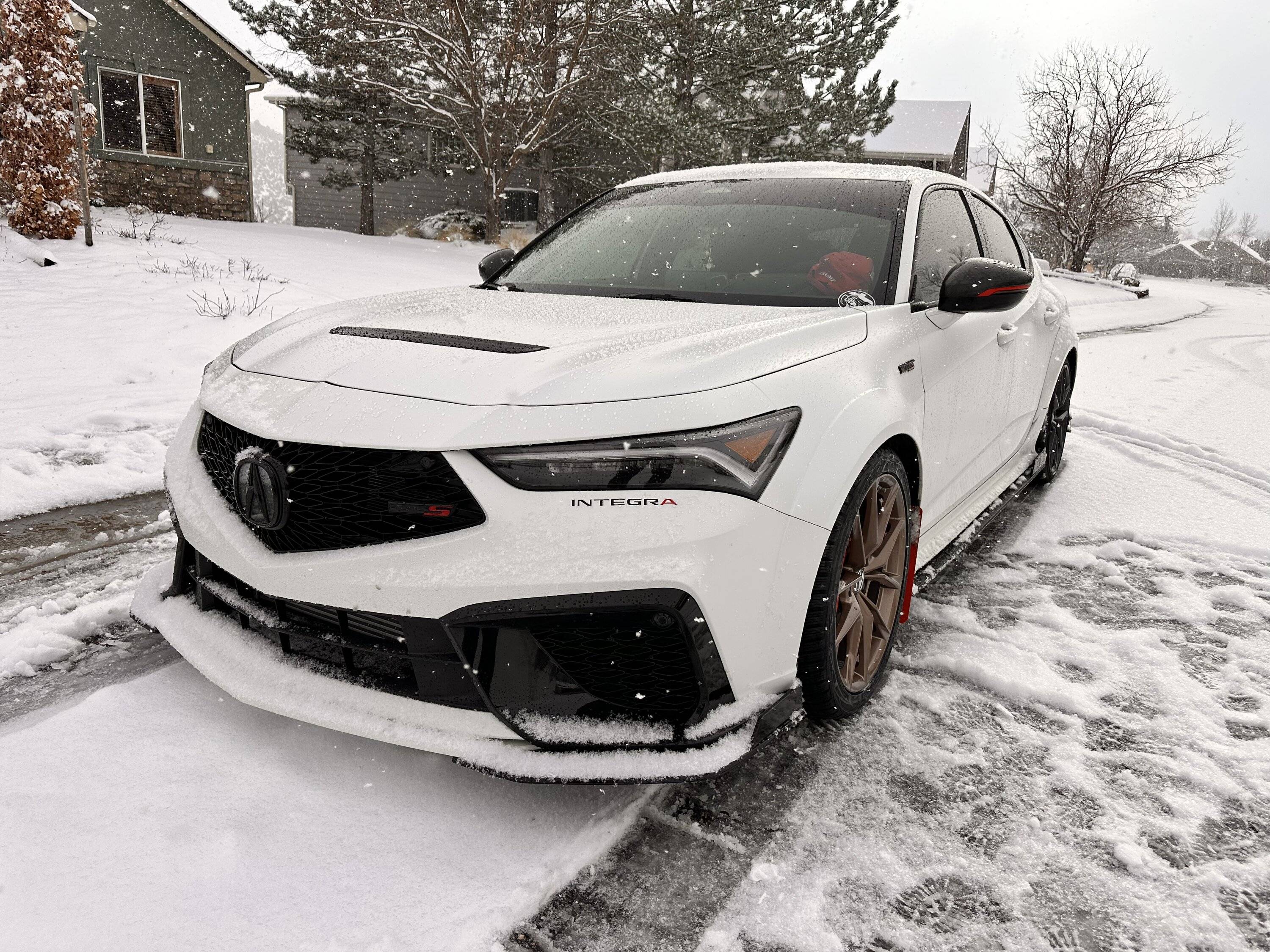

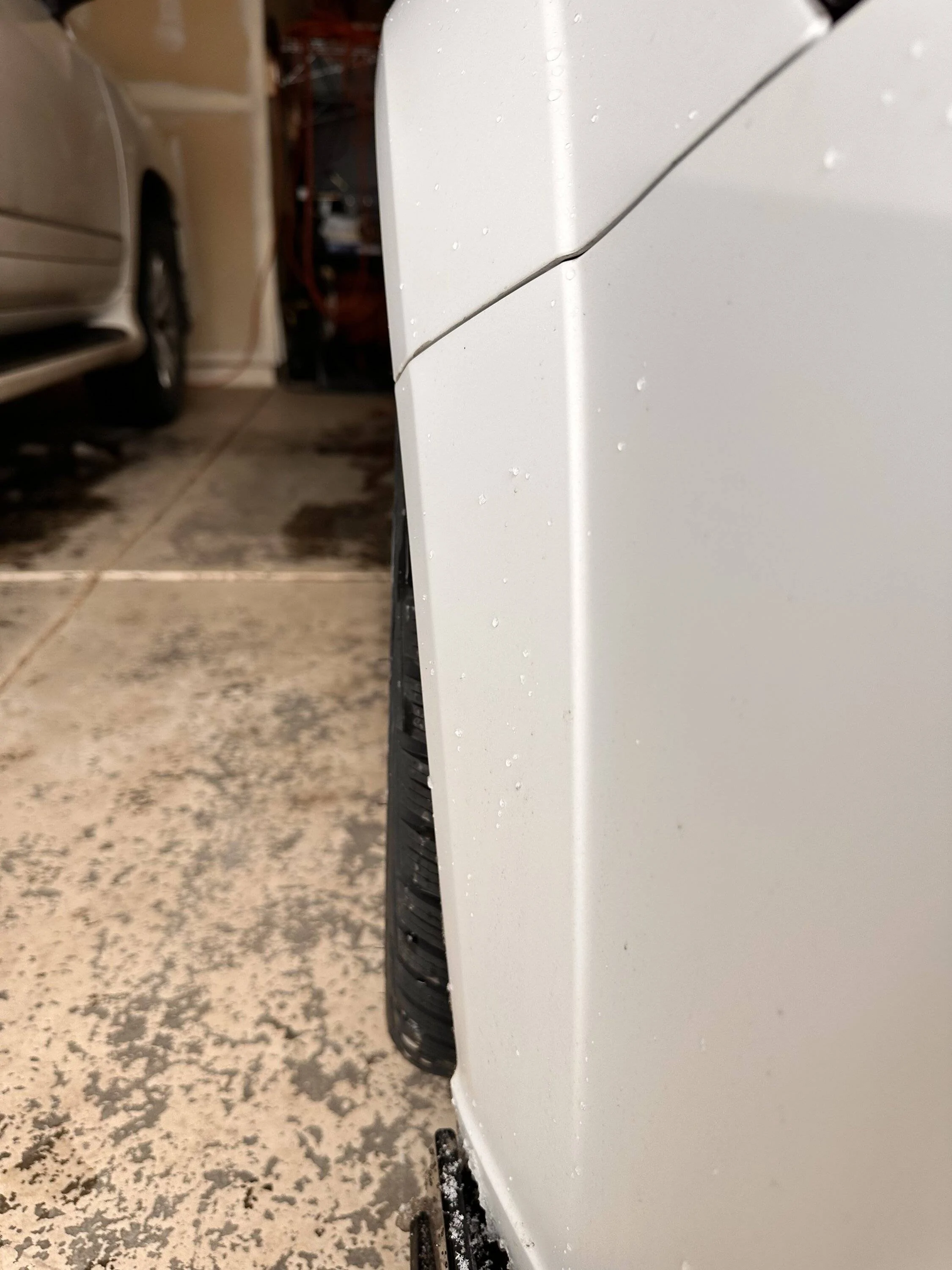

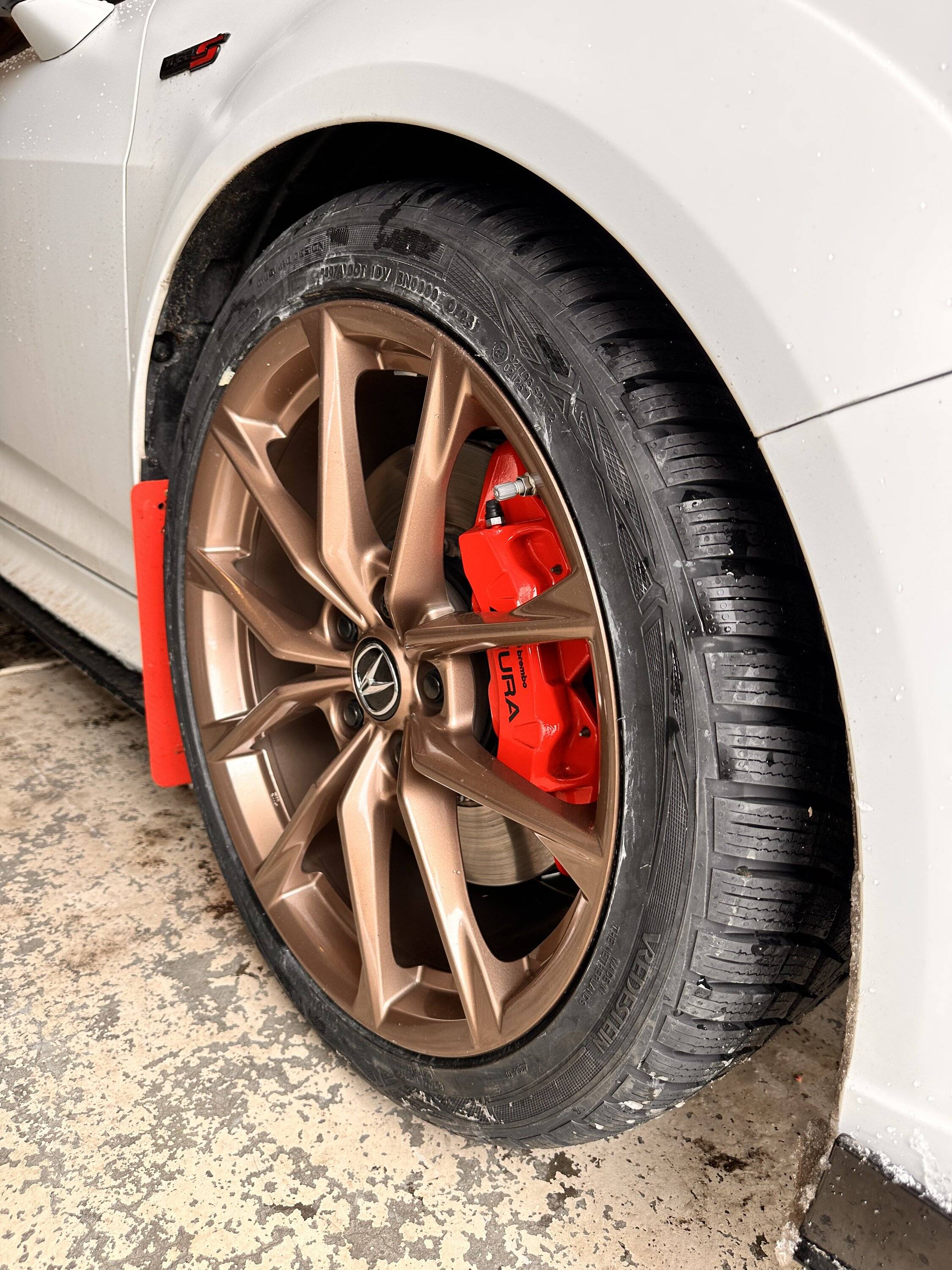

im running 275/35R19 tires now but with no spacers. There are no rubbing issues. These are my winter set of wheel and tires. Here are some pictures to show you the expected ride height and how it looks from the side
Thanks very much, this is exactly what I was hoping for to be honest, I think 20 mm spacers would work with this set up based on these pics.
If the "35" doesn't adversely affect the car or the gearing in some way then I think this is the ticket, otherwise the 285/30/19 sounds like an option as well.
I appreciate the pics.

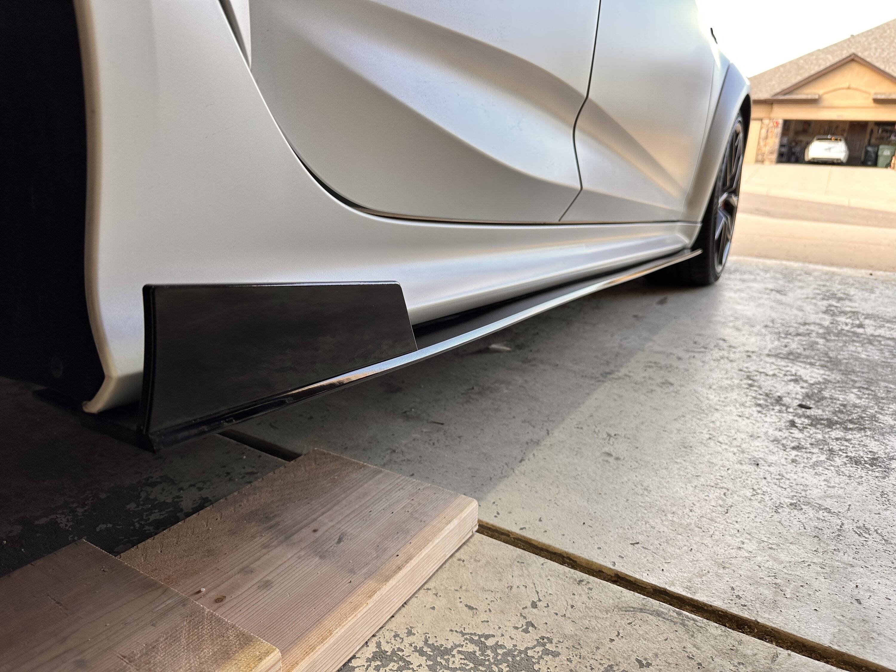

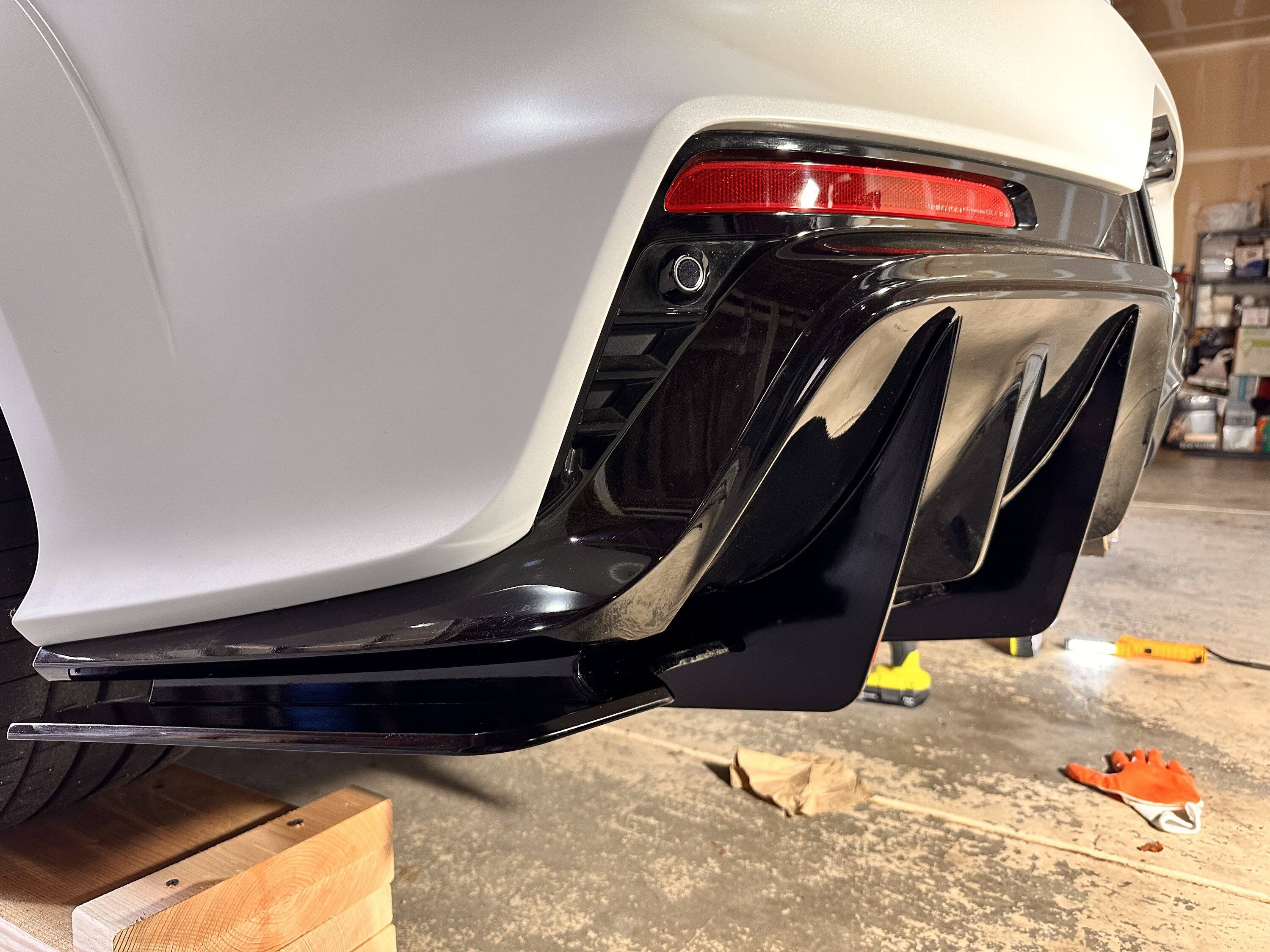

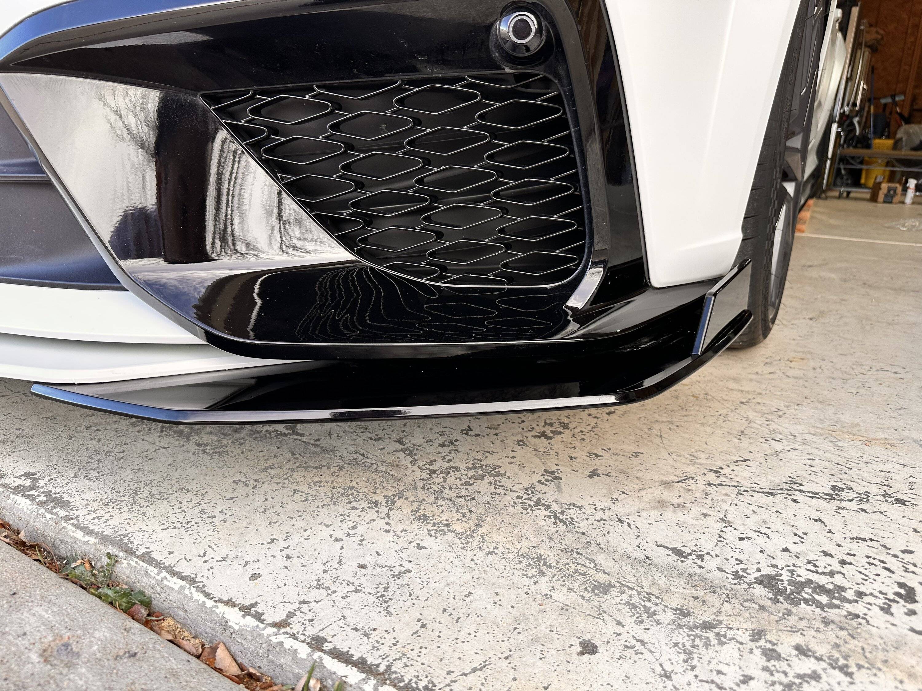

Do you have the complete artwork kit?

2007 Nissan 350z
Yes sir! Front diffusers, rear diffuser, and side skirts. Took about four months to receive since the initial order
Do you have a link to order these parts?
