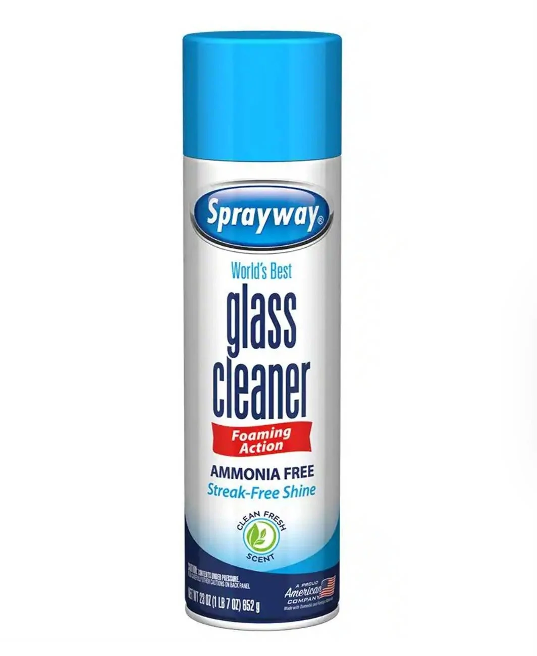

This and a microfiber for inside and out
/thread
This is the stuff that body shops and dealerships use. No ammonia and you get a streak free shine. Here are a few other tips:
Work in the shade. In the sun the window cleaner will dry too quickly as you wipe making things streak more. Make sure your windshield is at least cool before starting
Open all windows or have all doors open so moisture doesn’t build up from you perspiring inside as your wiping
Make sure you wipe until there’s no more cleaning solution at all
Have a separate “dry towel” for your windows for after your initial wipe down with the window cleaner
I’ve used this method for years and has worked fairly well

That stuff works ok, if the residue gets heavy it doesnt get it all...an I use slightly soapy water for tint as other stiff tends to degrade the tint or the glue for the tint

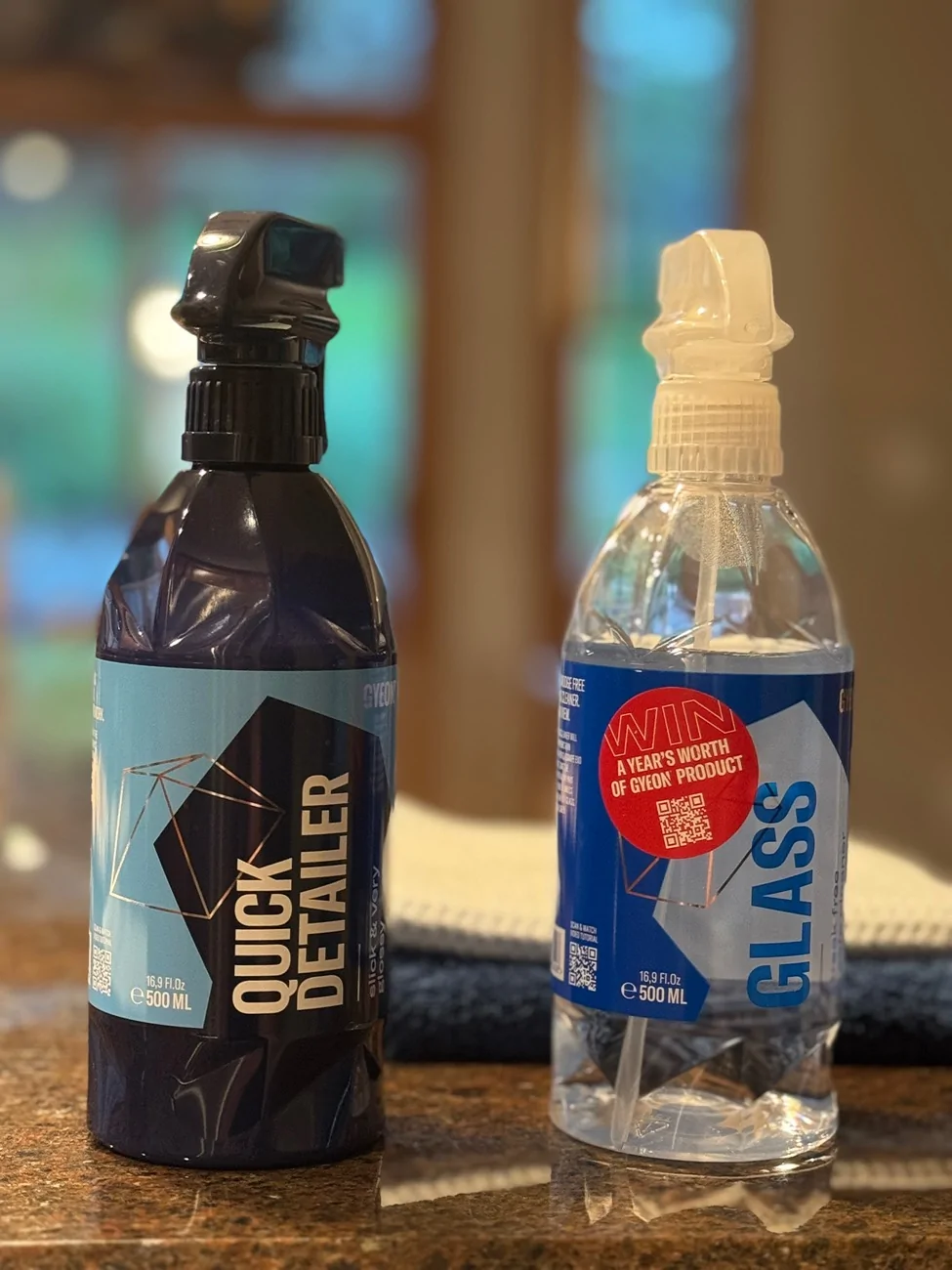

Update!
Gyeon glass cleaner works extremely well! Also purchased quick detailer and some microfiber towels from them. Everything is quality!
