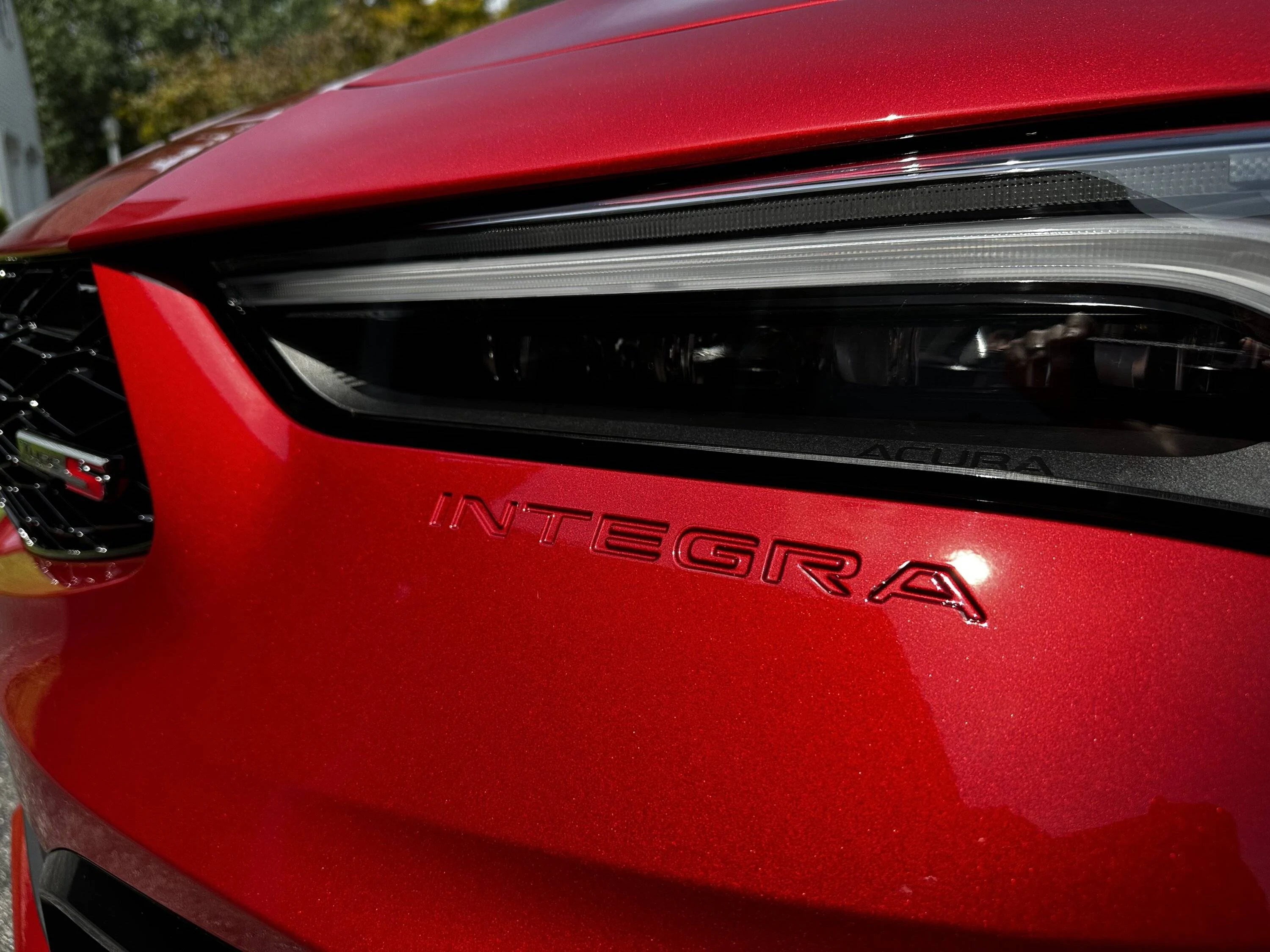

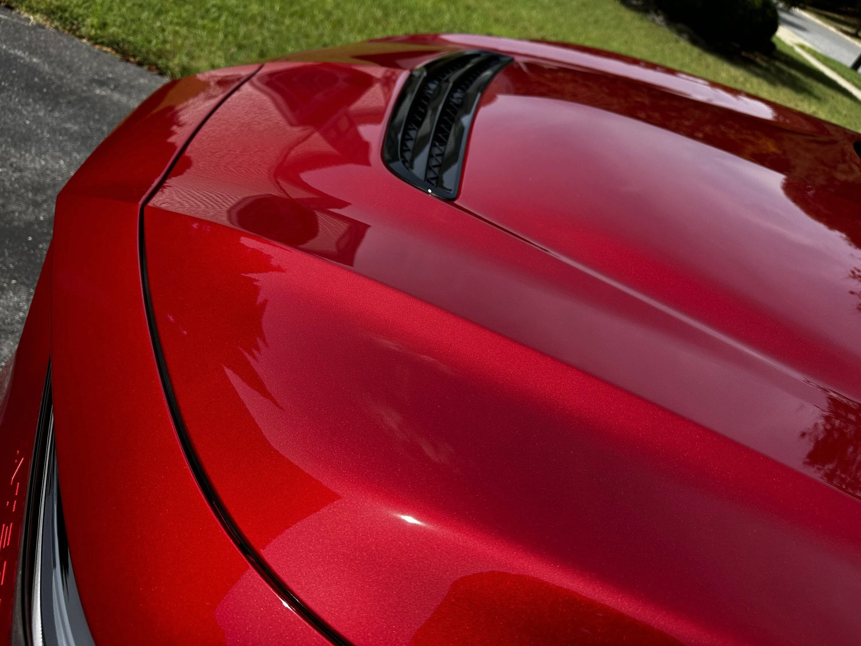

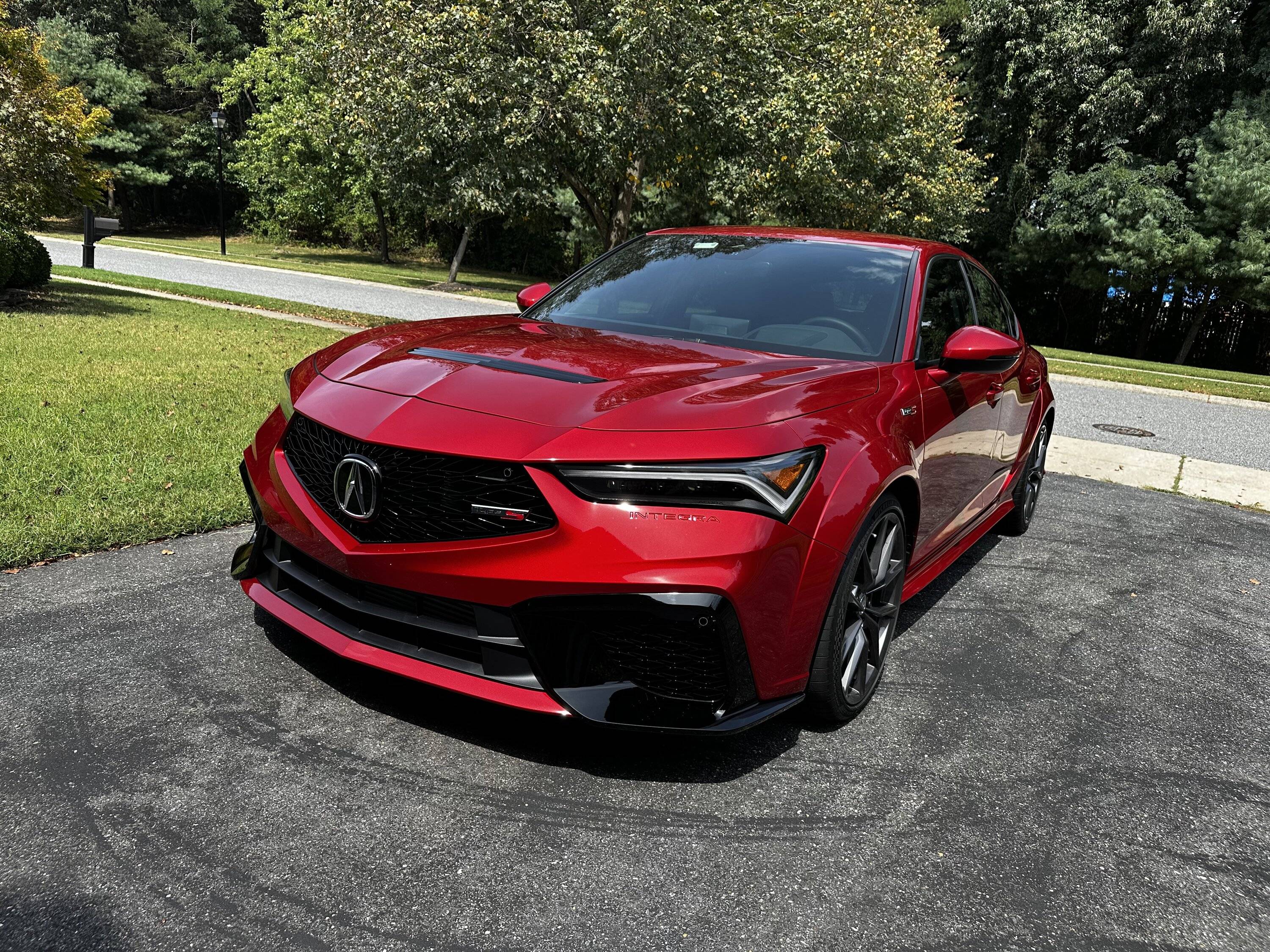

For my car, it is brand new with no defects I care enough about to correct, and it was pretty well decontaminated by my PPF installer so my process was this:
Wash with "Clean Slate" from Chemical guys
Dry with leaf blower + microfiber waffle weave towel
Apply Reflex Pro Enamel Coat
Done.
It turned out as expected; exceptional. Hopefully the pictures capture it enough to get the point across that you don't need to spend $1500 for your car to look good for long periods of time.

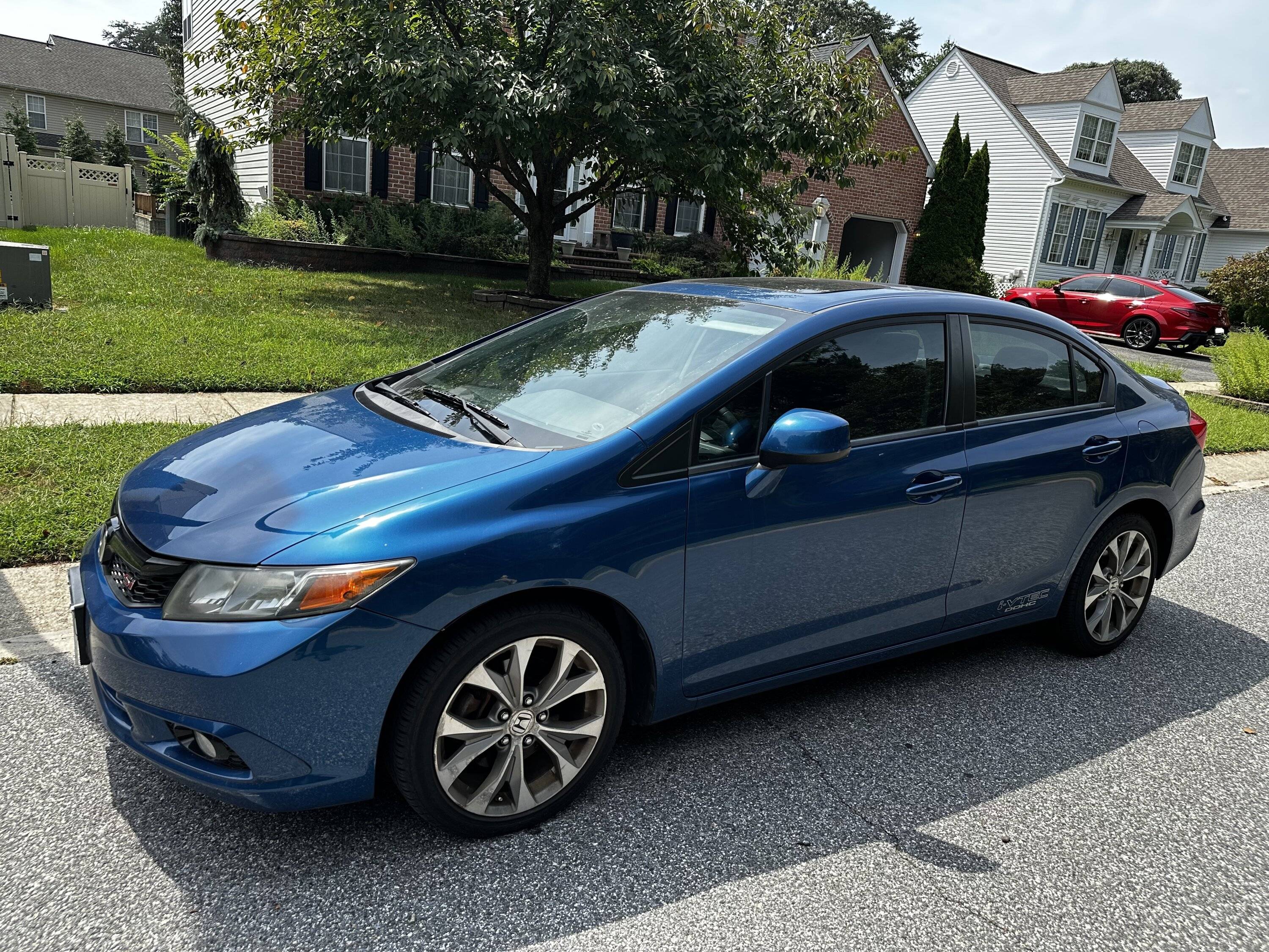

My son's Si was well taken care of, but was still 10 year old paint. For that one I did the same Clean Slate + dry, but clayed then corrected with an orbital buffer, then IPA, then Reflex Pro. Probably took me 4-5 hours total. I really wish I took pictures when I was finished because that car looked fantastic and then he subsequently didn't wash it for a year, and it still somehow looks pretty decent. This is how it sits right now, parked outside and not being touched since June 2022.

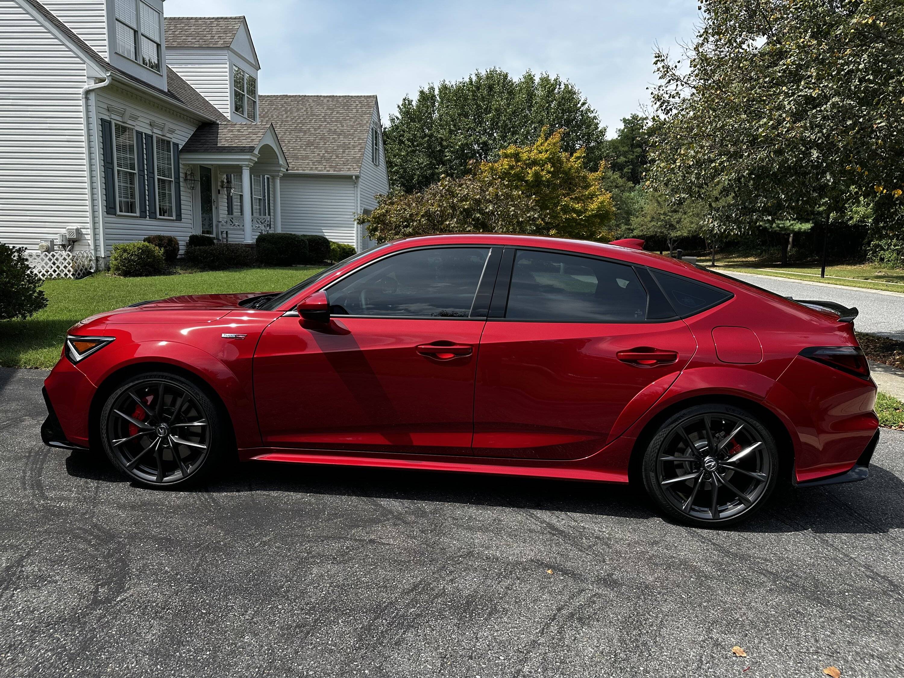

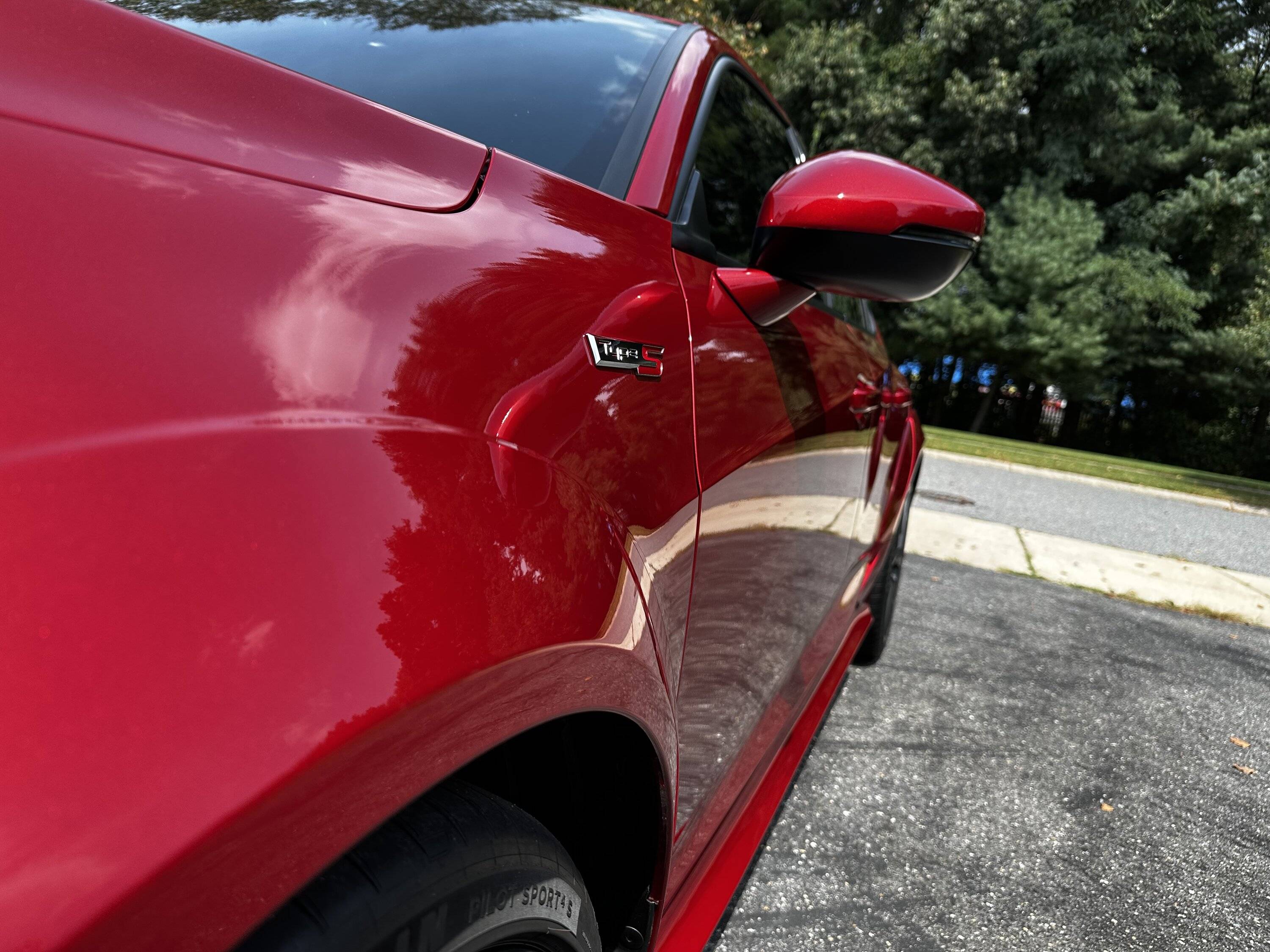

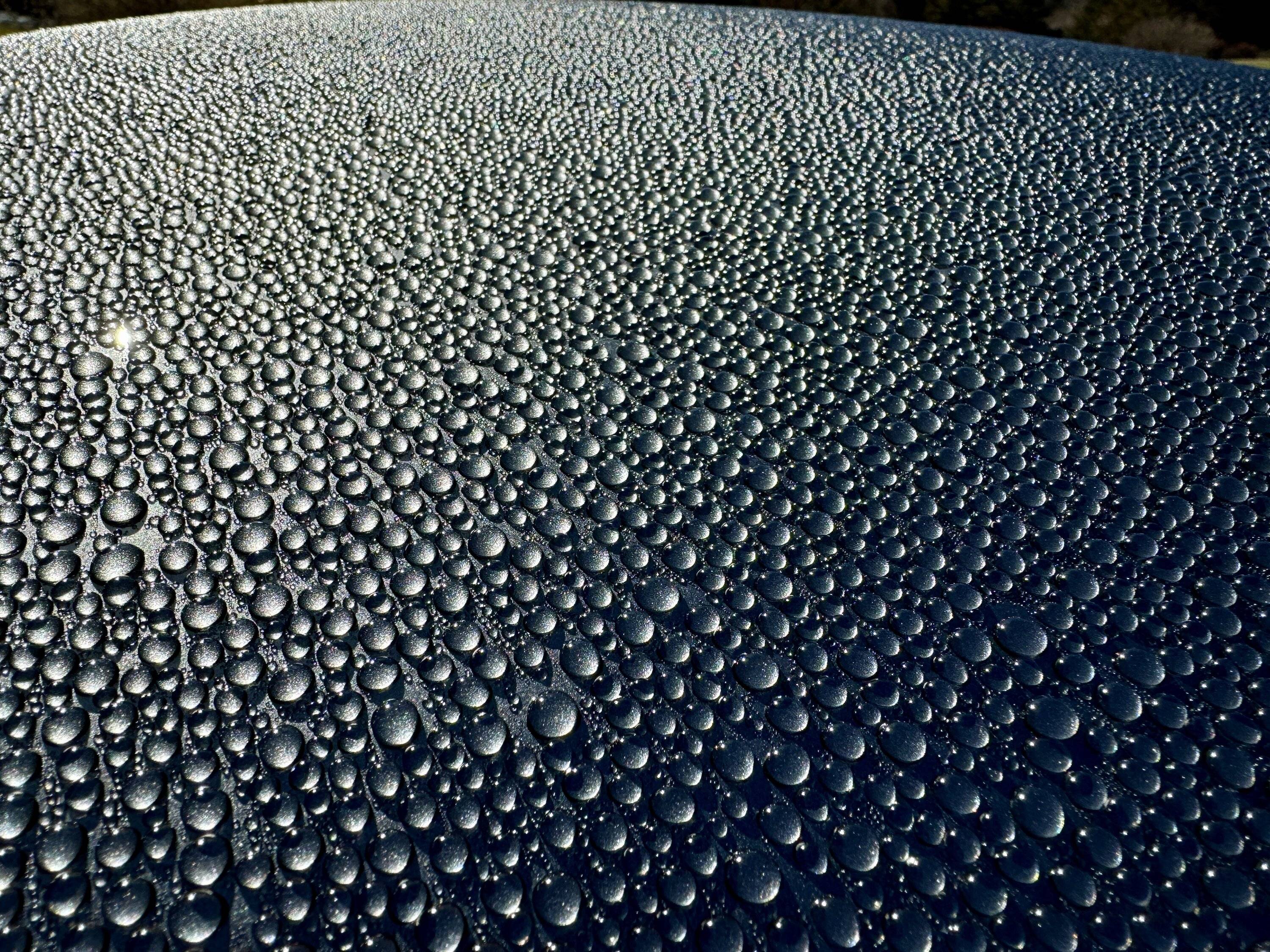

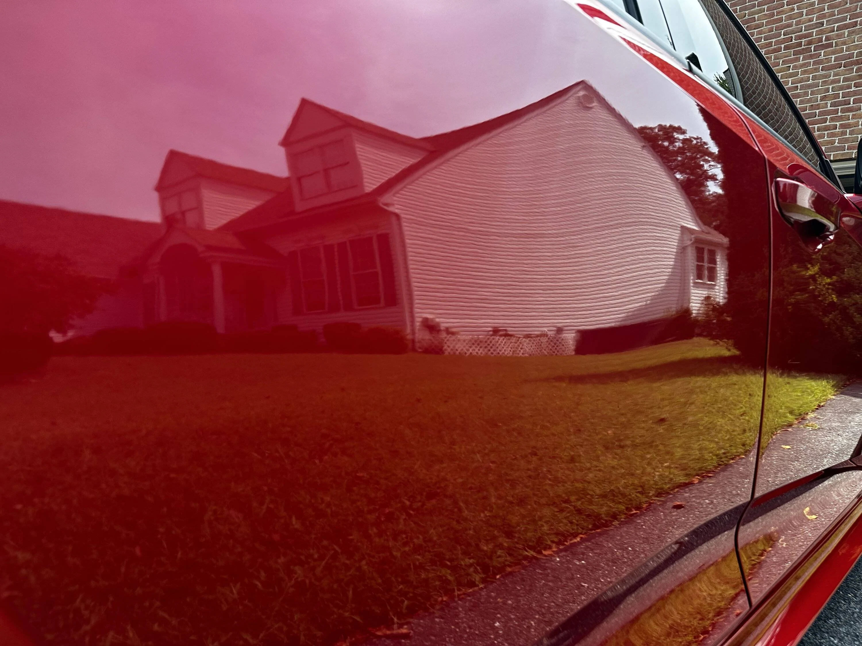

Extremely late reply to this thread but I wanted to share the results in case it helps others.
I ended up using Adam’s Advanced Graphene Coating and have been very pleased with the results. I’ve never seen water beading like this before!

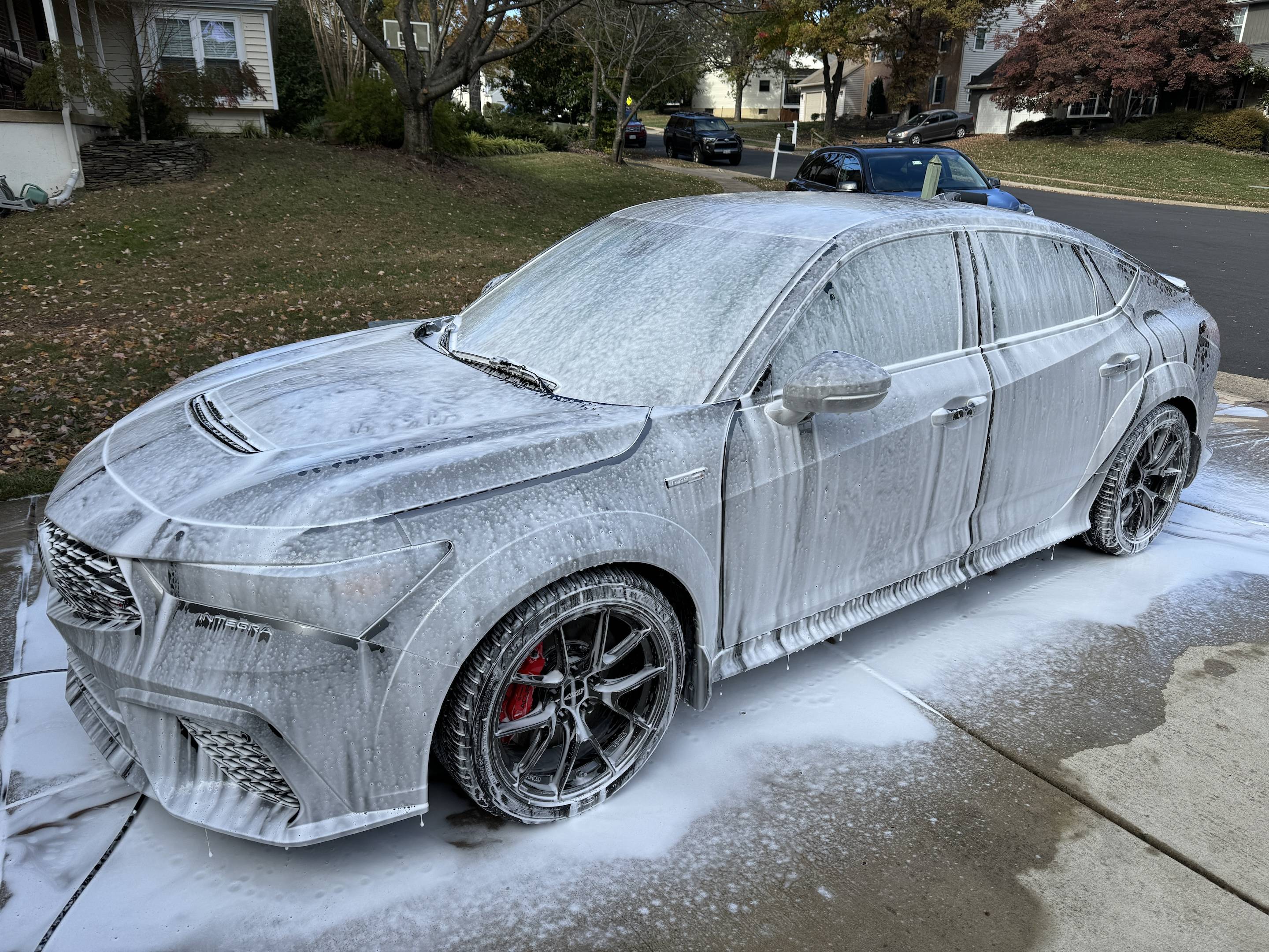

The whole process took me a weekend but the results were well worth the effort. As others have said, the preparation is important and while it may have been overkill, these were the steps I took:
  1. Wash then rinse
  2. Spray Adam’s Iron Remover then rinse
  3. Wash then dry
  4. Decontaminate with Mother’s Clay Bar System
  5. Wash then dry
  6. Light polish
  7. Wash with Chemical Guys Clean Slate then dry
  8. Wipe with Adam’s Surface Prep
  9. Apply Adam’s Advanced Graphene Coating
  10. Let the coating cure for a few weeks then applied Adam’s Graphene Boost
Maintenance since has been the typical wipe down with detailing spray whenever needed to keep things clean. Months later, the gloss is deep, the shine is brilliant and the hydrophobic properties impress.
