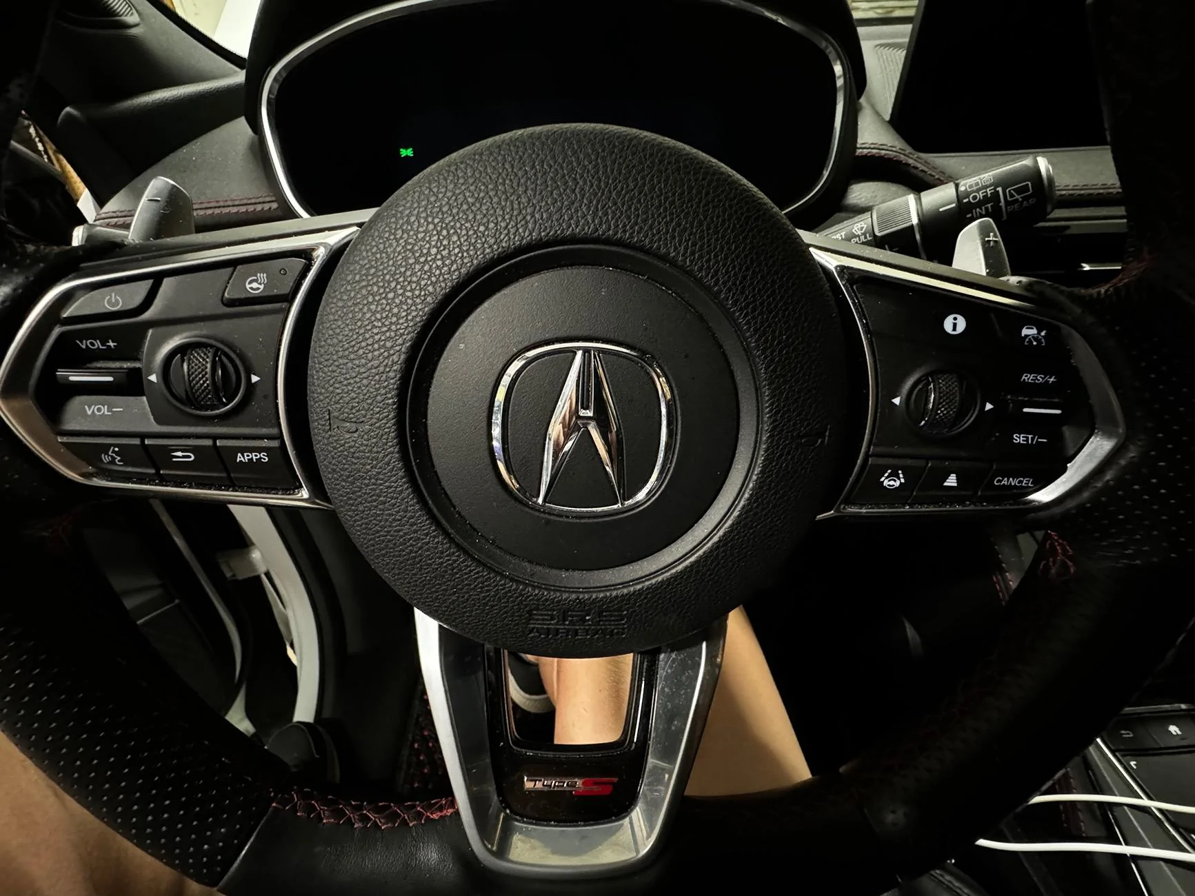

I love the heated steering wheel in my wife’s MDX Type S. Fit and feel to the hands is perfect for me. The diameter is identical between them. I wonder if anyone that works in Acura parts can figure out if the electrical connections are compatible to use it in the ITS? The flat bottom is another plus in both looks and feel.
The air bags might be of different sizes….🤷🏼‍♂️
Acura Integra DIY Heated Steering Wheel Install IMG_1331

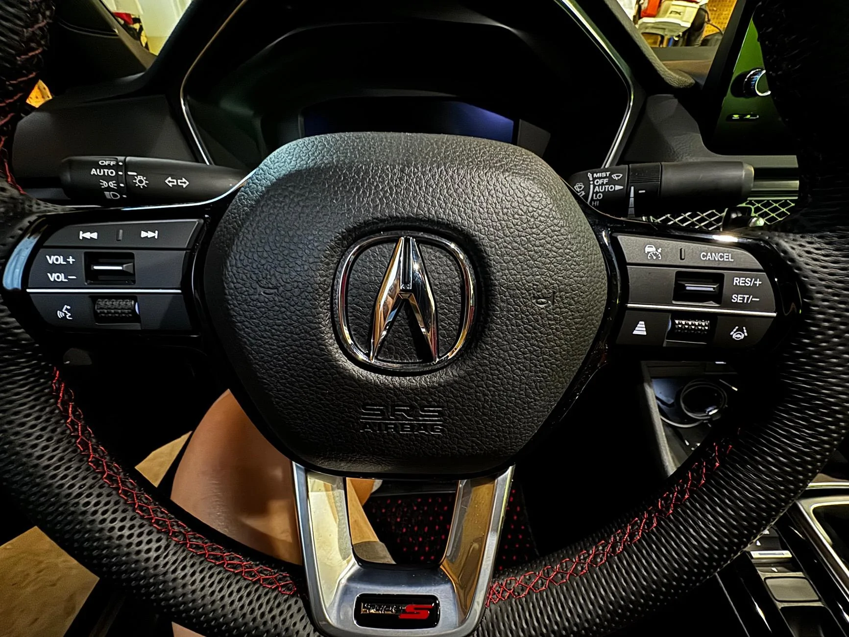

It did! I've been rocking it for a few weeks now and loving the comfort in the cold. I've gotten a bit lazy and haven't found time to put together my video yet, but thanks for the reminder - I'll try it to do it sometime soon. Here's a picture for now:
I feel like the heat button at the bottom is the most obnoxious location for a single function button.

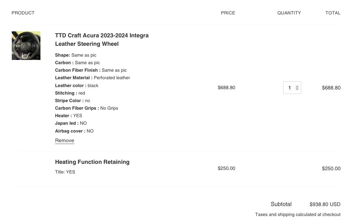

Yeah, heated seats is nice and my heat in garage broke this week and I sincerely miss the heated wheel. This seems like pretty much what you put in yours right?
Acura Integra DIY Heated Steering Wheel Install 1733413649621-37
I'm pretty sure that picture is my wheel. That looks like the inside of my garage lol. I know they post previous custom orders to their page in case someone wants to order exactly that spec.
I just sucked it up, put my big boy pants on and bought the same wheel as you. Hoping the install goes quick
