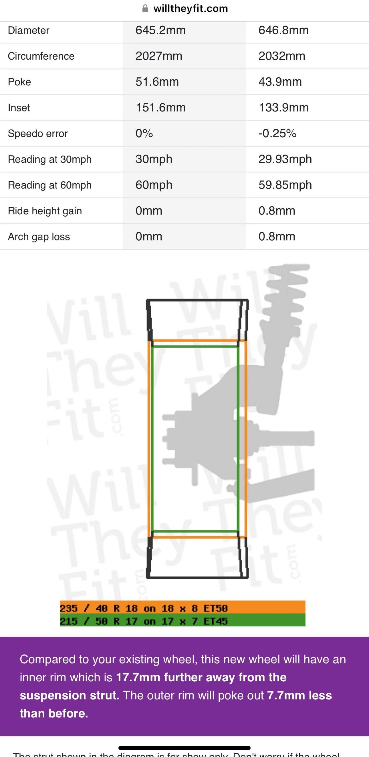

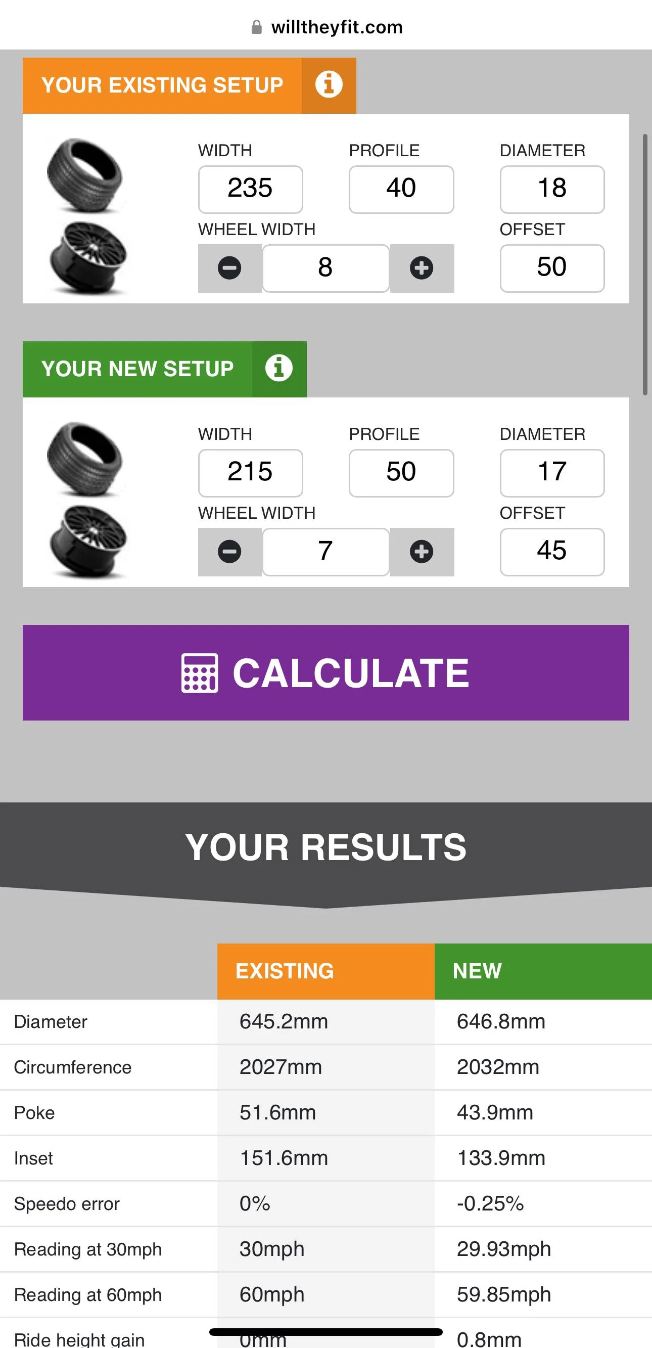

I looked at the post and the tire size changed from a 235 to a 215 above on that chart or whatever., so I just wondered if that meant you had to downsize the tire a bit to make it work, but your reply helped me understand.
I think this was to compare the base model wheel size (215 | green) and the A-spec wheel size (235 | orange)

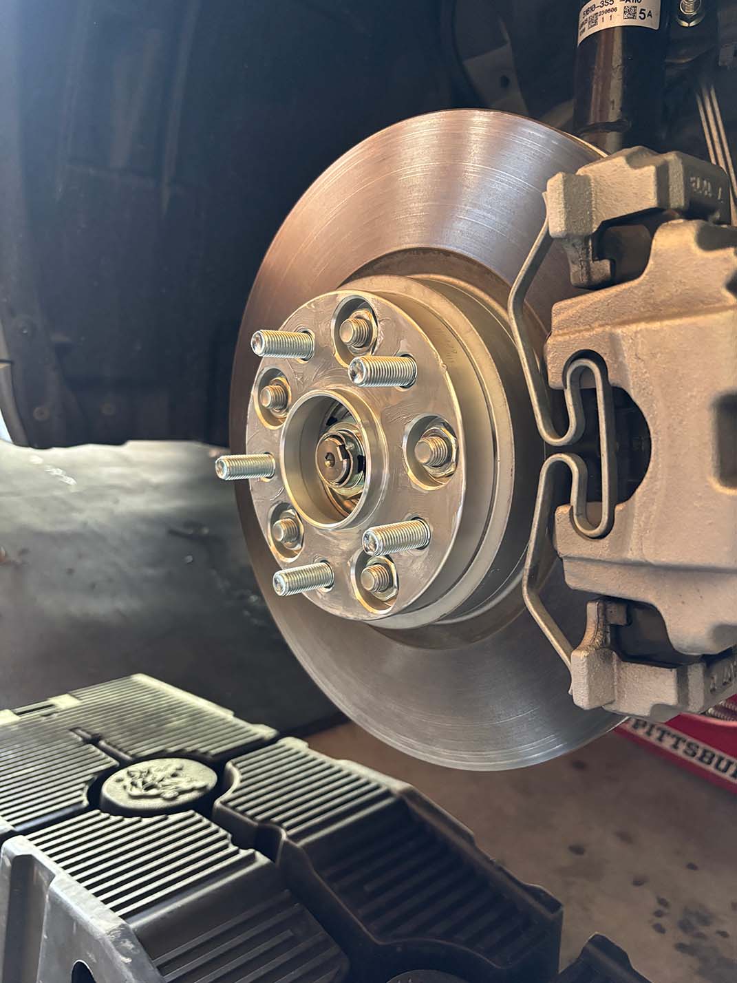

Following up on this,
I bought these wheel spacers
They fit snug on the wheel hub and no issues on the test drive.
the paste you see on the spacer is anti seize
Looks awesome šŸ¤™ you went with 20mm on all four corners? How are you liking the new look and road-feel?

coming back to this unfortunately... The driver side wheel has been clicking recently when backing up and it's to do with the spacers. apparently they've been pressing on the back of the wheel when put together so I need to get new wheel bearings. :thumbsdown:
What size spacer? Are you sure the wheels are torqued down correctly? If you went 20mm spacers, Iā€™m willing to bet itā€™s that. Stock studs will hit the back of stock wheels if using that size. Been running spacers for many many years without an issue.
Let us know!!
