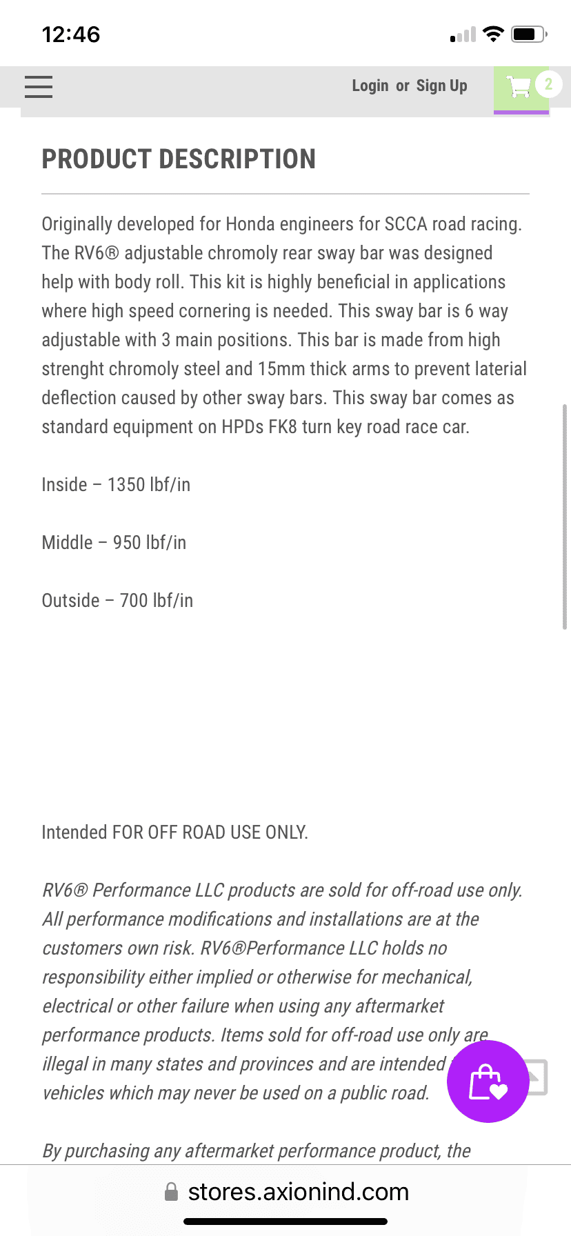

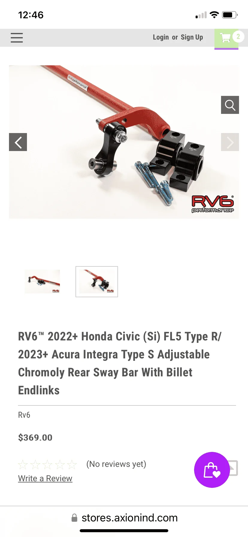

And also this - is the off road statement just for liability reasons like it is in the Jeep/off road industry?

The sway bar is probably noisy and/or not great for street driving. It would be legal to street drive. I had plenty of 'off road' use exhaust over the years but that's a different story entirely.

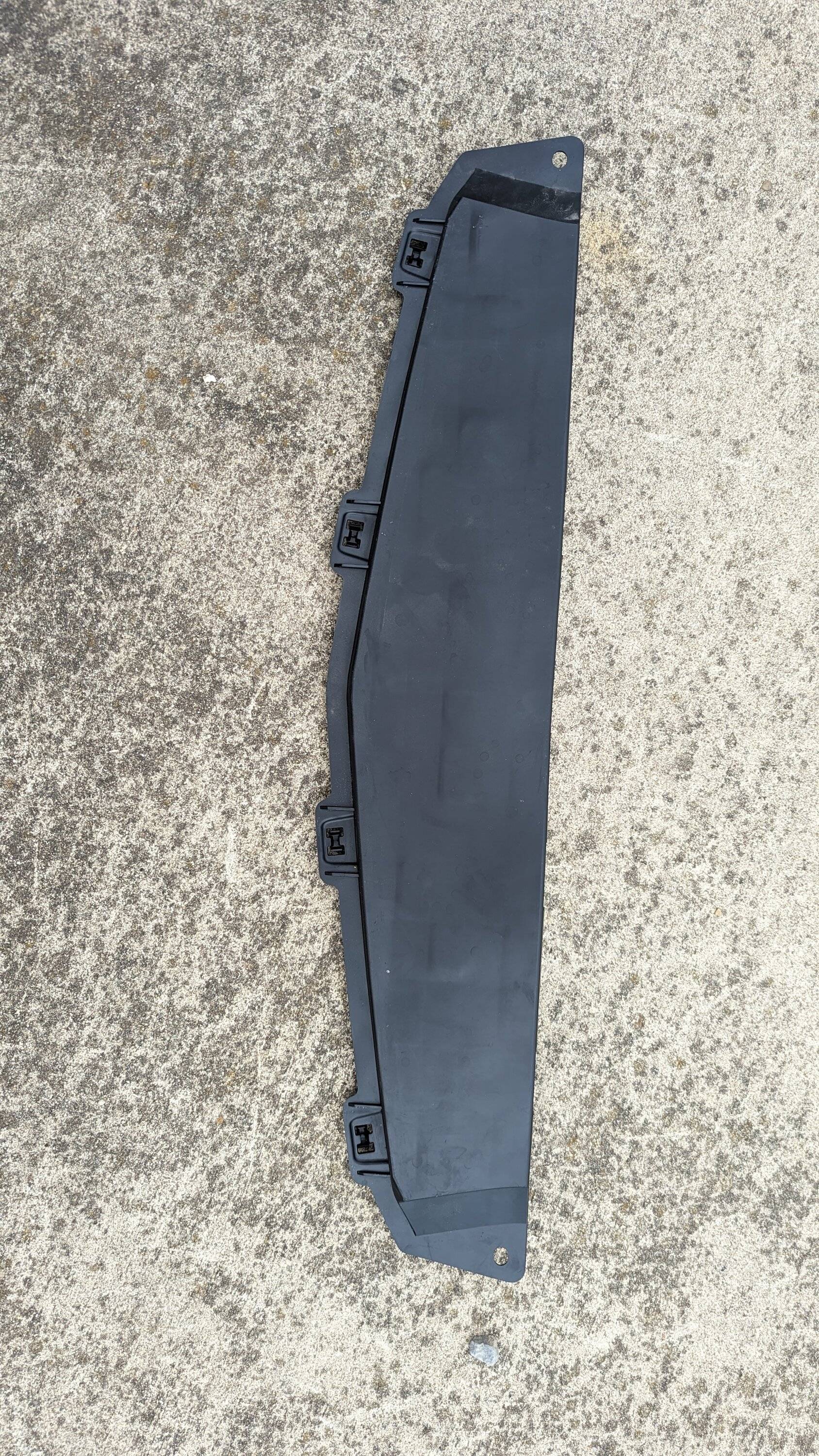

Did you remove the original intercooler air dam ? Sides and bottom rubber piece? This is required other wise the bottom portion will be pushed away and won't seat. FL5 instructions show only removing the sides .

Uggh, that's all it is??? I removed the sides, but not the bottom. Does it look awful removed though? That's a big space to leave open without that cover. I can see were its rubbing, suppose I could trim it.

Yeah you could trim it or maybe make it thinner to fit underneath.
I don't think it looks.verry noticable with it gone .
