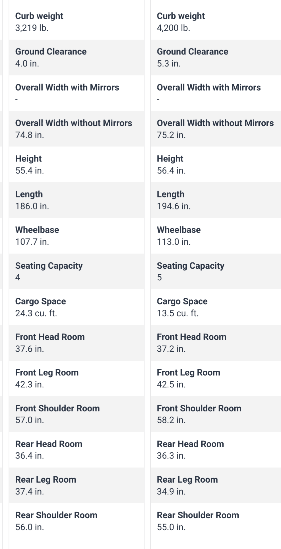

Also interested in hearing about your springs. ITS already has .8" less ground clearance than FL5, a 1" drop will take you down to 3", which is pretty low.
Which is why it already comes with speed bump warnings.
3,420
2,892
I thought it seemed lower but the FL5 ride height isnt posted. ITS is also slightly wider
