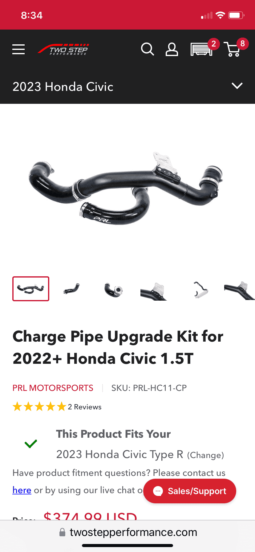

Did you hook up any charge pipes yet? It says the PRL ones will work for both 1.5 & FL5. I'm trying to do everything at once that would require removing the bumper if possible.
It's about time you start your ongoing build thread. 😎🙏🏽
3,434
2,922
Are they released? I wanted them but they weren't available.
I'm asking them in the chat now & will confirm asap.
Seems some of their items say they don't fit but do & vice versa. Just like they still have the PRL front pipe shown with both corrugated & woven steel still.
That's the 1.5T parts. I don't even see the FL5 charge pipes anymore. They were $1 coming soon.
Yeah I figured as much with the 1.5, but then it said that it fits. 🤷🏽‍♂️ Probably still waiting on those then but I asked anyway & awaiting a response still.
The FL5 kit has aluminum cast pieces that go along with the pipes from what was shown earlier. Not sure why the whole listing is now pulled.
@PRL Motorsports
I did send photos of my install to them but didn't hear anything back.
@PRL Motorsports
They just emailed me back to confirm no charge pipes for the FL5 from PRL yet.

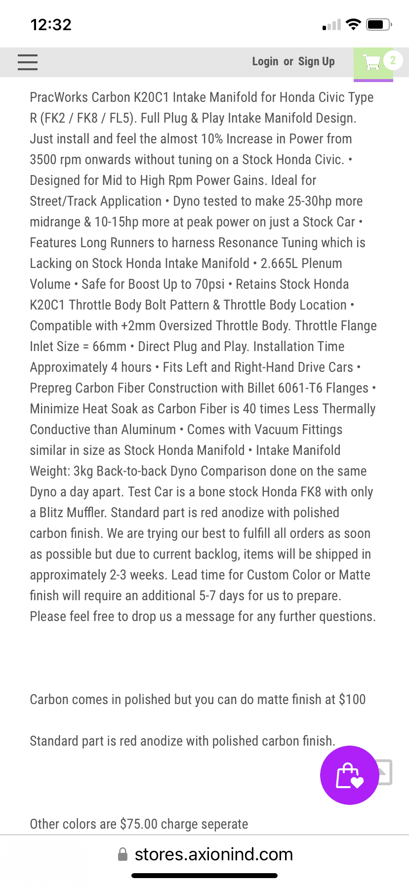

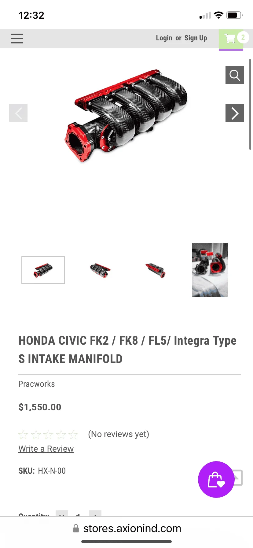

Is there any reason why I shouldn't add this to the cart as well? Is there another manifold with the same efficiency for less price?
It would look friggin' cool too, though. 🤔
