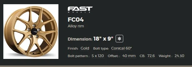

Awesome, would these make any sense on the Type S ?
Acura Integra Integra Type S Winter Time : Should I get 18" wheels or just stay with the 19" for winter? Any pros and cons? Capture d’écran 2024-09-27 080058
Acura Integra Integra Type S Winter Time : Should I get 18" wheels or just stay with the 19" for winter? Any pros and cons? Capture d’écran 2024-09-27 080140
Is there anything I need to look at to make sure it fits with the brakes?
Thanks for helping !
Those will probably be fine. You will need hub centric rings (stock center bore is 64.1mm) and if you don't want your TPMS light constantly on you'll need sensors. What's nice is you don't need any special tools to recalibrate the sensors - just drive for a few miles (or I guess km since you're in Canada) and they should automatically recalibrate. You'll also need new conical lug nuts so they seat properly.
Plug your tires into a wheel size calculator online to compare the difference in diameter and speedometer error at different speeds. For my winter setup I went with 235/40R18 which had the smallest speedo error I could find when going to 18s - it's less than 1% difference at 90mph.
My wheels are 18x8.5 Enkei TS-V. I have a few mm of clearance with the brakes and haven't had any issues.

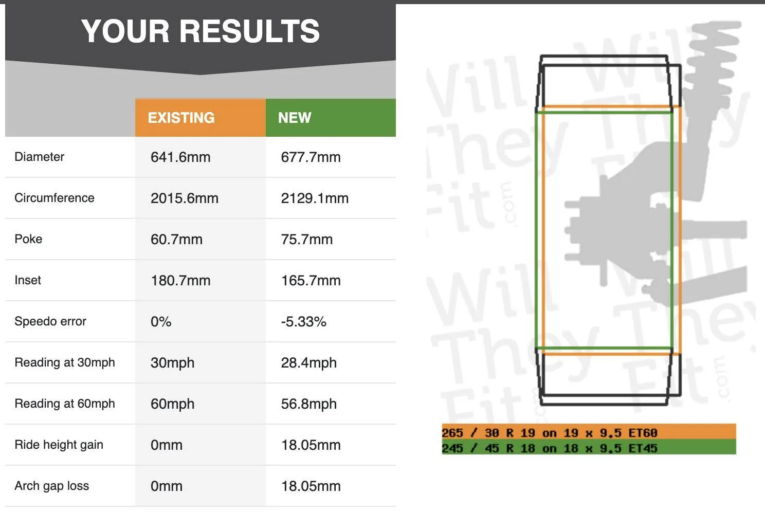

I think ITS has autocorrection with the speed difference. I ran 245 45 R18 Blizzak for winter, the speed is quite accurate compared to GPS data.
3.2mph seems pretty significant, especially when you add that up over many miles. Correct me if I'm wrong, but your picture looks like it's from a calculator website, right? What are you using to measure GPS speed?
How would the the car even go about autocorrecting the speed? The only thing I can think of that the car uses to calculate speed is the rotational speed of the wheels/rotors. There's nothing to tell it the diameter of the tires. Unless it's somehow using GPS data in conjunction with the wheel speed.
I used google map/apple map/WAZE. They use phones' GPS location to calculate speed, when I reach 60mph on highway the app showed the same

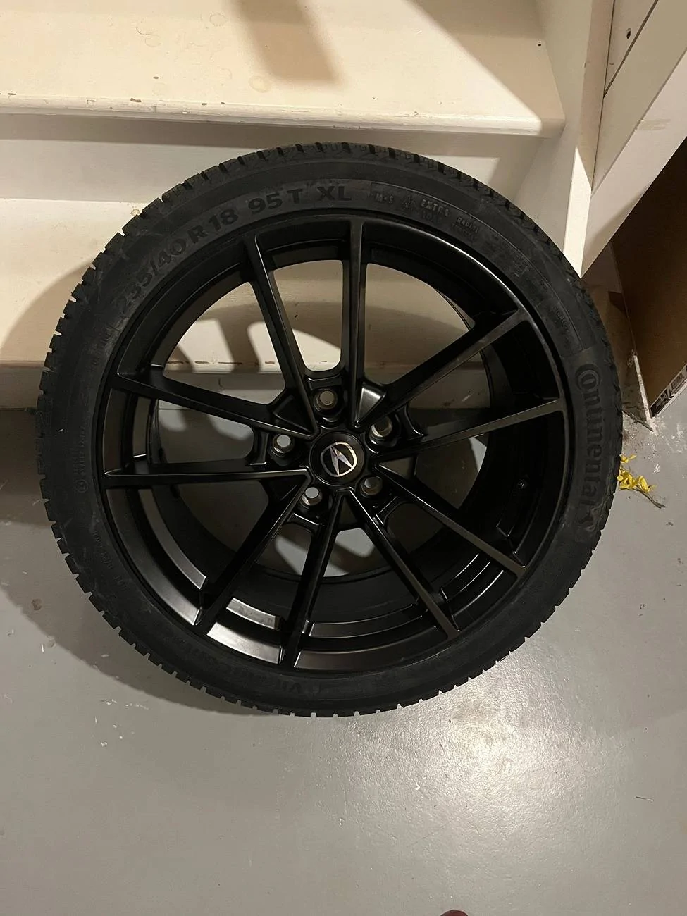

Just got my order from Wheelsco - they ship throughout Canada. $2300CAD delivered minus a $100 rebate for some nice looking wheels and decent tires. They've got several options on their site for ITS winter wheels and tires. Still need to get OEM TPMS fitted & rebalance since other forum posts didn't have anything good to say about their aftermarket ones.
Thanks for the info. Where did you get the sensors from?
So I guess you ordered the wheels and tires not mounted and went to a garage to do this so you could get the sensors installed first?
No... I love making problems for myself. Was >$800 cheaper than going to Kal Tire so the plan was just to eat the cost of having the dealer add them, remount, and rebalance. I'm sure you could probably ask them to ship unmounted if you wanted to be smarter than I.
