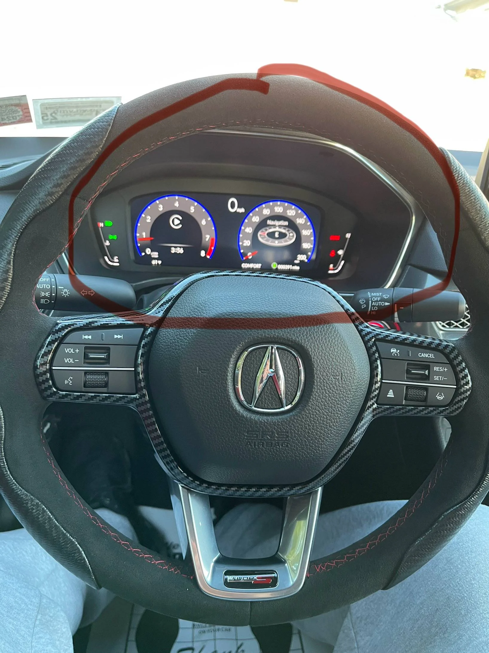

Is this area around the speedometer the same as the type r or 11th gen civic ?

Acura Integra Is this area around the speedometer the same as the type r or 11th gen civic ? IMG_1742
The plastic area around the Speedo , is it the same as the 11th gen civic or fl5 ? I’d like to buy it in carbon .

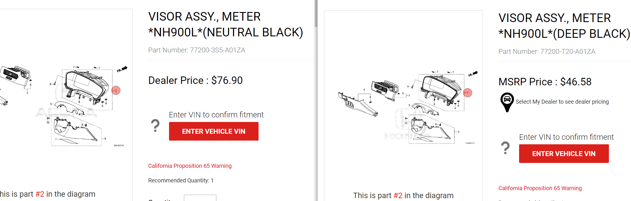

The ITS Bezel part number is: 77200-3S5-A01ZA ours has the chrome lining
CTR Bezel part number is: 77200-T20-A01ZA this is all black
Acura Integra Is this area around the speedometer the same as the type r or 11th gen civic ? BezelNumber

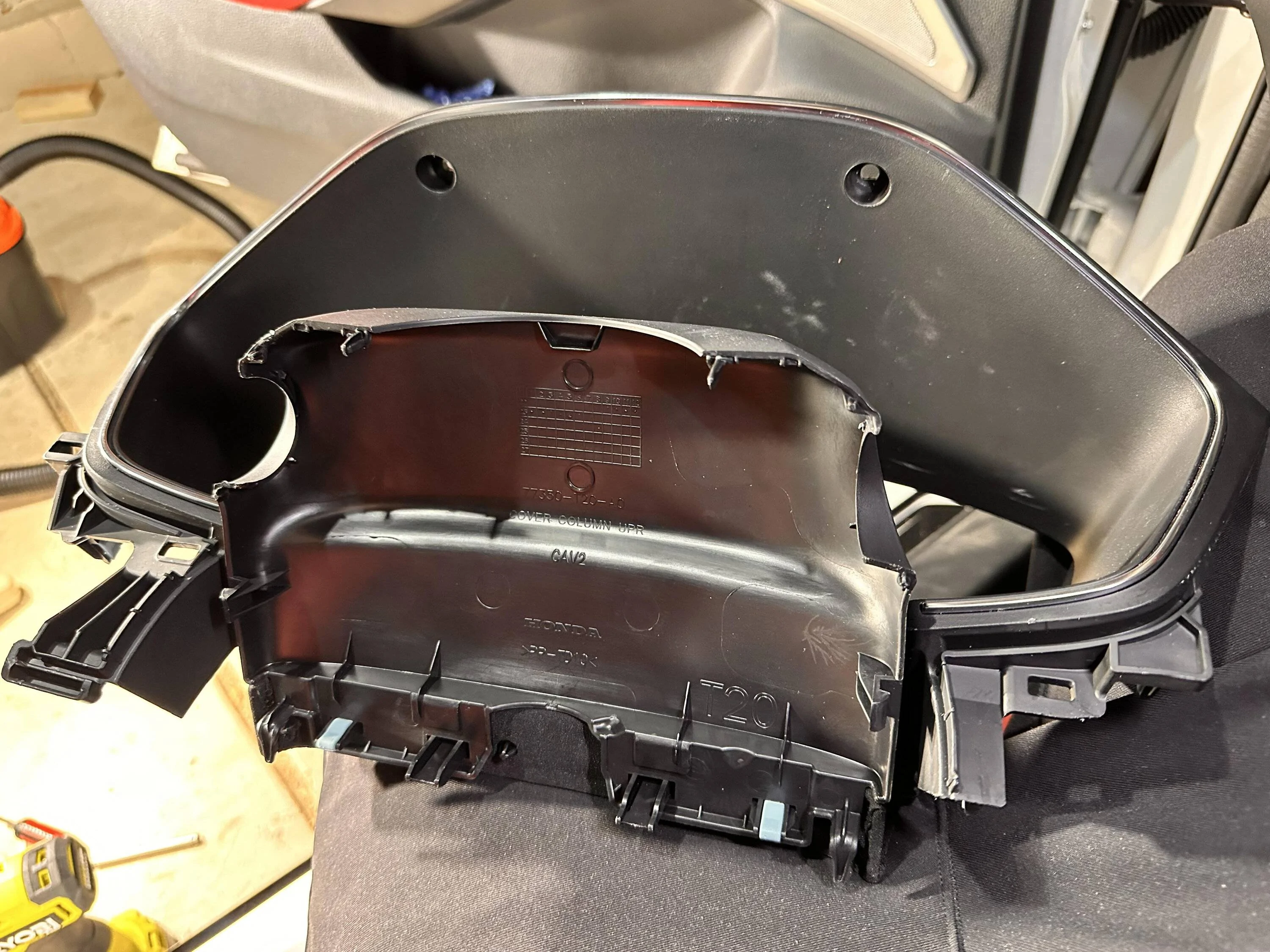

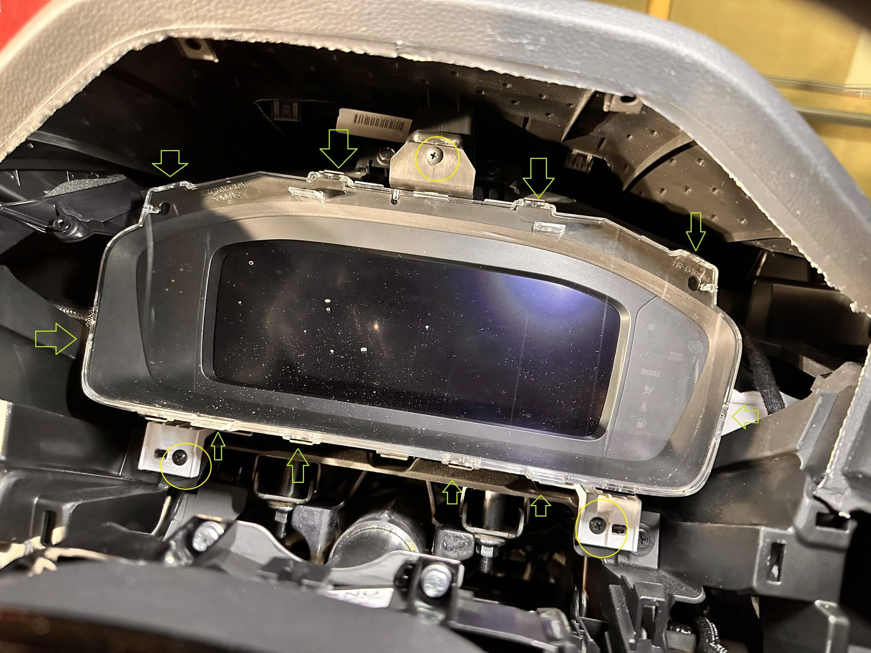

The diagram appears to look exactly the same. However when I replaced the glass lens I noticed a different shape:

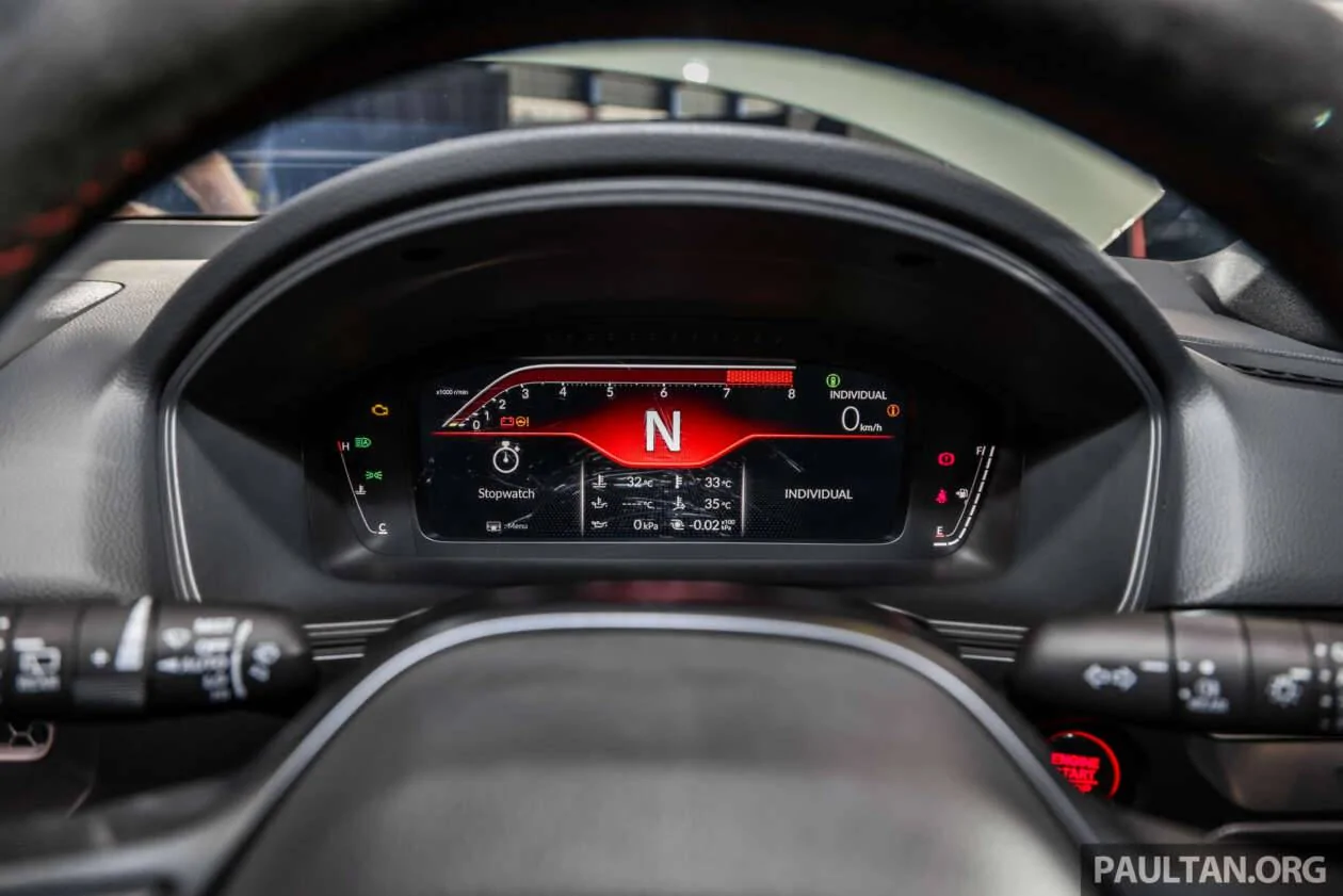

Here is the CTR:
Acura Integra Is this area around the speedometer the same as the type r or 11th gen civic ? 2023_Honda_Civic_TypeR_Launch_Malaysia_Int-6-1260x841
As you can see, the CTR bezel does not have the chrome lining. But it also appears to have a more curvature along the top. While the ITS is a bit more of a trapezoid shape.
I don't know what the dimensions are and I'm sure you can get the CTR carbon ones to fit but be aware that there might be some minor differences that could leave you with small gaps. The gauge cluster and lens are identical to the CTR however, but it does not attach to the bezel trim at all.
