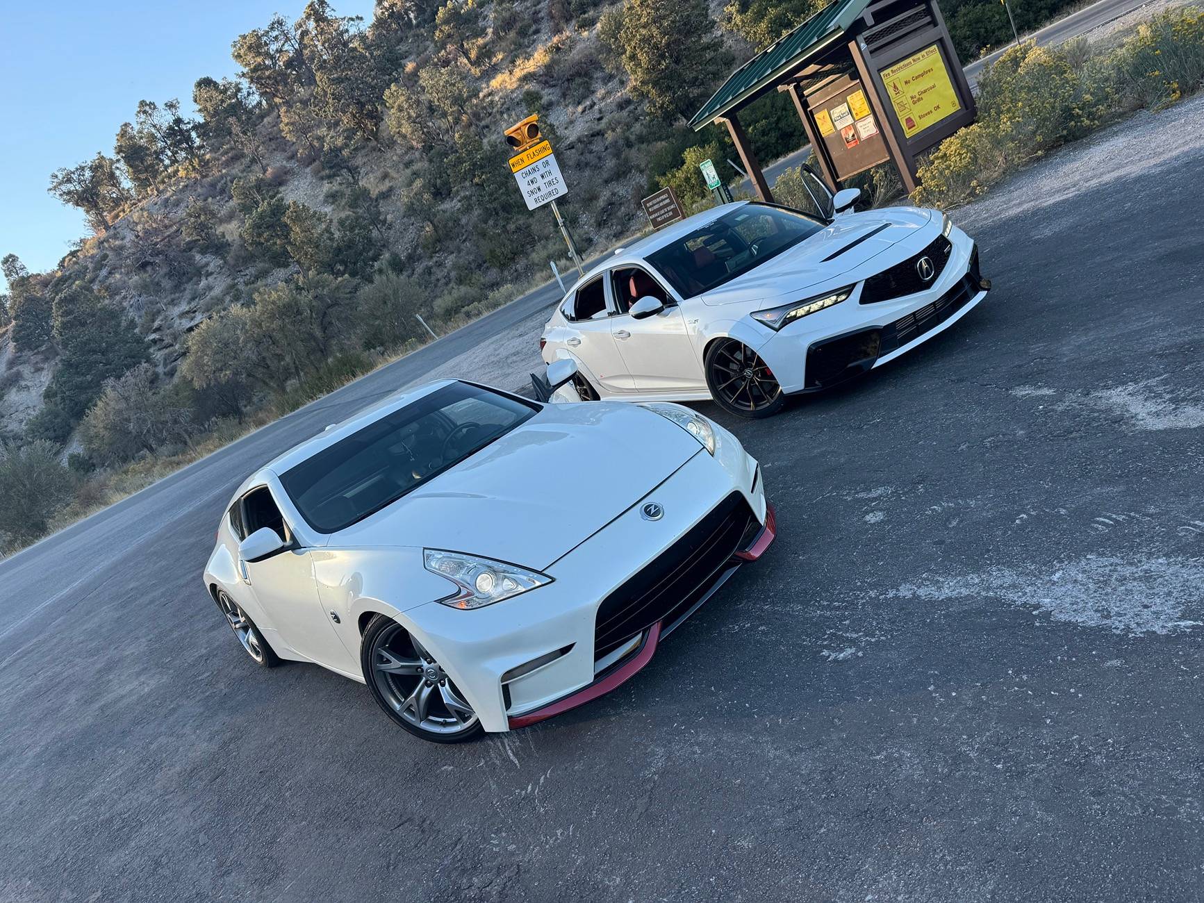

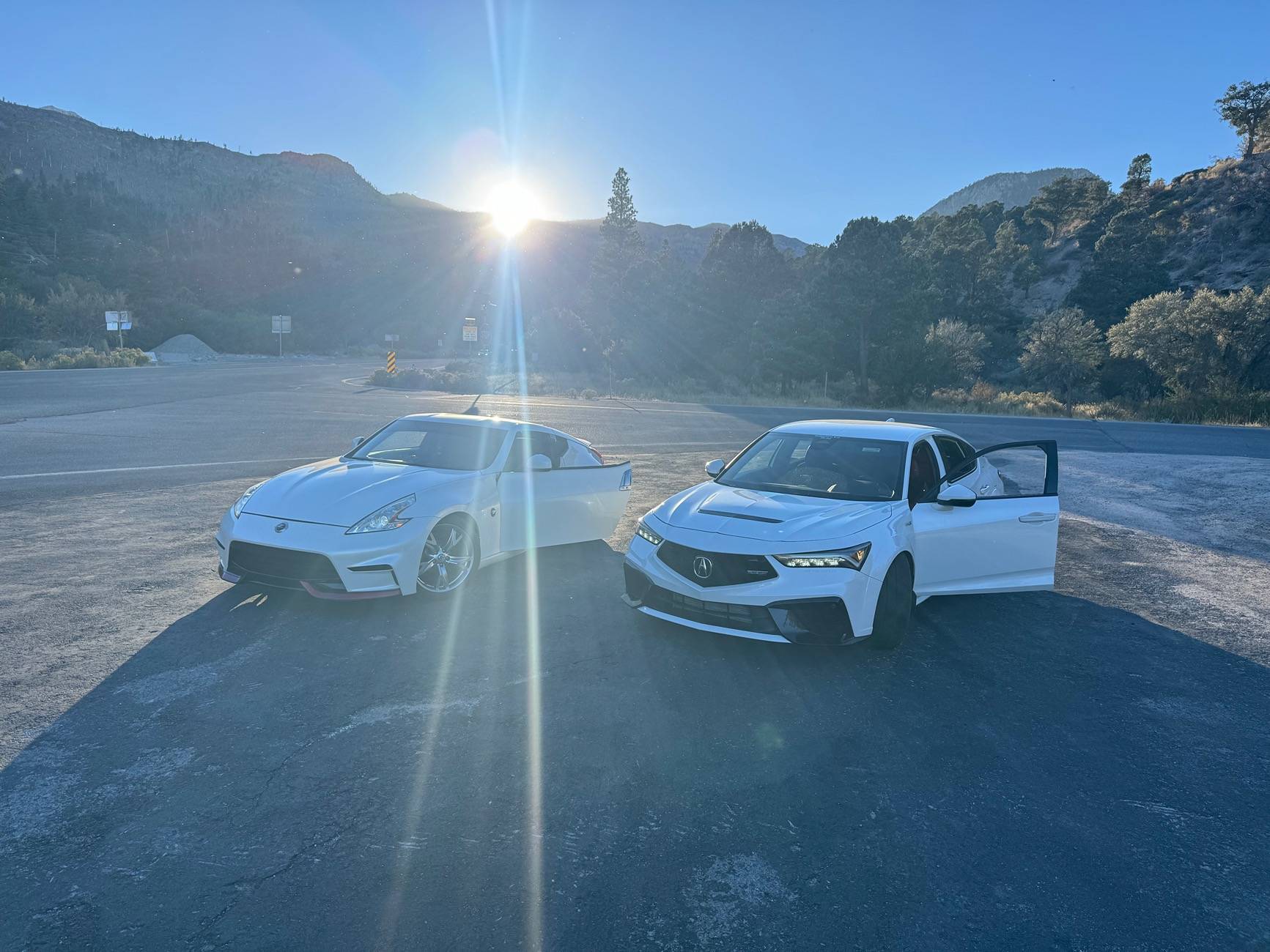

Hey, can't help with your original question, but do you have any pics of your wheel and tire setup? Just curious how 275/35's look on a lowered car. Are you running spacers? Thanks and best of luck on the original issue.
Thank you, and here’s the only pictures I have with the new tires
I have no spacers, I wanted to go 285/35r19 but since I wanted to add spacers in the future I decided to not over do it so I won’t rub with the spacers I will be adding later on

Thanks for the pics. Love those meaty setups. I'm really interested in 275/35 with a plus 45 offset, on a stock size rim, with the eibach pro kit. Terrified it will rub. I may have to just take the plunge. I have 275/30's now, +45 offset and I'm good. I know I'm adding like 5-6mm of sidewall with the 275/35, and throwing the speedometer way out of whack, but what the hell right. There are so few 200 TW tires in 275/30 that I may have to risk it or go back to 265/35 for a bit more wiggle room.

You’ll be fine 100% I have the Sportline eibach springs which drop it even more than the pro kit, so you’ll have even less chance of rubbing with the pro kit
