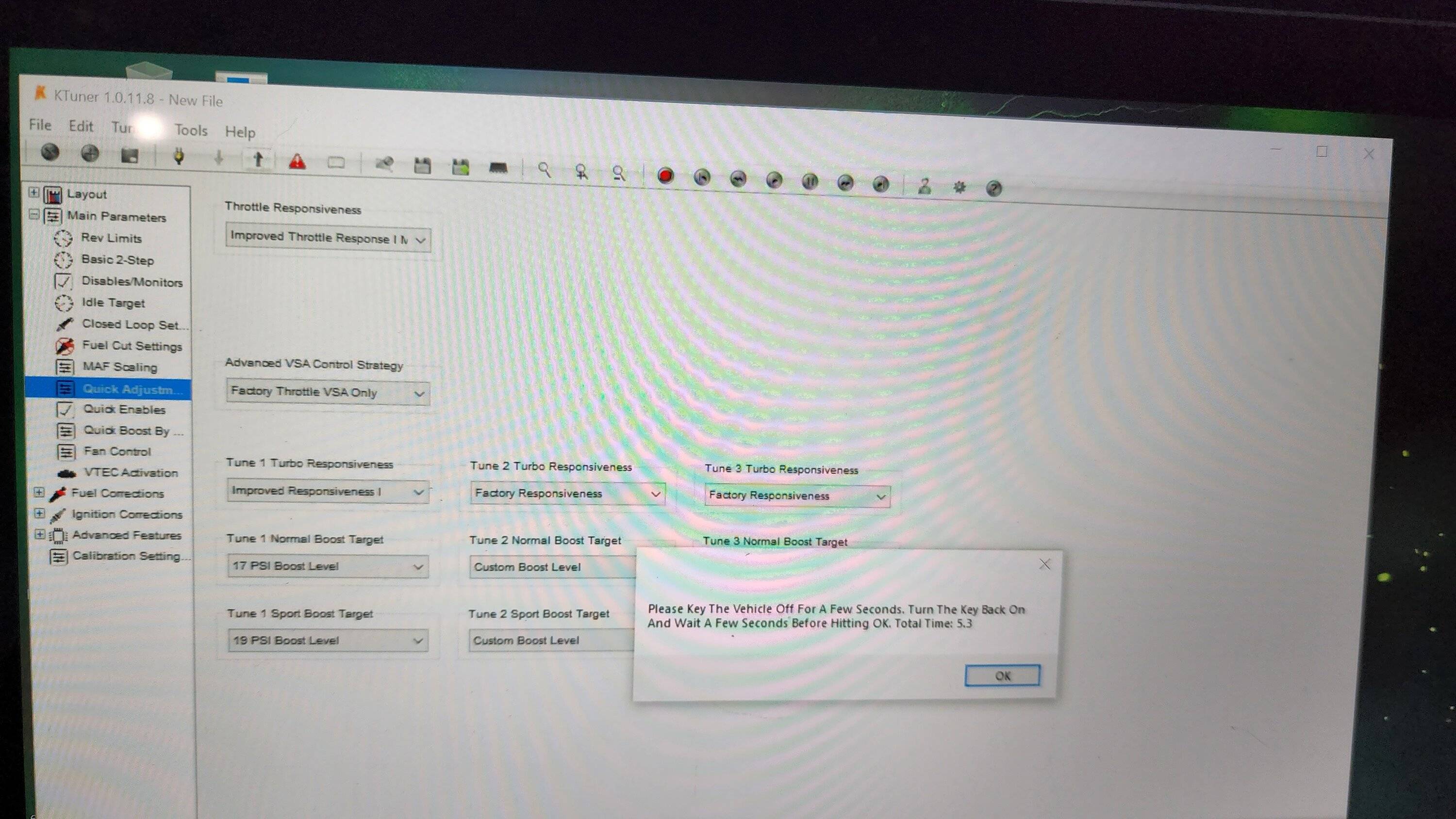

If you're starting with one of our included tunes you have access to all limit tables in the software if you want to see how they're setup in the tune. We don't setup boost by gear by default. You can look at a datalog to see what the target was at any given point.
So I figured it out FYI. For whatever ever reason when I change the custom boost target for sport mode it seems to not be loading correctly and it's setting the boost target to whatever normal is which was 17 in my case. I went back to your 16.5/18 without changing anything and now I see 17.9 and 18 in sport mode.

I'm not seeing what you're seeing there, Sport is indeed being changed with your selection, but I did find an issue on the Tune 1 Sport settings where anything above 19 that's chosen is one off in the list because of a 19.5 option that was added so I am fixing that and will issue an update.
Thanks for getting me to take another look!
It was tune 1 sport settings where the issue was for me. I can't remember if I chose 19 or 19.5 for sport but whatever it was it just wasn't hitting thr target I was asking for me. I left the options back on default and now I see the 18psi I'm targeting. Before I couldn't get past 17. This is a pic from this morning before I flashed to default 16.5/18 where I'm flooring the car but boost won't go past 17.

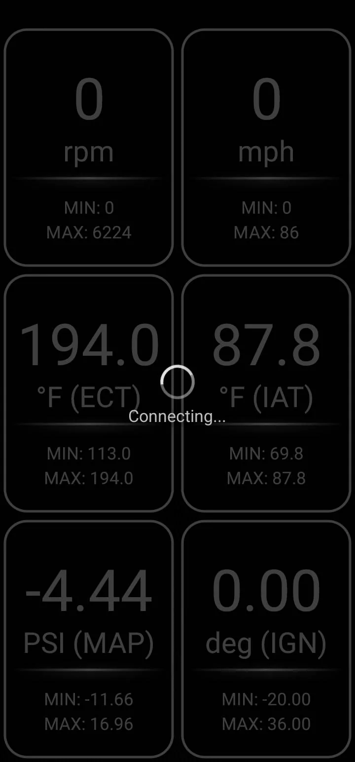

Acura Integra Ktuner for 2023 Integra is live! 20220731_195331
Flashed with new update. Tomorrow I'll check to see if it worked for me

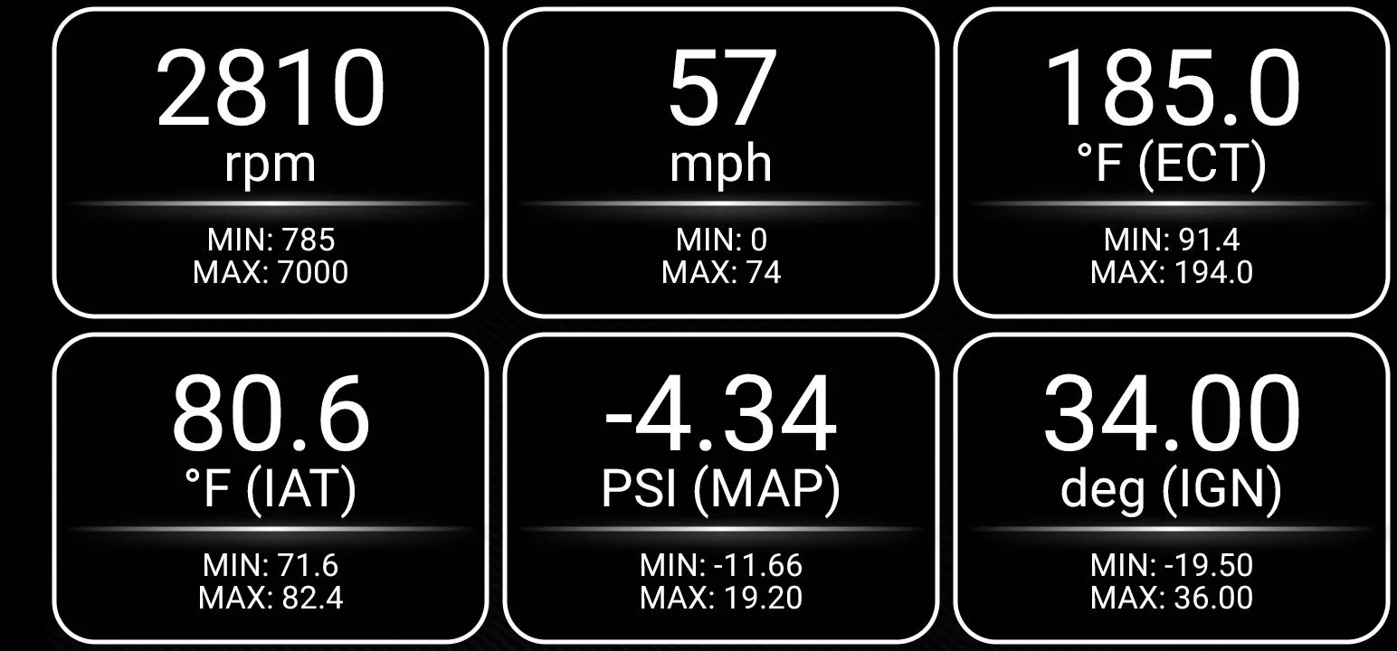

Acura Integra Ktuner for 2023 Integra is live! Screenshot_20220801-103744_TunerVi
Don't think I hit 7000 during this run, not even sure if it allows you to hit 7000 but who knows. But I'm getting 19 Psi. 1st and 2nd gear still a little lower with max boost target at 17.5 to 18psi and then 3rd and 4th see 19. Either way car feels amazing.
