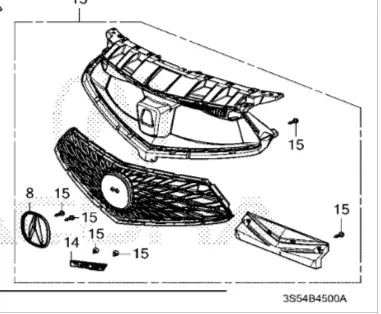

I saw you deleted the type S badges on the rest of the car, is it possible to do it on the grill as well or is there a rectangle there underneath is?
The Type-S emblem in the front grille is held on by two small screws that attach from the rear of the emblem onto a mounting plate that is part of the assembly. The emblem has the threads on the back of it to accept those two small screws....

#14 is your emblem and #15 are the screws.

Thanks for the insight. Man that’s annoying though. The one emblem I don’t like is of course the hardest to remove haha.

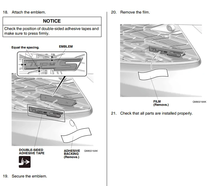

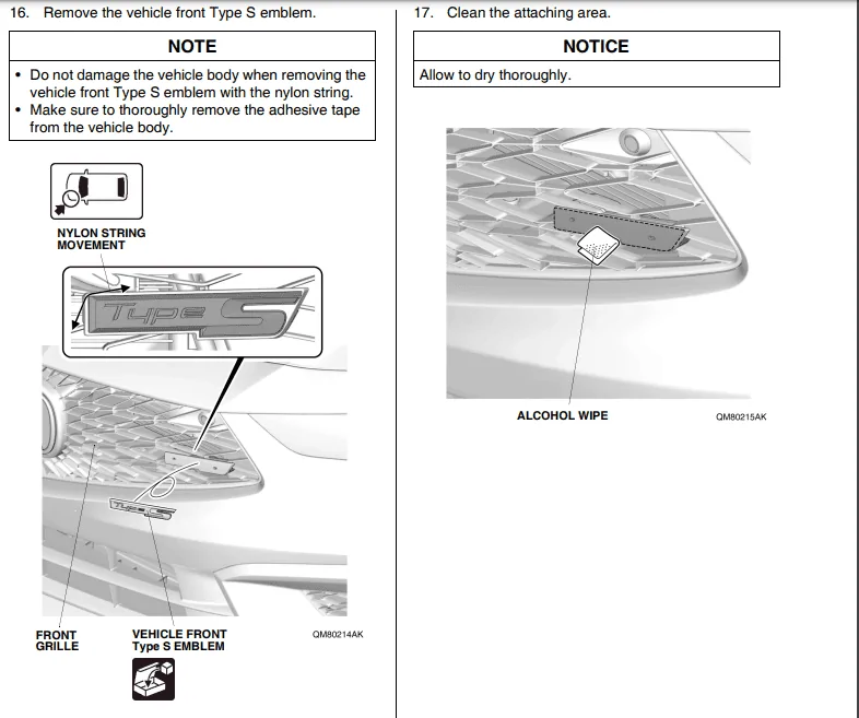

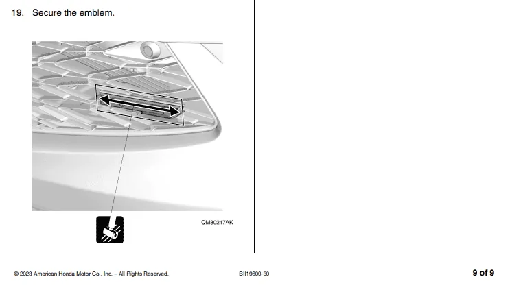

These are the installation instructions for the black Type-S emblems...I've only included the pages for the front emblem. Hopefully this helps the community get a better understanding of how the emblem is affixed. As shown above in the diagrams I posted, the emblem is attached to the front grille with two small machine screws.
If anyone wants to remove the whole emblem, you'd access those screws from the rear of the grille and viola. If you're wanting to only remove the Type-S insignia......
It's basically the same procedure as the rear emblems on these cars, except you leave the "base" potion on the car and attach the new black Type-S logo to that. The rear emblem instructions advise you to remove the whole base and then remove the emblem from that, attach the new black emblem then reinstall....so kinda the same thing here except you leave the "base" or mounting portion then do the same sort of shimmy shimmy ya shimmy yeah shimmy yeh with the nylon string....
