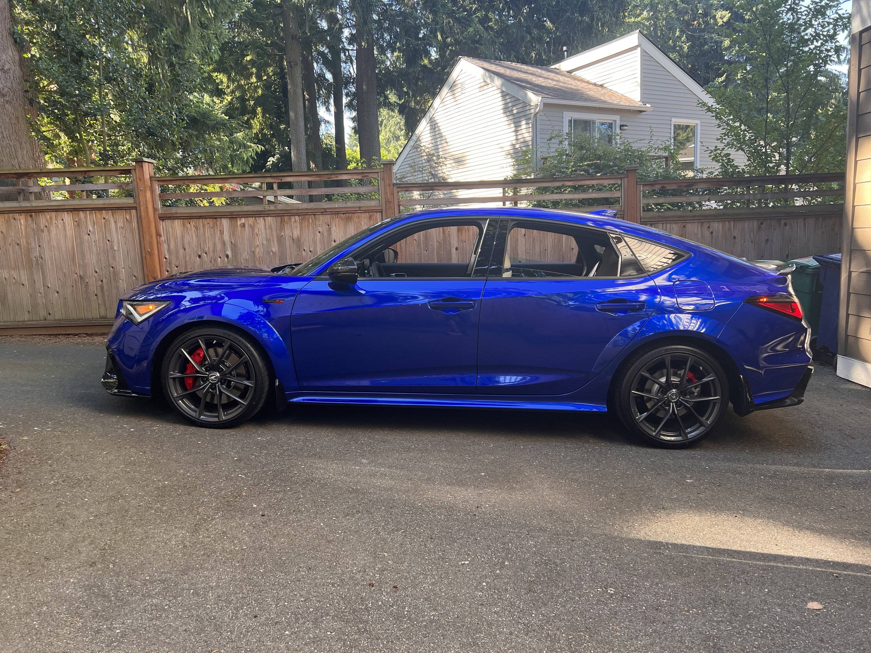

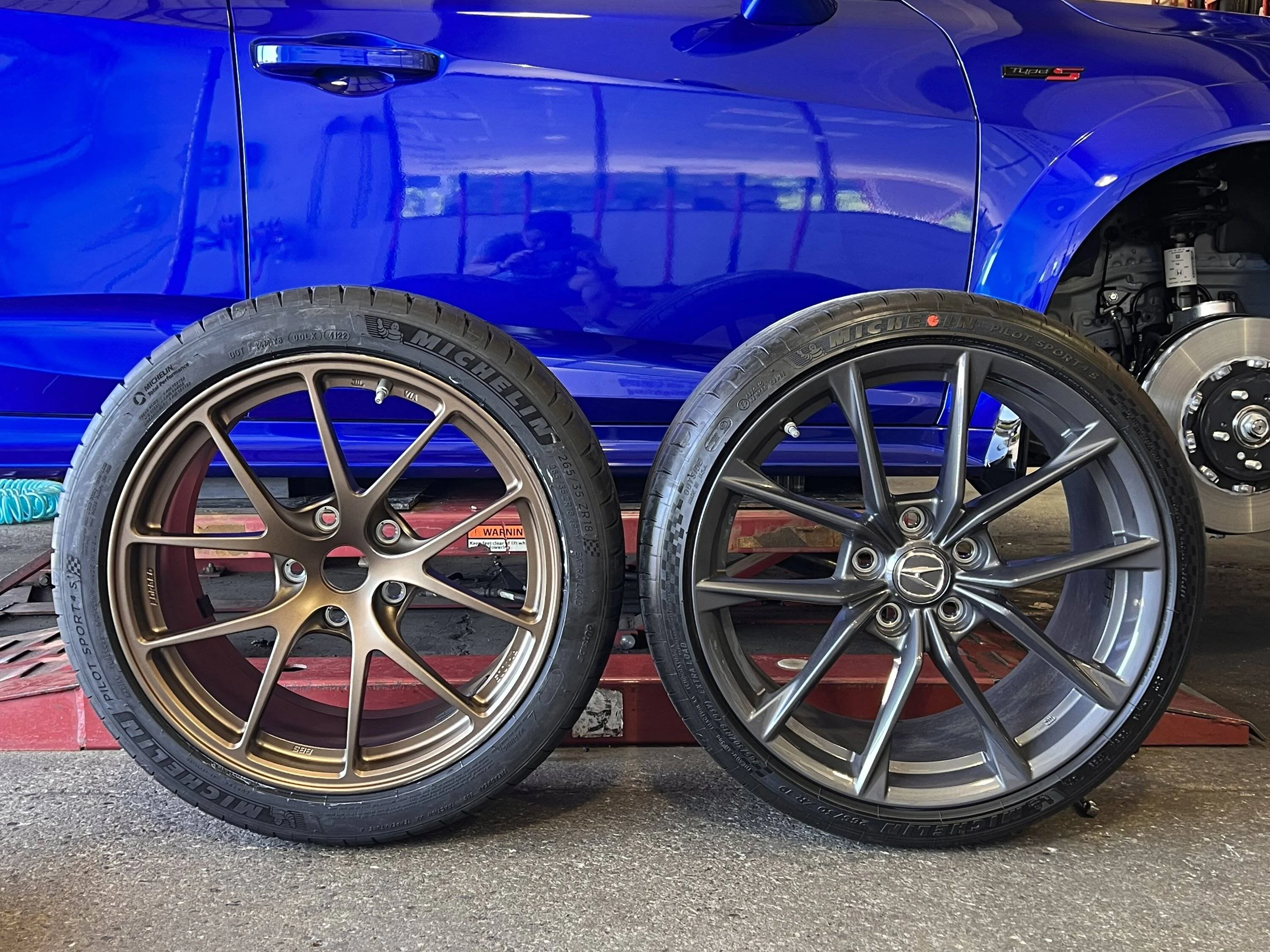

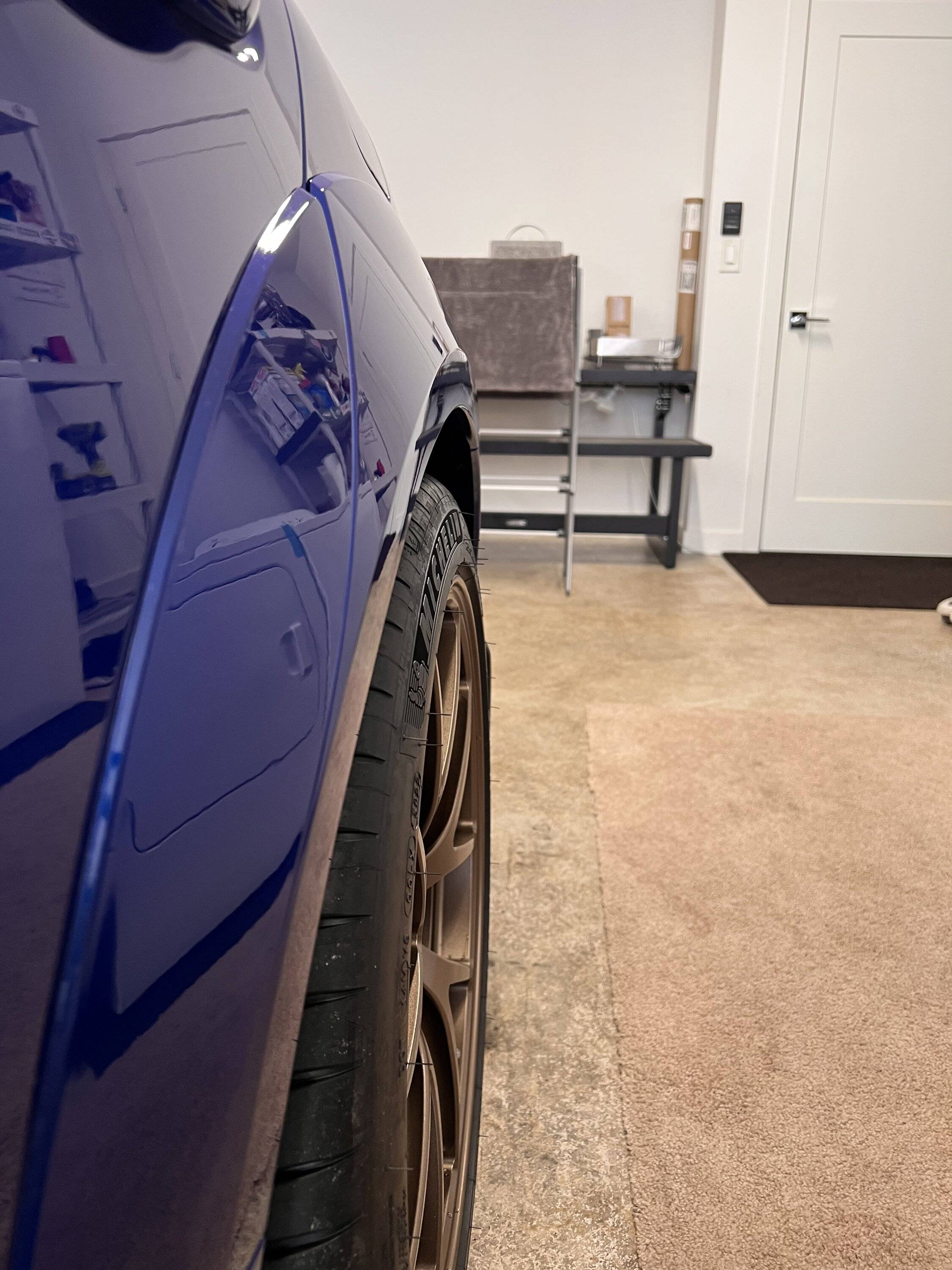

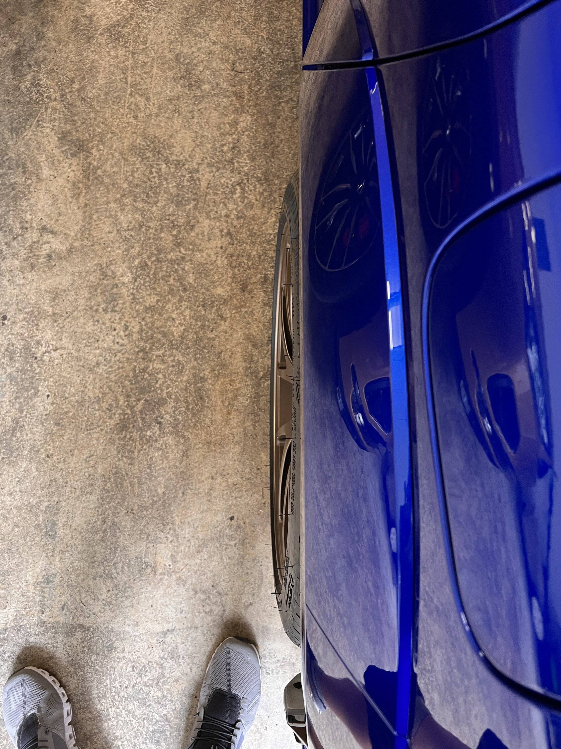

Wheels specs:
Stock Enkei wheels - 19x9.5 ET 60 5x120 Michelin PS4s 265.30.19
BBS forged - 18x9.5 ET40 5x120 Michelin PS4s 265.35.18
Overall diameter is dead on. Ride is much better. And I saved 14 lbs a corner of rotational weight. Sorry about the iphone pics.

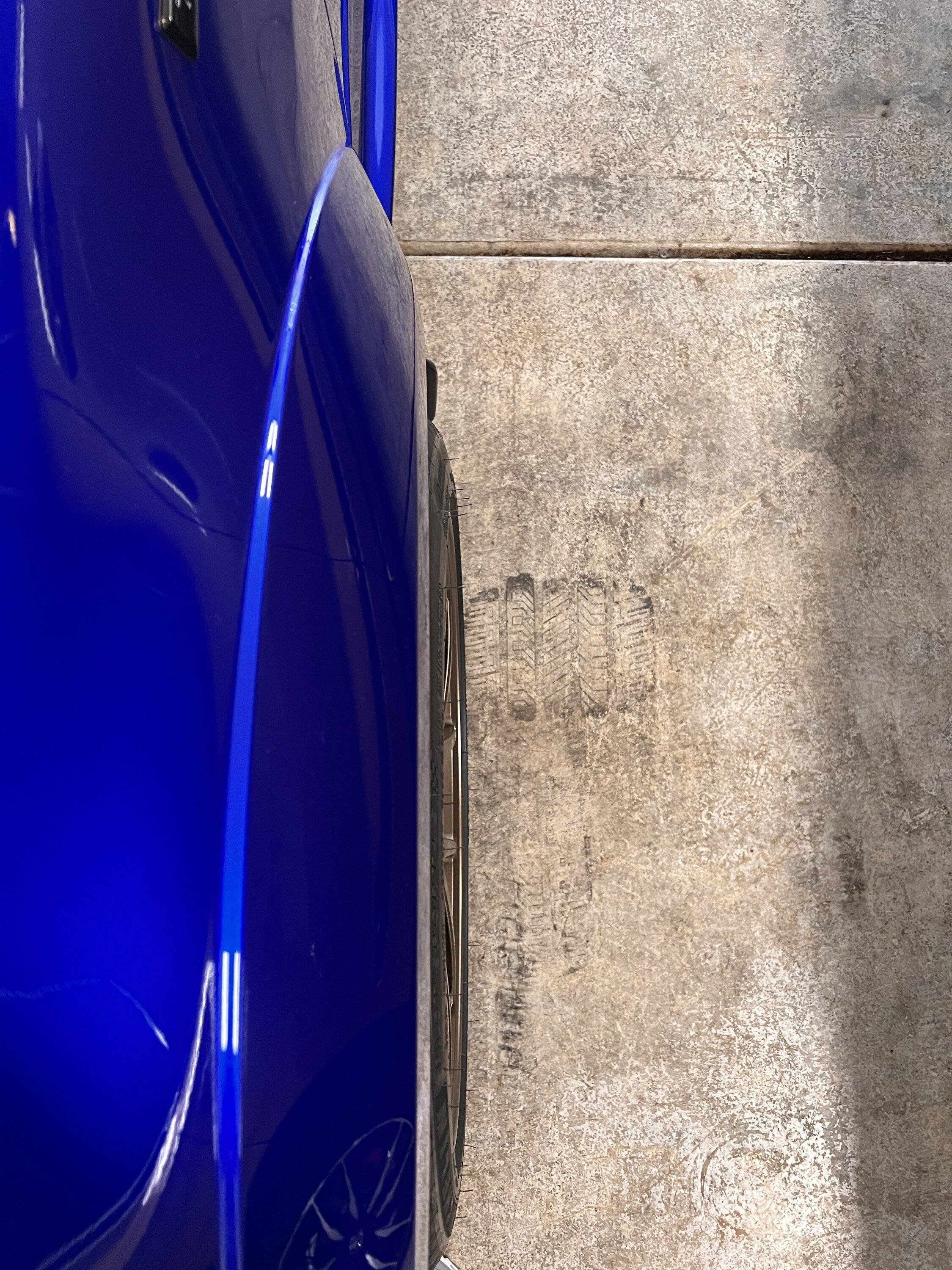

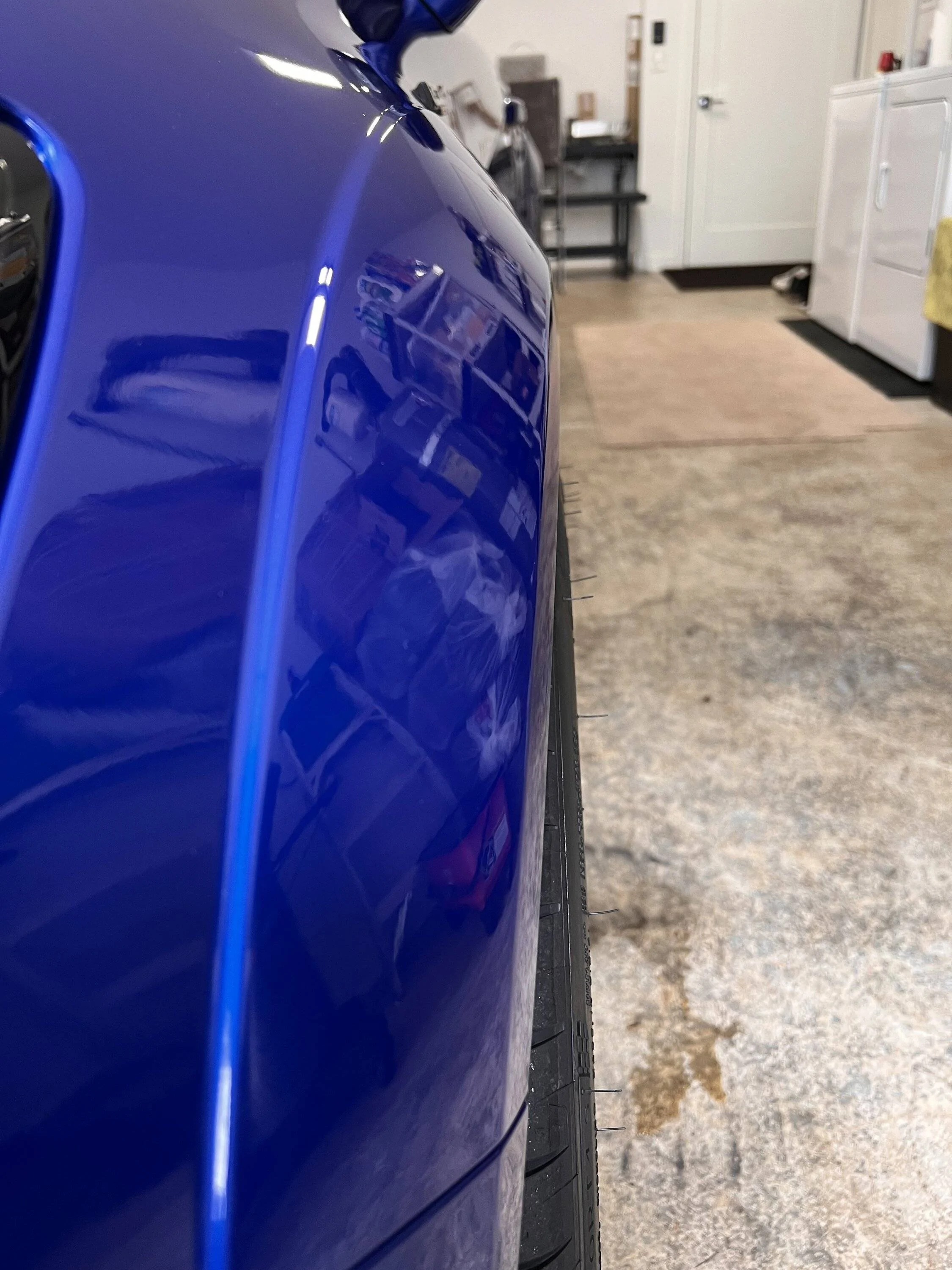

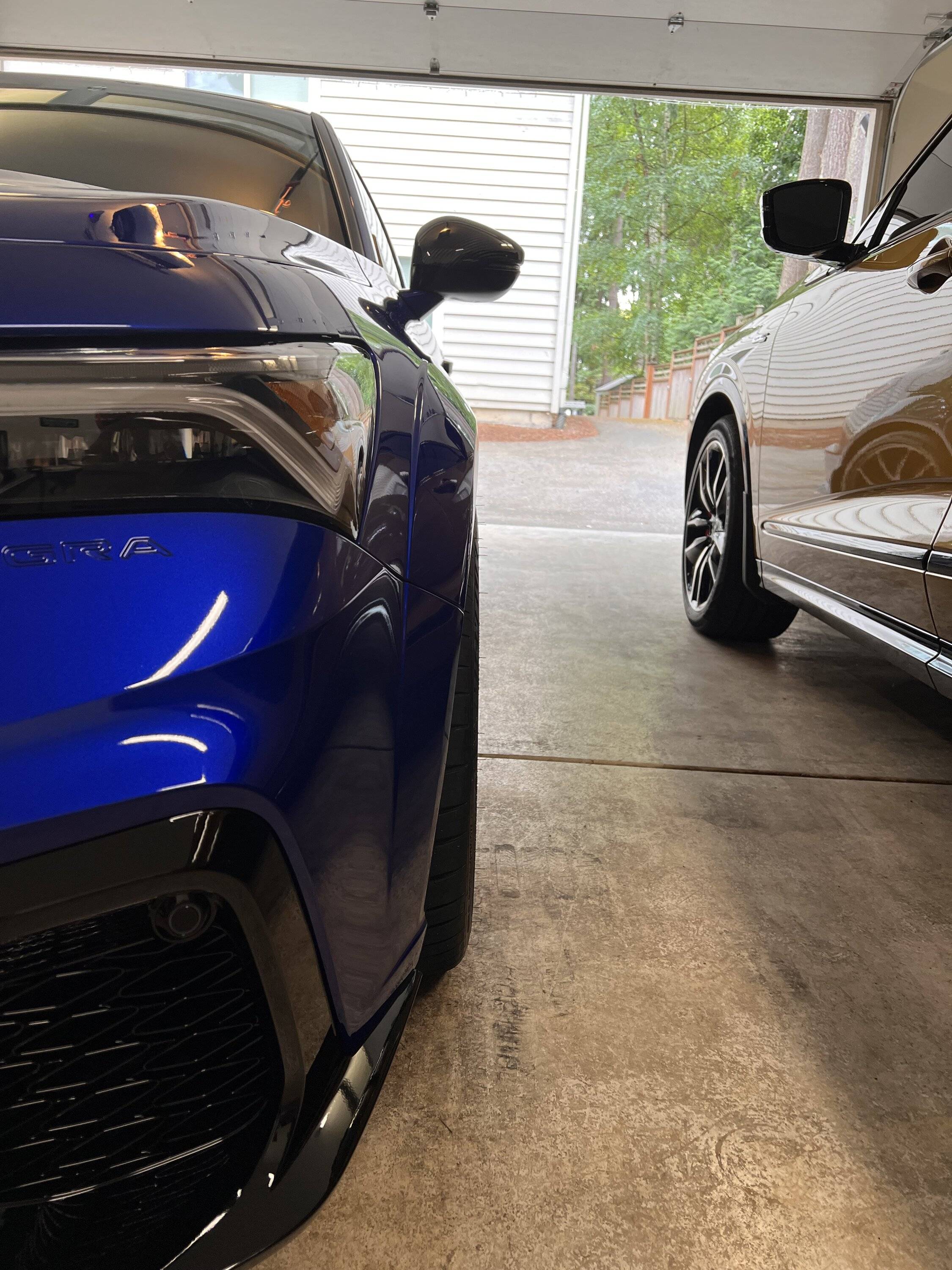

Acura Integra Let's talk Type S fitment. (wheels, tires & suspension) IMG_6934
Acura Integra Let's talk Type S fitment. (wheels, tires & suspension) IMG_6931
Acura Integra Let's talk Type S fitment. (wheels, tires & suspension) IMG_6946
14 lbs saved per corner? That is a ton!
What did those puppies cost?

Let's get a shot from the back of the fenders so we can see the poke :D -- this looks great!

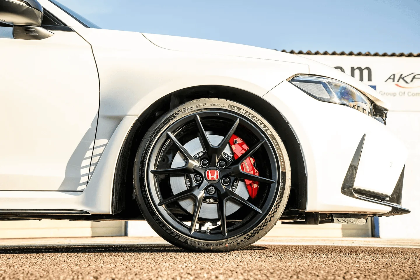

On thing I notice is online I'm seeing 4" of ground clearance. This seems pretty low. Wonder if this is different than the CTR.
Honestly this might be because of the front bumper, not the suspension. it looks like the chin on the ITS is more pronounced than on the CTR.
That was my assumption, but looking at the lines it appears both bumpers are pretty level with the rest of the car. Might just be the angle, but the ridge on the bottom of the bumper on the ITS looks larger maybe?
