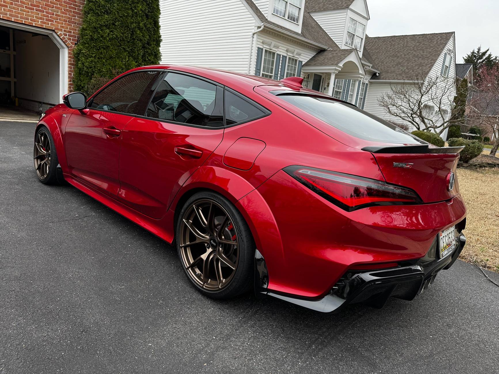

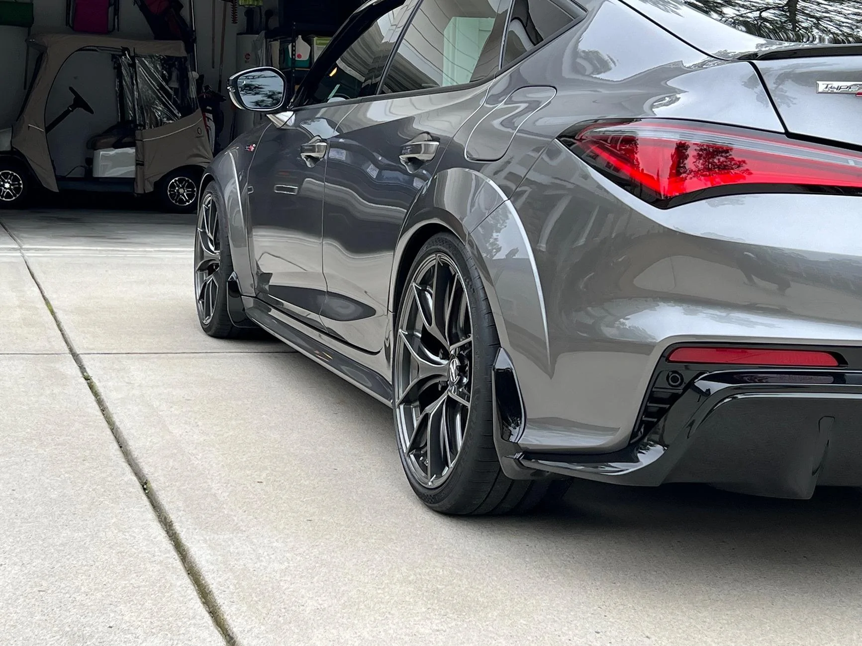

Ive been wanting to put spacers but also change the wheels so i can resuse the same sized tires but with better fitment
what offset would u all recommend. And
whats a good place to fine a set of wheels. ?

omg. That looks great. I have the same color too
just curious what is the stock offset?
what kind of drop is that. Looks good.
+45 offset is perfect IMO. Brings the wheels out to the edges without fear of rubbing, even with a drop. Titan7 or Apex is a good place to start looking.
1,452
1,210
Stock offset is +60.
+45 moves the wheel out 15mm. Same specs as stock otherwise, 19x9.5
Drop is Eibach Pro kit. The blue Type S above is Eibach Sportline (slightly lower) Either will work. H&R, Swift, Eibach all have good spring options.
Offsets in the +37 to +45 range look the best In my opinion.

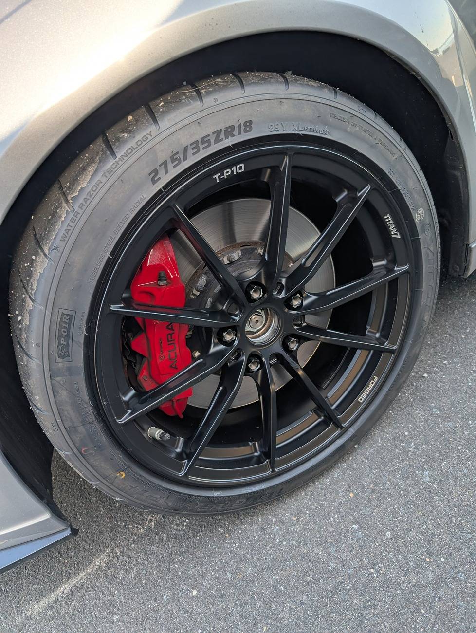

Titan7 P10 with Vitour P1 mounted on them. 275/35-18 on 18"x9.5" an offset of 53 for autocrossing.
Acura Integra New Titan wheels for Type S.  What offset and why Acura ITS_P1_TP10_PXL_20250319_211255974
Acura Integra New Titan wheels for Type S.  What offset and why TP10 with P1 Vitour PXL_20250319_205832429

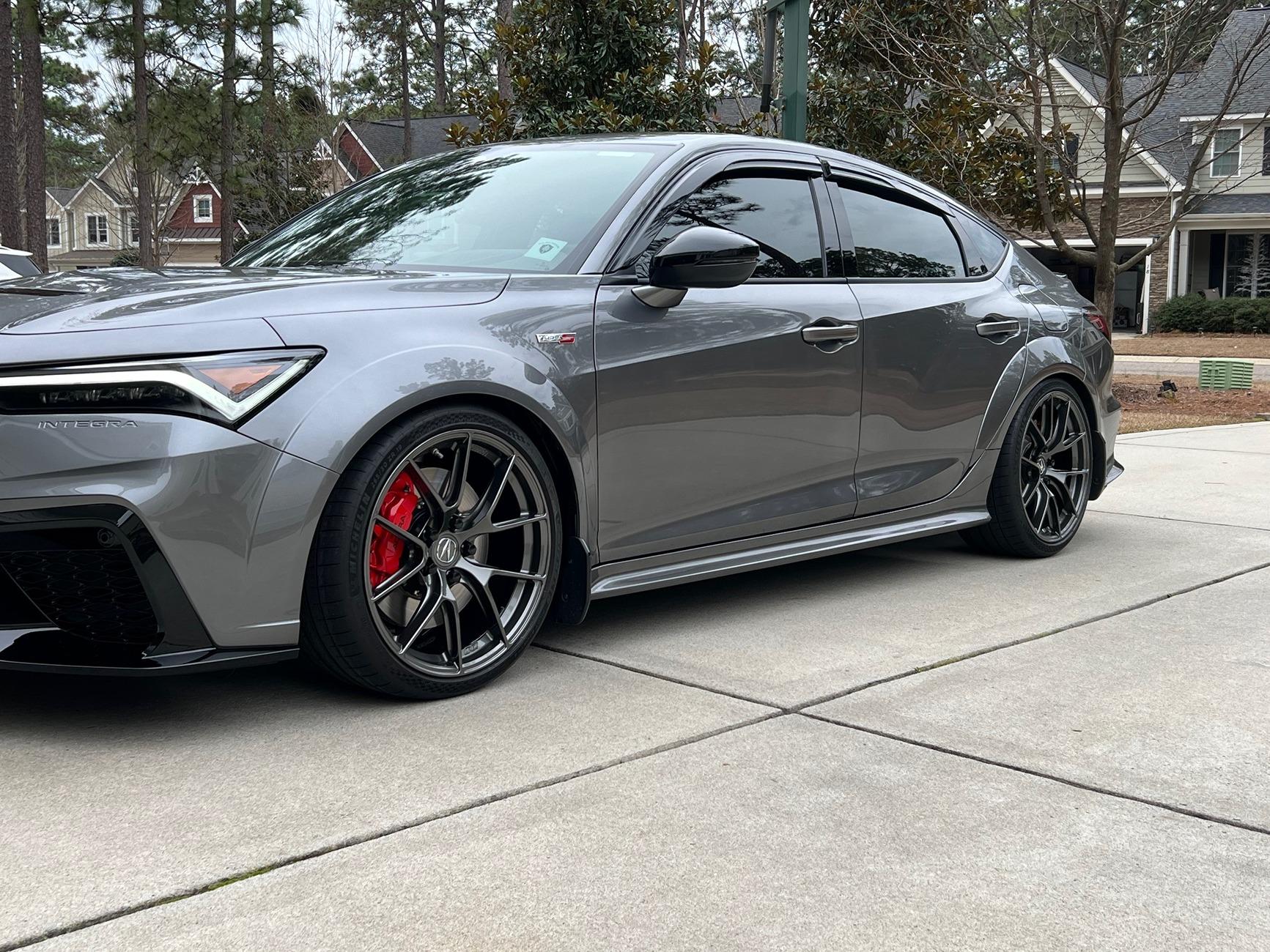

I'll chime in once again that whatever difference in steering feel/torque steer for shifting offset by 15mm is easily negated by the aesthetics.
Which is to say it's noticeable, but barely. Not enough to classify as "adverse" in pretty much any objective scenario. It's not something I think about every time I drive the car. Rarely, if ever.
But looking at the car is something I do every time I drive it.
Also when you lower the car you're going to change some of the characteristics of the suspension. The rear will have more negative camber than the front, which isn't necessarily a good thing on a front-wheel drive car. This was something I did notice, but only during actual performance driving, e.g., autocross.
I recommend considering some sort of camber adjustment, either to bring the rear camber closer to factory with rear camber arms or add negative camber to the front to match/exceed the rear, wither with adjustable lower ball joints or if you do coilovers, make sure you get adjustable strut-tower mounts. None are 100% necessary but definitely worth considering. (an alignment is 100% necessary after lowering a car, primarily to dial in toe so you don't prematurely shred your tires)
19 x 9.5 + 45 Apex VS-5RS, Eibach Pro-Kit.
Acura Integra New Titan wheels for Type S.  What offset and why 1742473675545-5t
