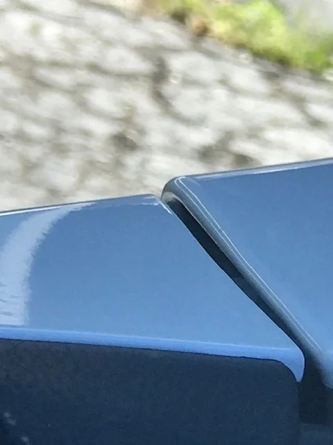

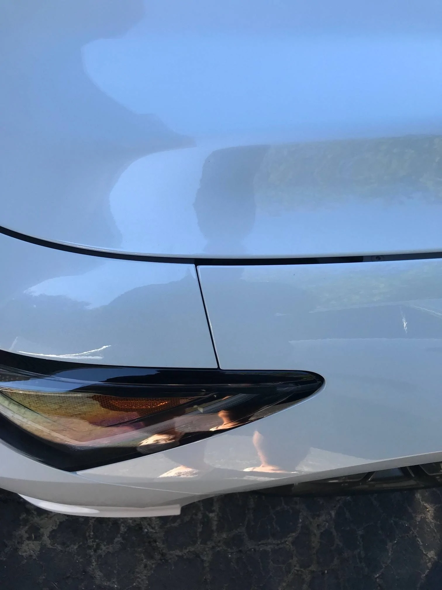

I have a weird hood gap. Not a big deal but definitely small issues with gaps and alignment of body panels in general. I think the Ohio plant is still getting the hang of it.
Acura Integra QC / Paint / Body Panel Gap Issues IntegraHood2

That top pic has an easy fix. Pop the hood. The closest clip on that upper bumper trim that sits high has a washer under it. Pull the washer and out the clip back in. It’ll sit even.
My drivers side was like that and is now perfect. The passenger side though sticks out some The washers fixed it some. But the fender is too low. That’s the main issue. The hood gap there is large. Just need to move the fender up a hair. One day.
