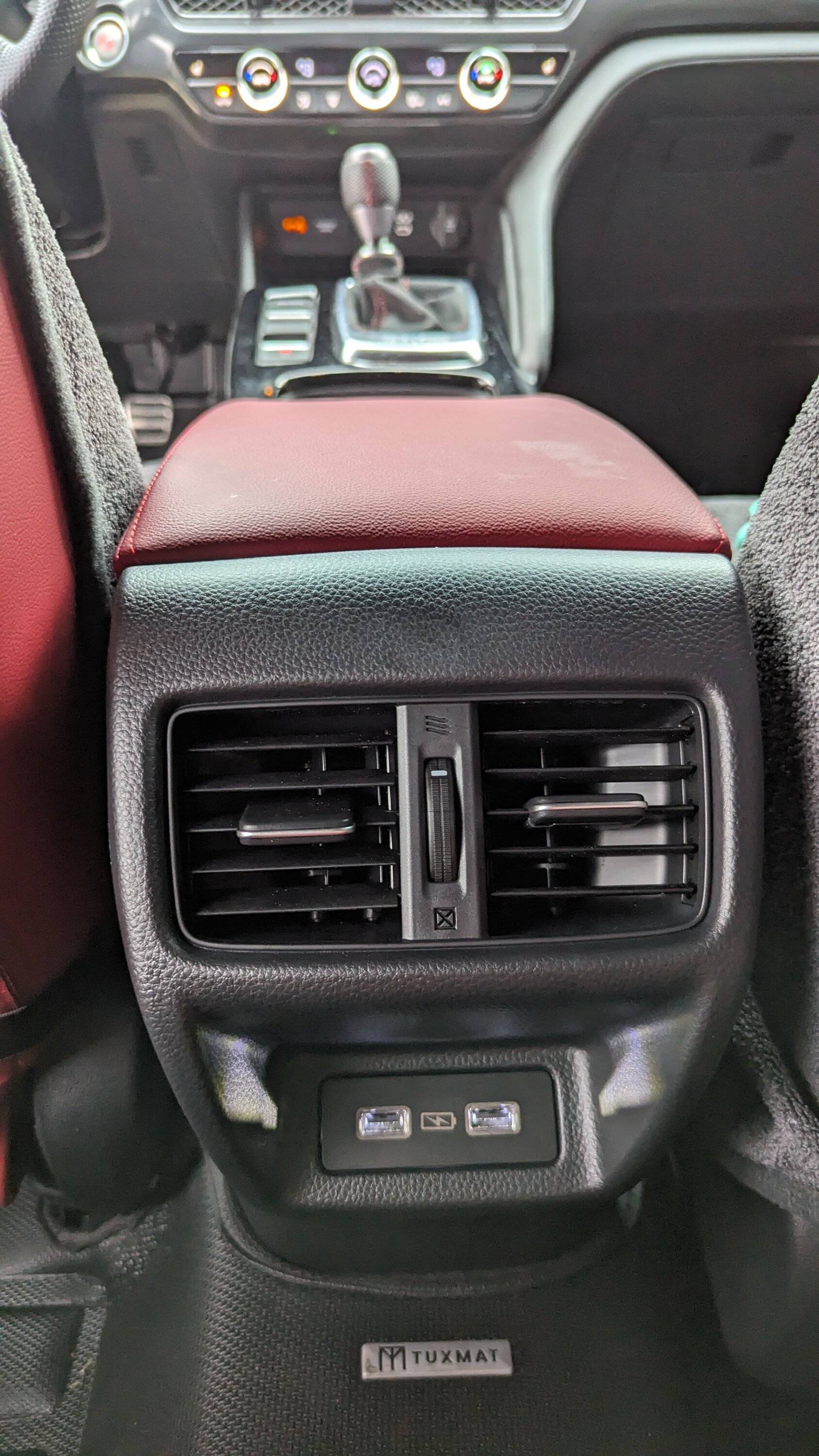

I have just done this install. You will need a additional parts for this install on a Manual transmission.
Console Box
Bracket 83419-T24-T00
Hardware for bracket (2 Qty) 90140-TR0-A01
Optional- Console Mat 83470-T43-J31
Optional Armrest-83405-T60-A21ZA(mounting bracket is different not sure if we can swap the top or not.
And kit from MIKSTORE with splitter(choose FL5 KIT from their drop downttps://mikstoreph.com/products/civic-2022-rear-ac-assembly-kit
View attachment Civic 2022 Rear AC Vent Guide.pdf
How does it work?? Blowing fire?

Lol. Yep feels pretty good. I kind of rushed but if I get.back in there I'd wrap all connections with aluminum tape to better seal them.

What was the total cost on all the parts and stuff you needed?

The box and bracket is $50 the vent and USB kit is $160+ shipping (10% off discount code available)

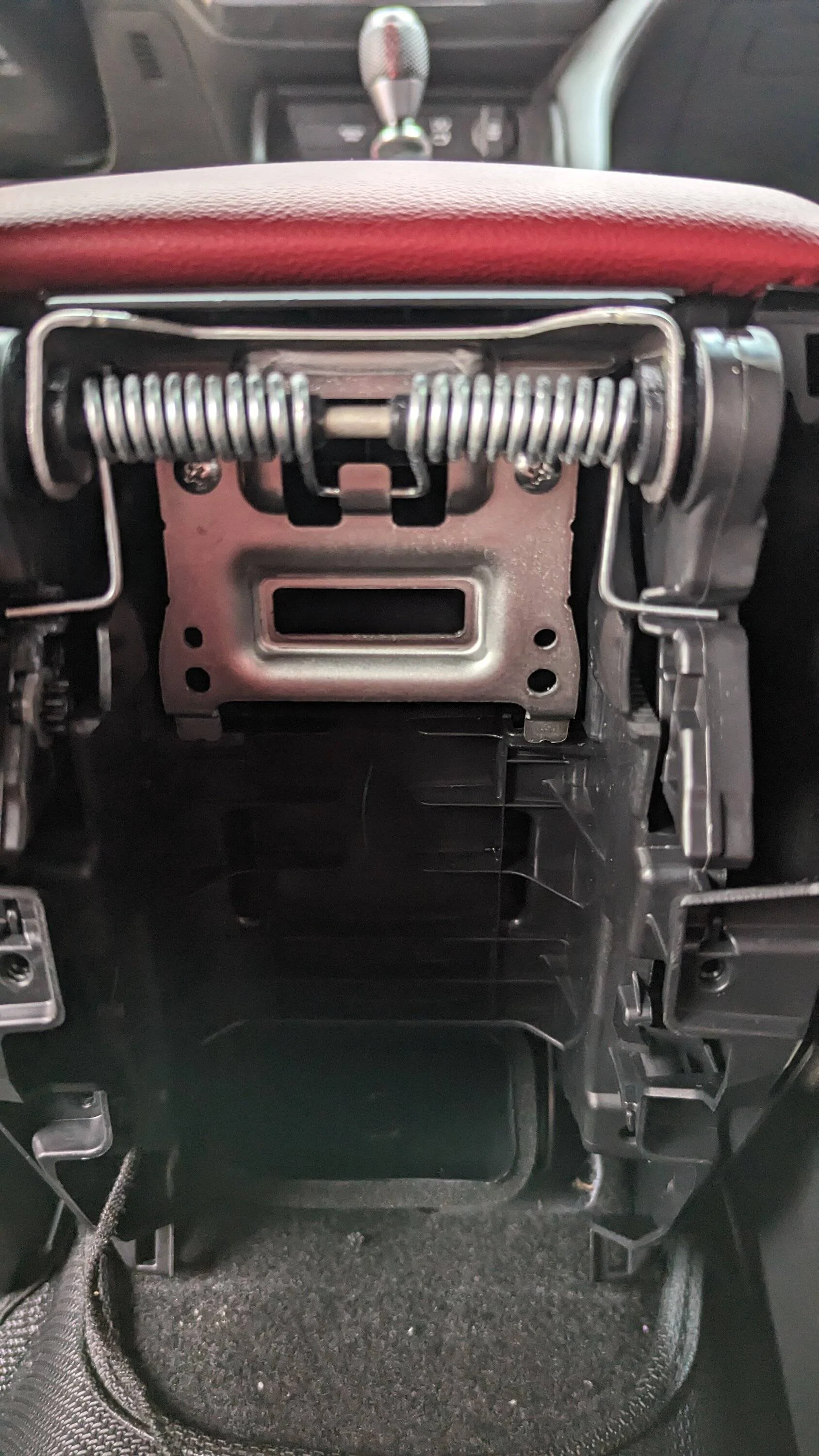

Okay, so, the box itself fits perfectly in the car, but the arm rest doesn't mount up perfect?
3,429
2,909
Only 2 of the 4 screws line up on the FL5 box. Not sure why Honda made so many unique parts.

Thanks for the update. Is the arm rest still lift up mechanically normal?
3,429
2,909
Yes it still works. It's not as good as it was of course but I open it and close it multiple times a day without issue.
