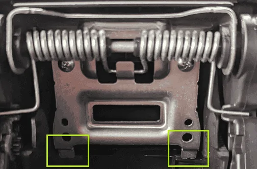

In the one picture you posted of the original mounting assembly, it looked as though there were two tabs that would insert into some part of the plastic of the FL5 console box. Did they?
Also, did you happen to take any pictures of the FL5 mounting assembly for comparison?

The lower screw holes and tabs do not align. The bottom of the plate has a half inch gap between the console and it's mounting points. Only the top 2 holes touch and line up.
If one were to flatten or remove the raised rectangular area in the center, might that allow things to line up?

If I remember correctly it was also shorter in length. If you wanted to bend or fab different tabs I'm sure it's possible. Or just use only two screws.. i did this for months and it functioned fine.
