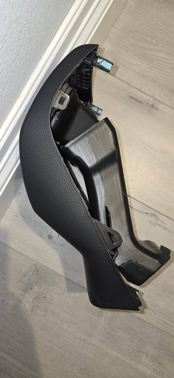

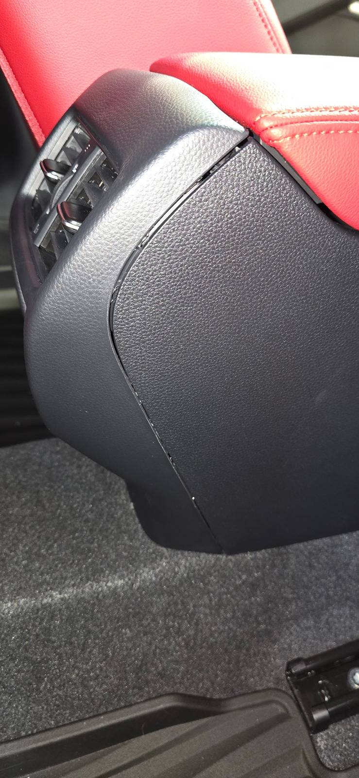

@Integra23 appreciate all the diy guides you put out. I have a question, does your vent sit flushed? I tried to shave and trim down as much and followed mikstore recommendation but I can't seem to get the top part to sit flush. Do you have the same issue?
I shaved a lot and it's doesn't sit flush
I believe a few need to be shaved others completely removed.

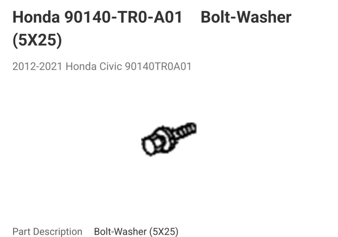

Does anyone have a picture of the 5x125 bolt, PN: 90140-TR0-A01? I would like to try to get a similar bolt at a hardware store? TIA
3,429
2,903
This
Its a 5mm x25mm bolt/washer combo.
Theres not a bracket alternative I'm aware of.
