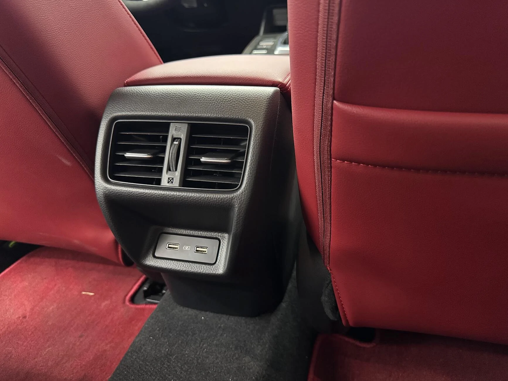

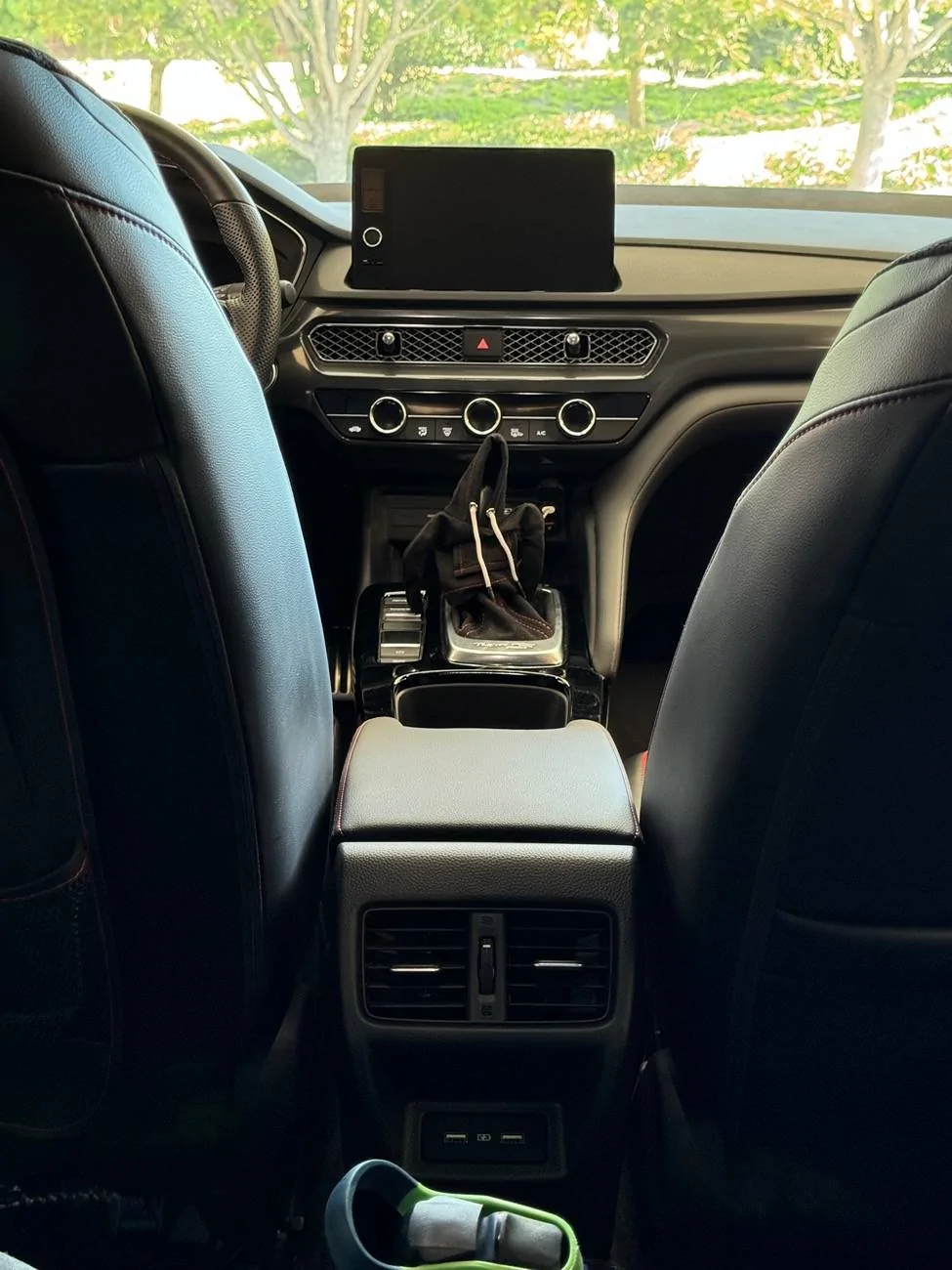

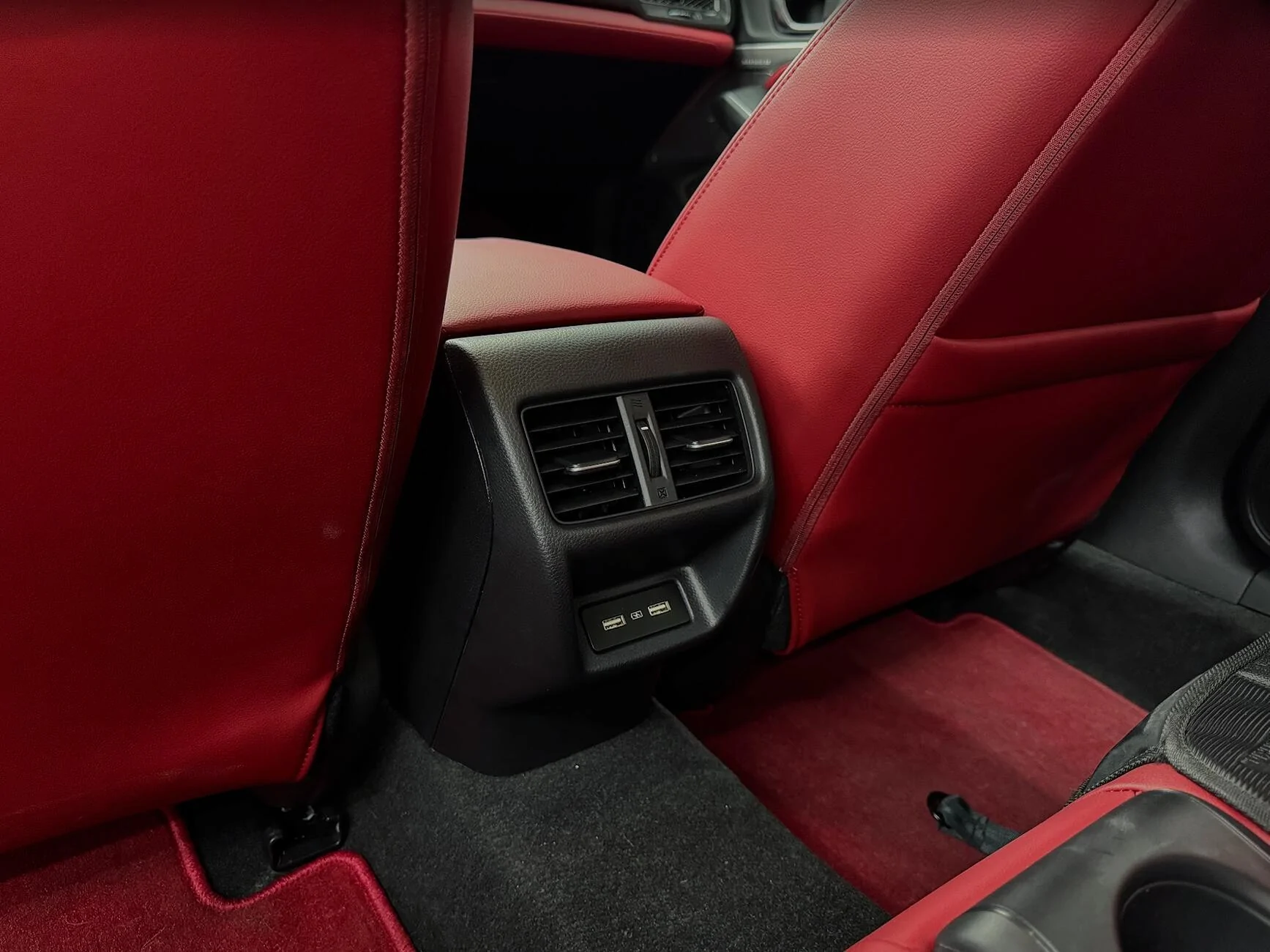

I don't think it will bother most people. I am sure if you spent more time shaving here and there you can make it look even closer. I think realistically, no one will see it as an eye sore. There are area in the car from the factory that isn't the best either.

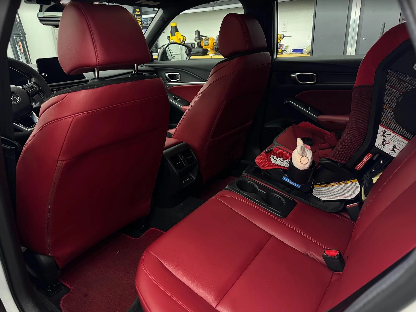

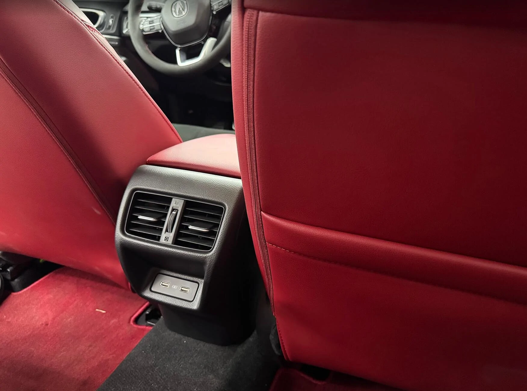

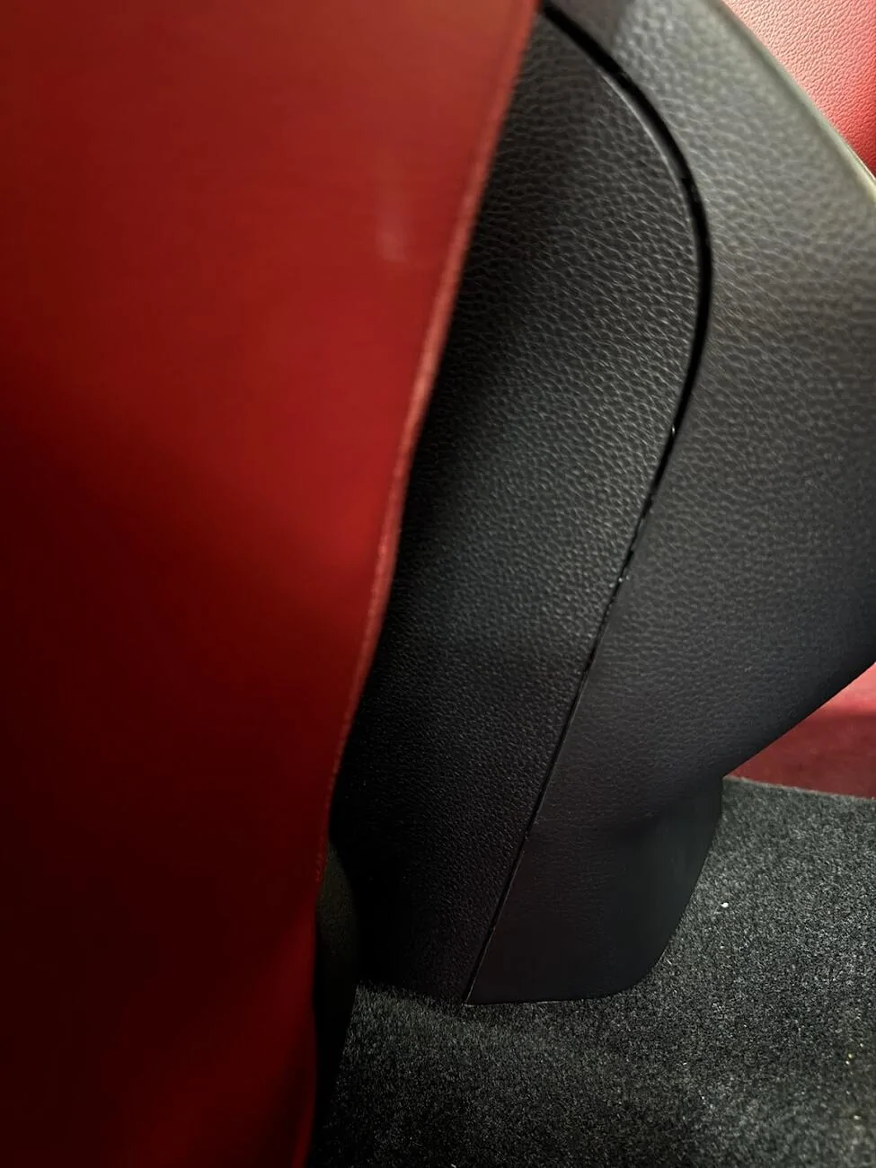

Also, if you are taller than 6ft and have the seat further back it would also hide that area lol. I would say my driver side gap is the worst side. I took some photos for you so you can decide.
Acura Integra Rear AC vents part kit from 2022 Civic 1723755133286-ko
My usual setup and probably the most "noticeable" angle

Looks like there's a gap, which would be in line with other people's experiences here. Is that right?
If you shave the extra tabs it fits better

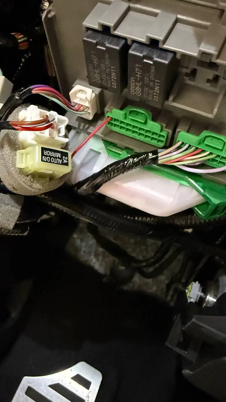

Hey @notorious9i6 / @Integra23,
Thx for the info / video guide.

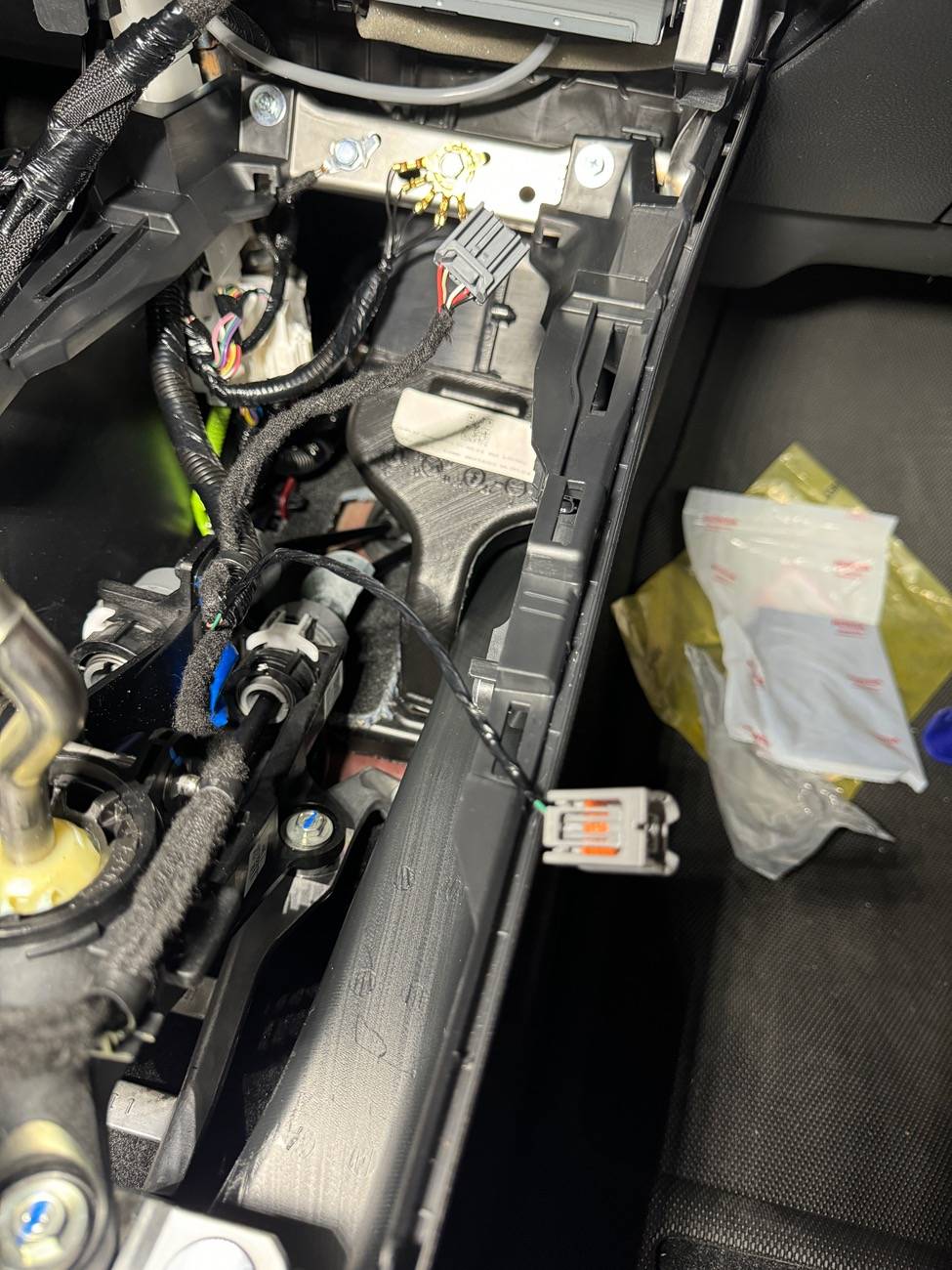

I did this mode recently but I am getting a keyless error/ warning on the dash even though I transported the keyless module from the Acura glove box to the Honda one. And connected it back.
this might be related but I can’t find where this this extra cable connects to. In the middle of the picture it has a light gray connector on it.
do you recall a cable that was left unconnected?

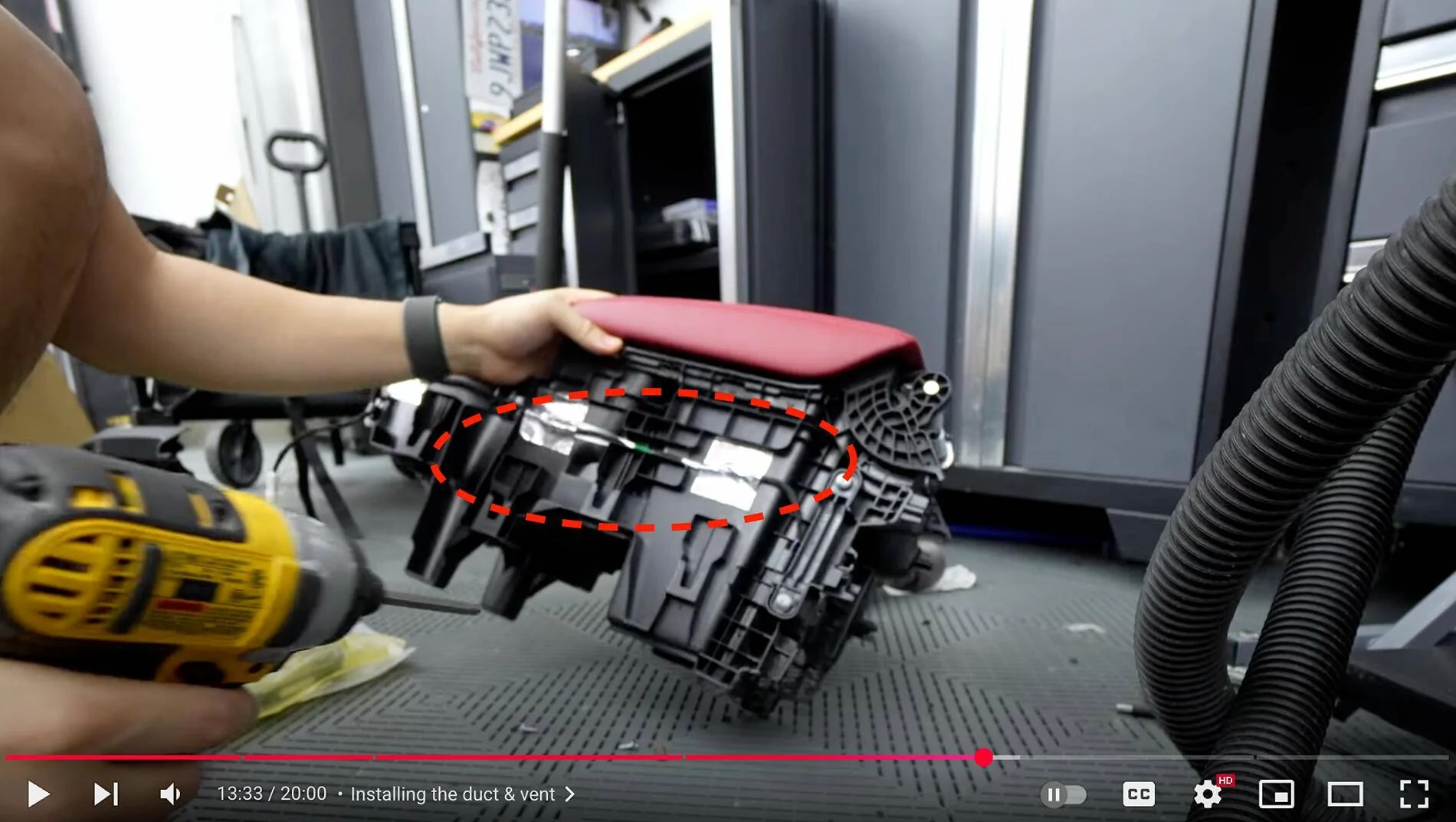

There shouldn't be an unplugged cable. There is two of the keyless sensors in the console. One in the rear that had an extension cable running to it and another on the passenger side. Make sure both are connected.
Thanks! I recall seeing this. After plugging it back in everything is back to normal.
makes me think wearing a GoPro is probably not a bad idea when dealing with so many cables.
