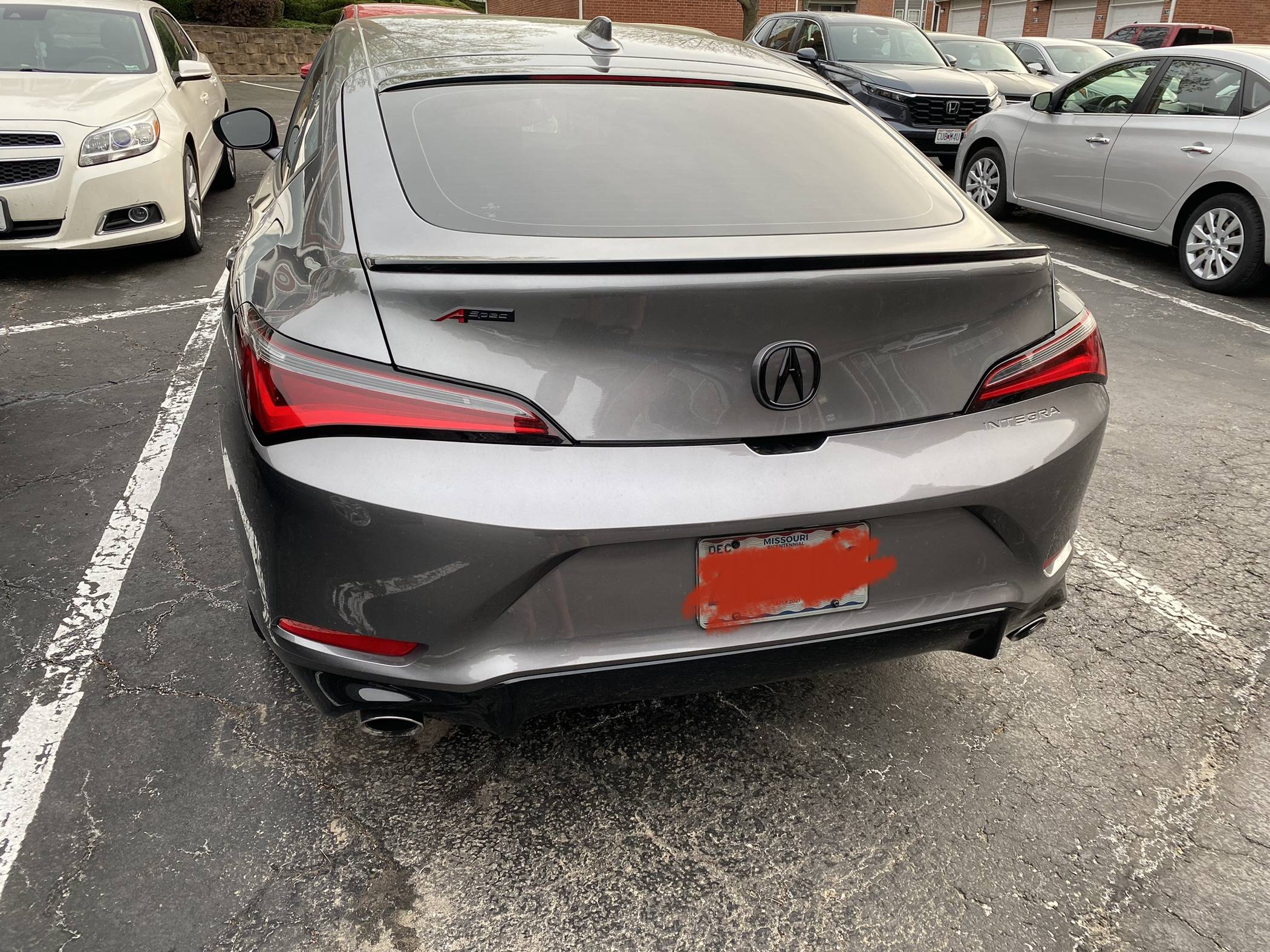

Before

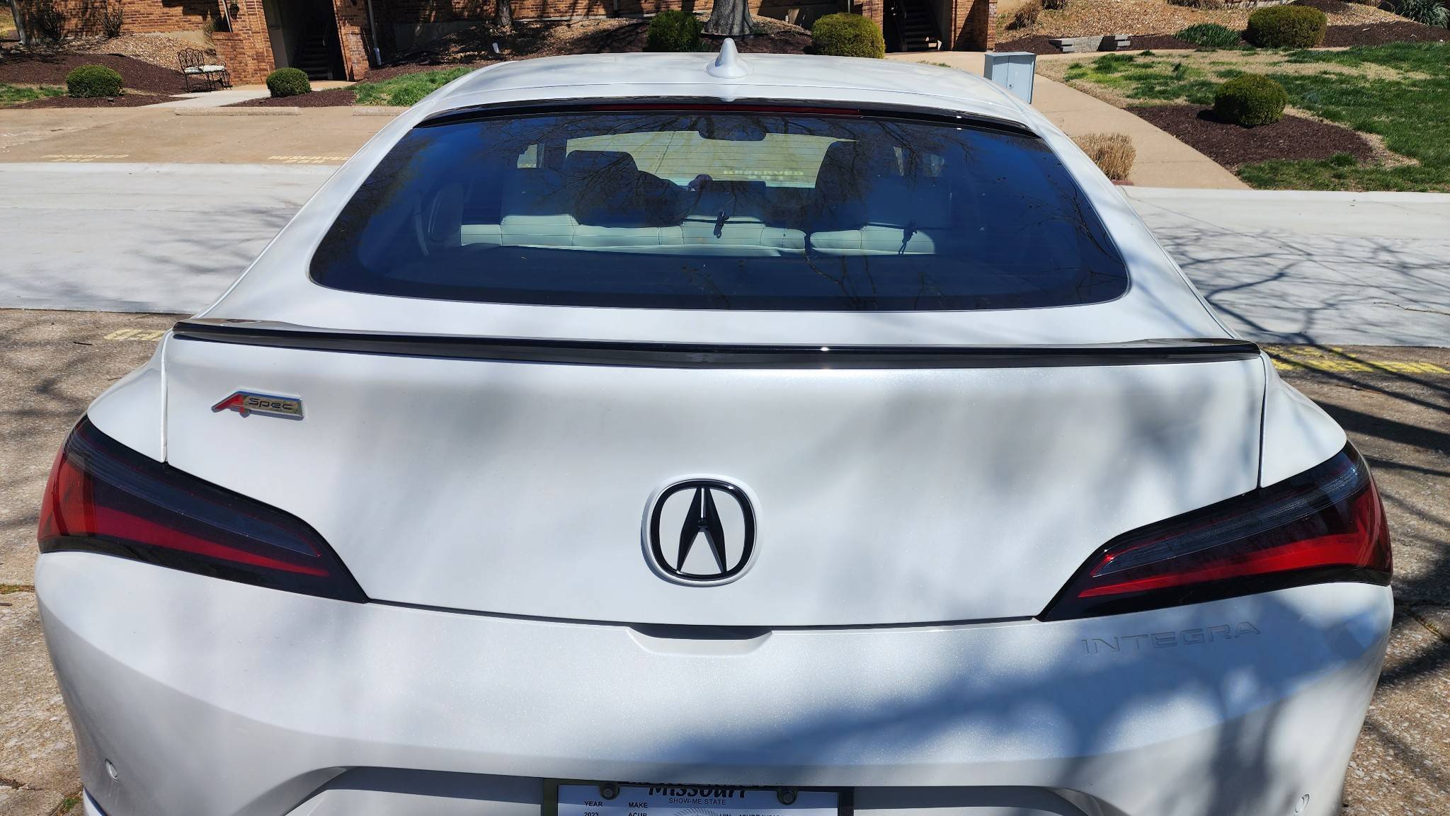

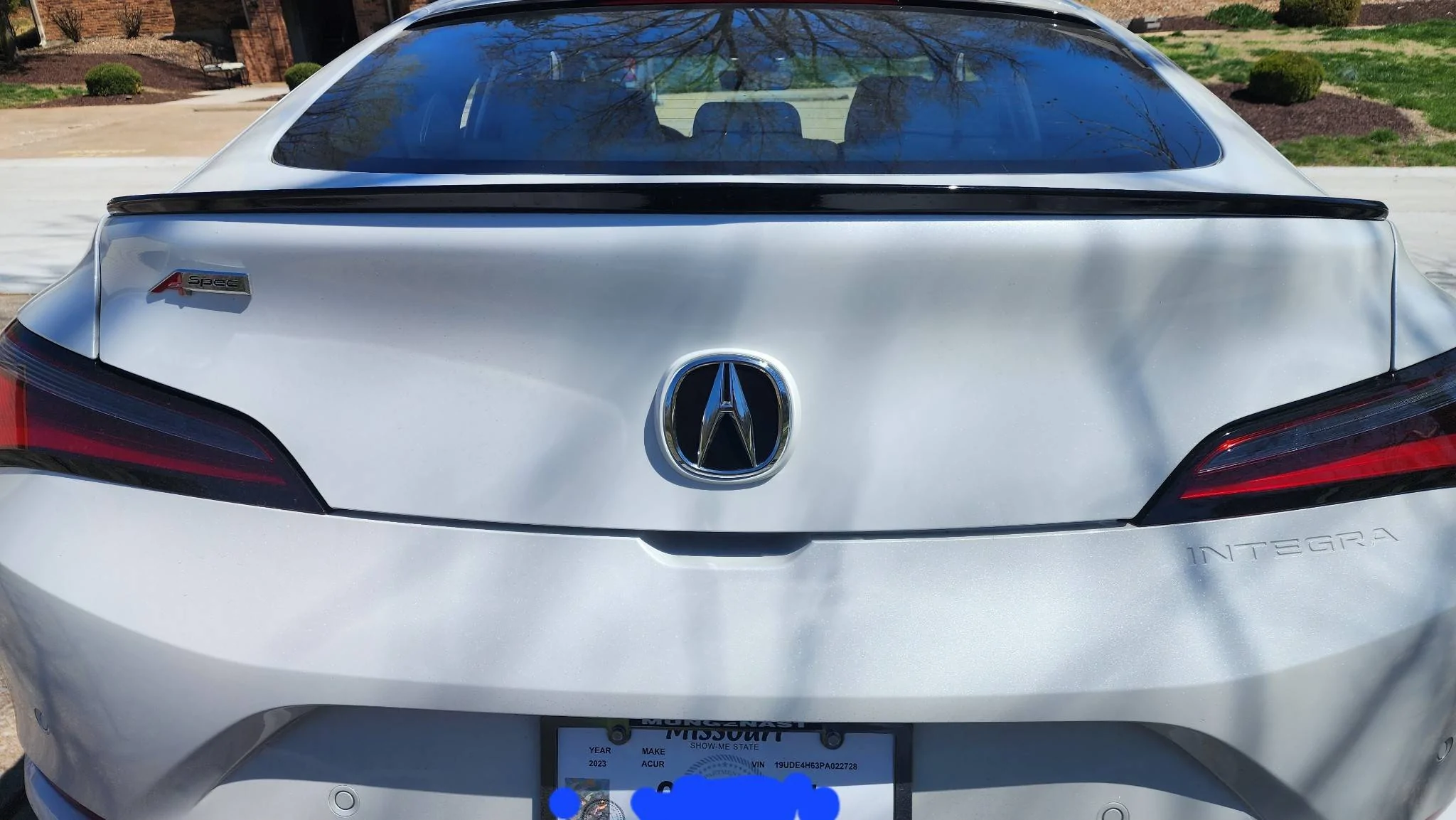

Afiter

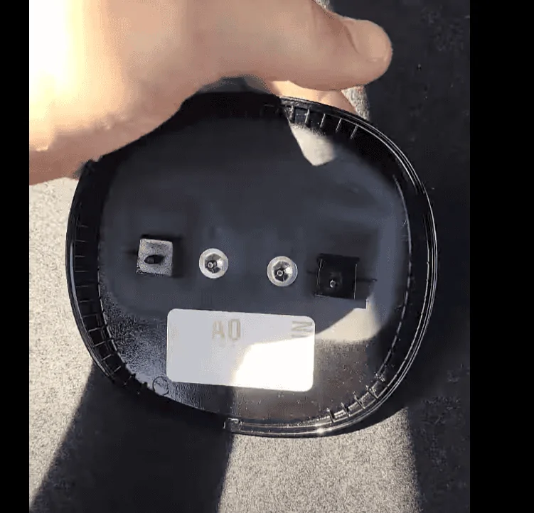

(image from someone else's mod) the posts in the middle are very fragile and will most likely snap when you attempt to remove the clips.

Before
Afiter
